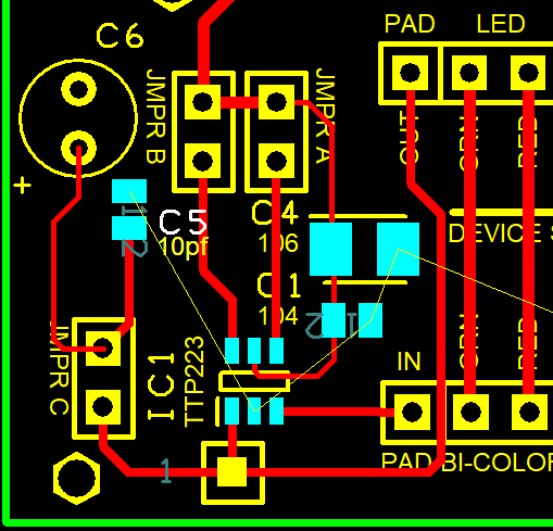

i have updated my other project to include both caps. When the 30pf cap arrives ill add it to the project with a jumper.
Board looks good.
Keep in mind that the 30pf cap may need to change to a larger (less than 50pf) or smaller value depending on test results.

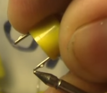

the aussie in this video has suggested i connect this in a particular way (adjusting pin to ground) so when i adjust it the metal screwdriver does not interfere with it.
There are plastic alignment tools. Essentially hex and slotted screwdrivers. Hex and slotted were used in variable inductors. You had screws on variable capacitors used for radio tuning for adjustments.
Fixed is always better.
a better question is should i use a trimmer cap?
i understand that just because it is a capacitor it may not be practical in this circuit.
im just not able to get the range of fixed caps i need and looking for an alternative.
The problem with any "mechanically variable" part is they can become "de-tuned" over time due to temperature, vibration, etc.
So, as stated in #35, fixed is always better.
The signal source is the Touch pad, so I'd move the 30pf cap over next to the header pin labeled "PAD" and connect it there.
What is C6 (next to Jumper B)?
BTW- Keep the wire twisted together from the TP to the PCB.
Moving c5 (10-30pf) over to PAD IN. your so right about that. Good catch.
C6 is (was) going to be the Var Cap (4-40pf)
