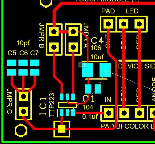

What about doing this. of course i would relocate C5,6,7 just before PAD IN. i could then just add 10pf to C5-7 to get desired results.
What about doing this. of course i would relocate C5,6,7 just before PAD IN. i could then just add 10pf to C5-7 to get desired results.View attachment 132194
The three footprints look SMD. Are you using thru hole or SMD caps?
For testing I would breadboard as a test platform to find the right value. Then just use one cap.
The cap value isn't critical, just need to find out which value solves the issue.
ok got it. C5-7 they are SMD 10pf. those i can find. it was the 20, 30pf i could not locate.
i will re-design for one cap. ill use lead type. i can breadboard those.

The touch pad is 16-24 inches from the ttp223 circuit. The lead wire to the pad is 18 gauge. the pad itself is a cast metal plate 2"x1"
I apologize that this design of mine is may not be all that clear. I hope this helps.
BTW- Keep the wire twisted together from the TP to the PCB.
if there were 2 wires id understand but there is just but one wire from the pad to the pcb. I used to run, hookup, and certify CAT5 cables. Runs sometimes near 300 feet. Twisting the pairs of wires controlled the interference.

Twist the ground wire (VSS) and Pad In/out wire together.

hmm. how would i do that? pin 2 VSS is part of a copper pour. (pad in) comes from one direction (the plate) and pad out goes another (the circuit board we designed last year)
i need to point out that this interference only happens in this circuit. It uses spinning magnets (attached to fan) i can turn the circuit on and off without issue as long as i do this within 3-5 seconds of turning it on. Once the fan reaches full speed the circuit will turn back on after i turn it off. Is it because the fan has reached full speed? dont know. that is what i assume. i can turn it off in this state if i hold my finger on the pad until the fan stops.

Im using this PCB model while referring to the sonrom module #1. As I make changes to the design it is easier to see the changes.
I have researched and applied some changes as per post #44.
I added a 1k resistor between pin3 and PAD. i found this was also suggested in an article at electroschematics.com
I added a ground pin. this to be used with the pads leads. Both soldered to the plate (penny) #55 using one twisted pair from a CAT6 shielded cable. One lead to IN, the other to ground. I will rework the wires in the BOX. Ill twist the power in, Twist the fan lead wires, and re-route so they do not cross each other or more importantly run parallel.
