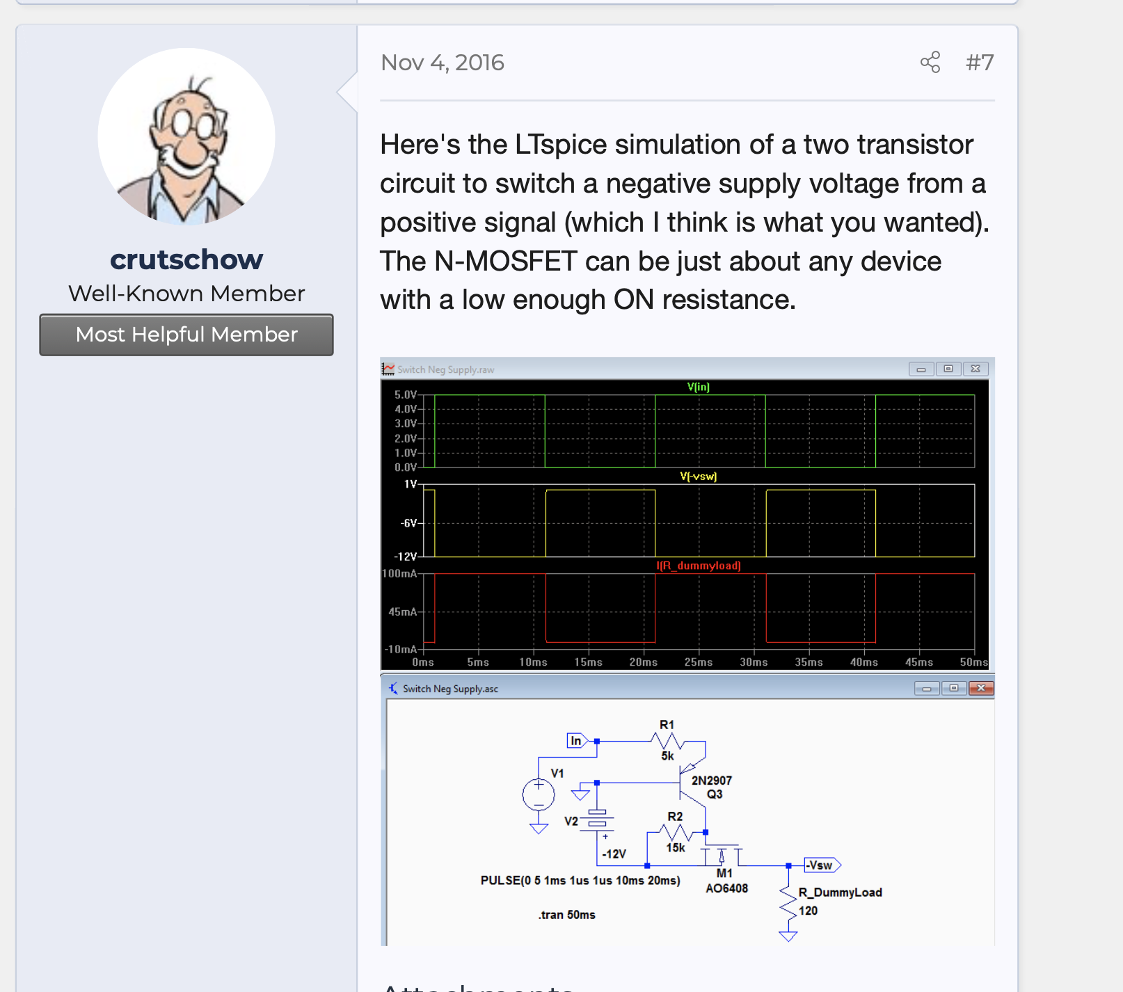

I am very curious how you were able to import the AO6408 VDMOS model into LTSPICE.
I am new to LTSPICE and trying to create a circuit you designed (see attached file) on Nov 4, 2017.
I believe you are converting a positive voltage into a negative voltage.

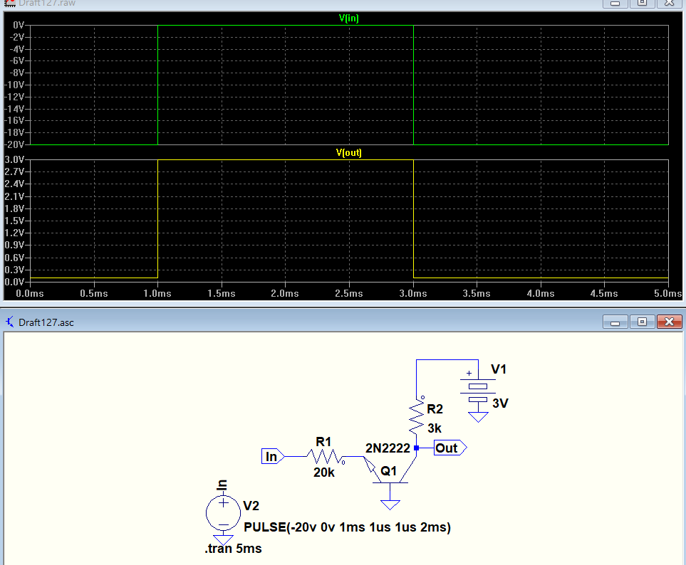

Level converting a logic signal is different than what the referenced circuit is doing. A description of the actual problem with the actual levels and drive capabilities would be helpful. For example:
Convert -20V as logic 0 and GND as logic 1 to GND as logic 0 and 3.3V as logic 1. Are you catching my drift?​

I have a signal -20V considered to be logic zero and 0V considered to be a logic 1.
I could get say 1-100 clocks of -20V followed by same but at 0V. This is from the Bendix computer side.
I would need to convert this signal to say where a logic "1" is +3V and a logic "0" is 0V. My apologies for the poor description as I yet dont know the full scope. Lets consider the drive load to very low for starters .....on both sides...

Below is the sim of a simple one-transistor circuit that should do want you want if the impedances are okay.
The transistor can be just about any small NPN BJT.
ok...Wow....I would have never guessed this solution. As I am helping out my colleague ....I have inquired about the impedance for the drive at the -20V level and +3V level. Let me check on this. I will admit I am learning about a computer from 1956....so new stuff for me.

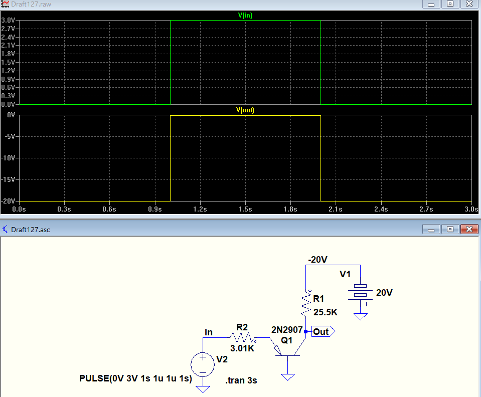

guys any helpful hints going from 3V to -20V; I am investigating the 2N2907 (pnp) I tested successfully the cathode follower from the tape reader ...so -20V to 3V works with the suggested single amp. Now going other direction.
Okay, here's the LTspice sim of the inverse circuit using a 2N2907 PNP to go from 0, +3V to -20V, 0V:

ok...I actually was setting something like this up. I am curious is this considered a Common Base Amplifier Topology? I am a CMOS IC designer....have not designed with Bipolar much../.just trying to wrap my head around the ability of the pn junctions to withstand -20V? I need to examine the large signal char....but I was curious.,,
Thanks Ches74
Basically yes, but it's rather being used as a switch and not an amplifier.
The configuration has the advantage of allowing a control signal of one voltage polarity to generate an output signal of the opposite voltage polarity using only one transistor.
The collector-base junction (or collector-emitter) reverse voltage tolerance is defined by the BJT's rated Vceo maximum (which is 40V for the 2N2907, but you can readily buy BJT's with ratings of a hundred volts or more).
The base-emitter junction is only forward-biased, never reverse-biased here, so its reverse bias rating (which is typically only about 5V) is not a factor.
