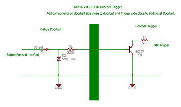

I just bought a Dahua Video Doorbell connected to my network via PoE (Power Over Ethernet). The thing is that some people still use my standard doorbell (I can't rewire/remove it without leaving a big hole in at my front door) so I would like to trigger the Video Doorbell when the standard doorbell is pushed (and vice-versa if the video doorbell is pushed trigger the standard doorbell so if I don't have my phone I can hear the strandard house doorbell). At first I tought maybe a simple reed relay would work but I now realized the standard doorbell is using AC (I probed the transformer and I read 21V but on the transformer it's shows 18V-10VA Load am I missing something here?), so the reed relay would need DC and therefore a bridge rectifier?
Some guys did this circuit for the same doorbell but he's using the same power source to power the video doorbell and the standard doorbell (not a possibility in my case I must use the PoE power from the network switch for the video doorbell). Source
I won't lie I'm not a expert in electronic, I do have soldering, pcb etching experience but as for circuit designing this project is a bit over my confort zone so I would like your experts advices and recommandation to do it the "right way". The main goal is to trigger the Video Doorbell when the Standard doorbell is pushed. If the other way around is not possible due that's not a big deal but would be great to get it to work both ways.

You could use an open-collector/drain opto-isolator to trigger the Video d-b. The LED inside the opto would be powered when the Standard d-b switch closed. This would require soldering the opto's output terminals to the Video's bell-switch terminals, and connection of at least a diode and resistor to the Standard bell circuit. If the Video d-b objected to repeated triggering at mains frequency then a monostable circuit or other means would be needed to control the triggering.

I found this type of optoisolator compatible with AC. https://www.onsemi.com/pub/Collateral/FOD814-D.PDF

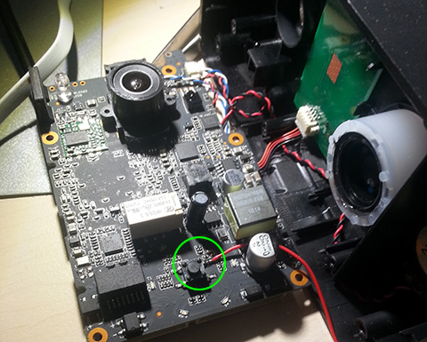

I just need to find the correct specs based on the voltage supplied on both doorbell. I know that the classic doorbell is 21VAC when probed ( 18V-10VA Load written on the transformer still confuse me tho) so I need to open my video doorbell to probe the switch's contact to find out the VDC of this circuit.

The opto shown would conveniently eliminate the need to rectify the AC with a diode.
Don't forget a resistor in series with the opto-isolator's input diode(s), to limit the current to something a good bit less than the maximum rated current specified in the opto's datasheet.

Look under Absolute Maximum Ratings. For the opto shown, for both the LED (emitter) and the detector the max current is +_50mA, so driving the LEDs at, say, 30mA should be fine. The opto (not the A version) has a minimum current transfer ratio (CTR) of 20%, so the collector current could be only 6mA. Hopefully the Video bell switch will not need more than that to trigger it. The A version of the opto has a minum CTR of 50%, so could provide a higher trigger current.
