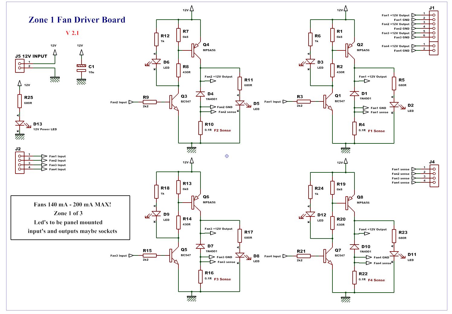

ok corrected drawing attached. Never sure on version numbers, so i have called it V2.1 because its just a minor change?? how is versioning normally done?
hi ian comes out huge on my screen?? how do i make them bigger?
I would suggest increasing the 10uF decoupling on the 12V rail to say 470uF also add in parallel with it a 100nF.
This should help reduce 'airborne' electrical interference being radiated.

ok eric also i have now connected it the right way round :oops:

the hastle i have is the way i have drawn the fly back in the drawing, it's giving a unhelpful rats nest lol, by the time i have this one finished i will be shaving!!
