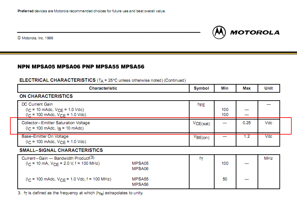

This is what Motorola say on a datasheet I have just downloaded.
So where did you get your datasheet.?
E

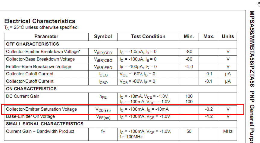

I would trust Fairchild to know what their product datasheets claim.
Eric, I am sorry to beat this old horse to death but didn't I say that copies frequently have errors? Does Fairchild hire little kids?

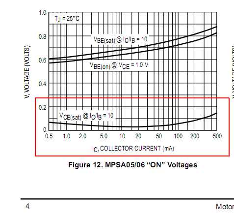

The graphs for a Motorola/ON Semi transistor has a typical saturation voltage of about 40mV but Fairchild's has more than 200mV. Fairchild's written spec's say 200mV maximum. Motorola/ON Semi says 250mV maximum.
Another saturation graph in Fairchild's datasheet shows that its saturates poorly when its collector current is 100mA and its base current is 20mA.

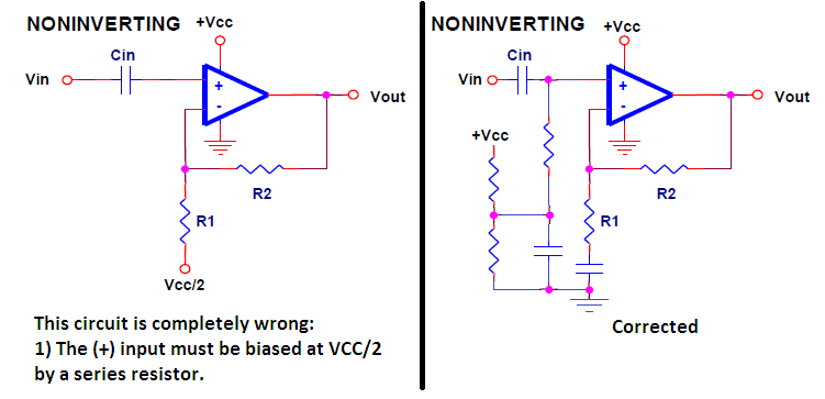

Speaking of Texas Instruments, here is an error they made in their article "A single-Supply Opamp circuit Collection".
The correction is mine:

The maximum VCE sat is 0.25V at a collector current of 100mA. The "typical" plots show about 0.04V.
But in post #36 you wrongly say 0.2V and show Fairchild"s wrong graph that shows it.
Not only the plot shows 0.2V, so does the text extract as shown in the clip I posted from the Fairchild datasheet. [repeated here]
I also posted the plot from Motorola 's datasheet which also shows close 0.2V for Vce sat.

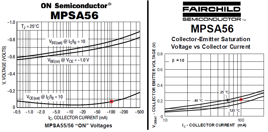

My point is that the datasheets of THE SAME TRANSISTOR should be IDENTICAL even if the manufacturers are different.
Fairchild's graph is completely different from Motorola's and the written spec's are also different.
Hee, hee. National Semi copied Motorola's written spec of 0.25V for the maximum VCE at 100mA but copied Fairchild's graph showing a "typical" saturation voltage a little more than 0.2V.

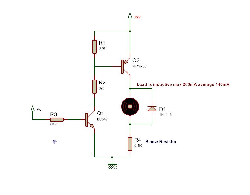

on a different point i have updated my drawing to the following
i have added a sense resistor but would like to add a indicator LED, i have thought about it but not sure the best place to place it, i would like to keep the mA from the pic pin down as much as i can, the LED need only be run at around 10mA so where would be best in the circuit with the least inpact??

small error in drawing i change the diode to a 1Amp one as per erics sim

The written word on the datasheet for the MPSA56 transistor is the maximum VCE sat (0.25V at 100mA). The graph (0.04V at 100mA) is for a "typical" part but some are better and some are worse. It looks like Fairchild's graph is a mistake and is for a much weaker transistor than a powerful MPSA56 transistor.
