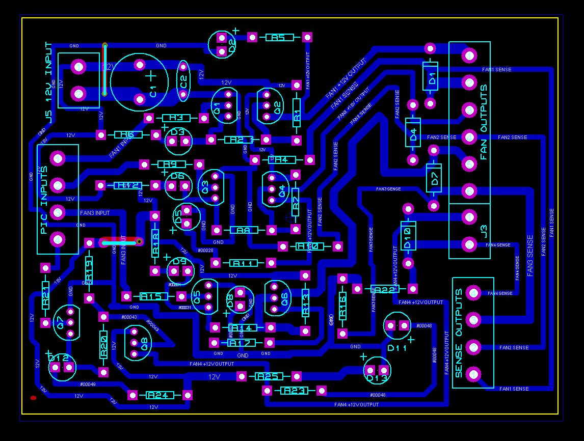

finished the layout but very not happy with it! loads of things i will change on the mark2. still it will do for now and i can replace later, but this one will get me in the race :D also having trouble getting the pcb image on the pcb!!doing everything normal but not working!!! need to take calm approach later and try again!

etched board, it came out alright (not perfect but pretty good), next time i will watch the distance between traces as some are scary close to each other! also standard pad sizes in proteus are silly small hence why i changed them to square ones :D next jobbed is to drill it (yuk) this really p's me off as we have a hugely expensive cnc milling machine that cost £££££ and its not been used once!!! two years old and never used! grrr truth is we dont have any mill bits and dont have a clue how to set it up or use it!! its a A3 bed one, one day i am going to try and hook it all up and get it to drill my boards for me!! but first i got to get dad to move it into the outside workshop (its in a shed at the mo) it dosnt fit in the house the removal men couldnt get it through the doors. not sure how we going to move it as it took 3 of them to carry it! dosnt look that big but its heavy, i will take a pic of etched board soon as i have found dads camera! its gone missing from the workshop so dad has probally walked off with it

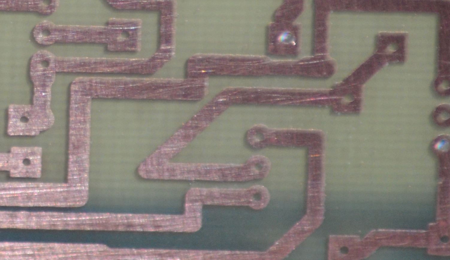

You can also try to avoid acute angles, such as the one next to Q8. They sometimes do not etch well. I always try not to turn traces more than 45 degrees.

no excuse but it was a rush job, i will post a pic of the etched board soon as i can get the camera, that trace by Q8 was ok in the end but its a fair comment, looking at the actual board i have been lucky in a few places. it will definitely get redone soon as i get time, there is alot i can improve on it. oh well its all a learning curve, it saved me short term time to meet a deadline but long term it's going to cost more time to refine it and improve!

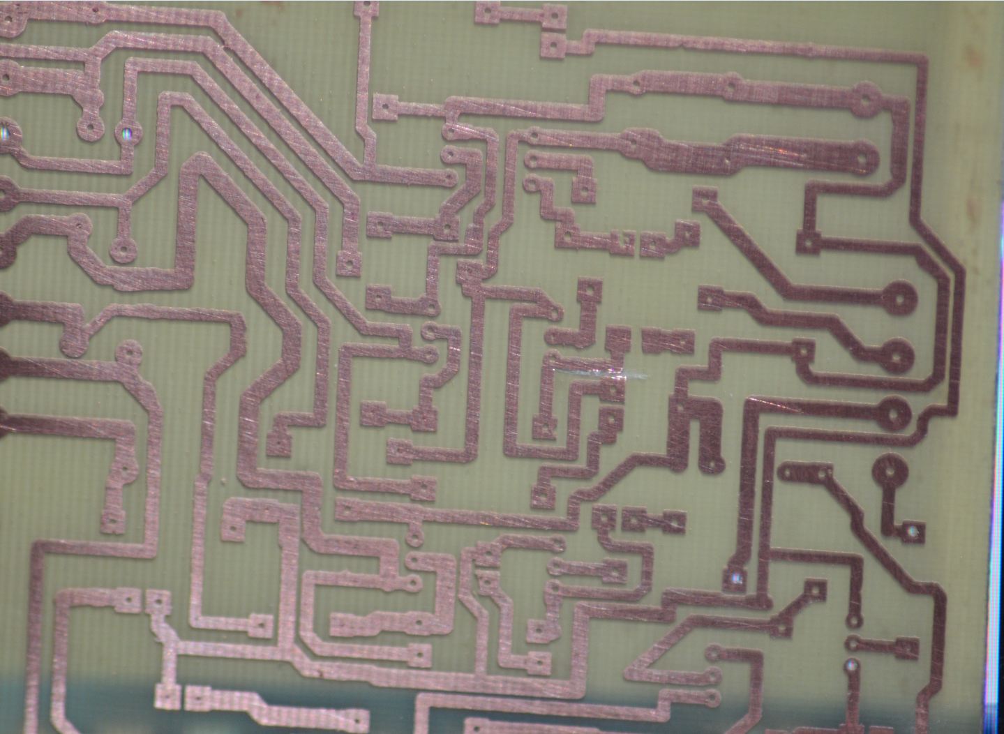

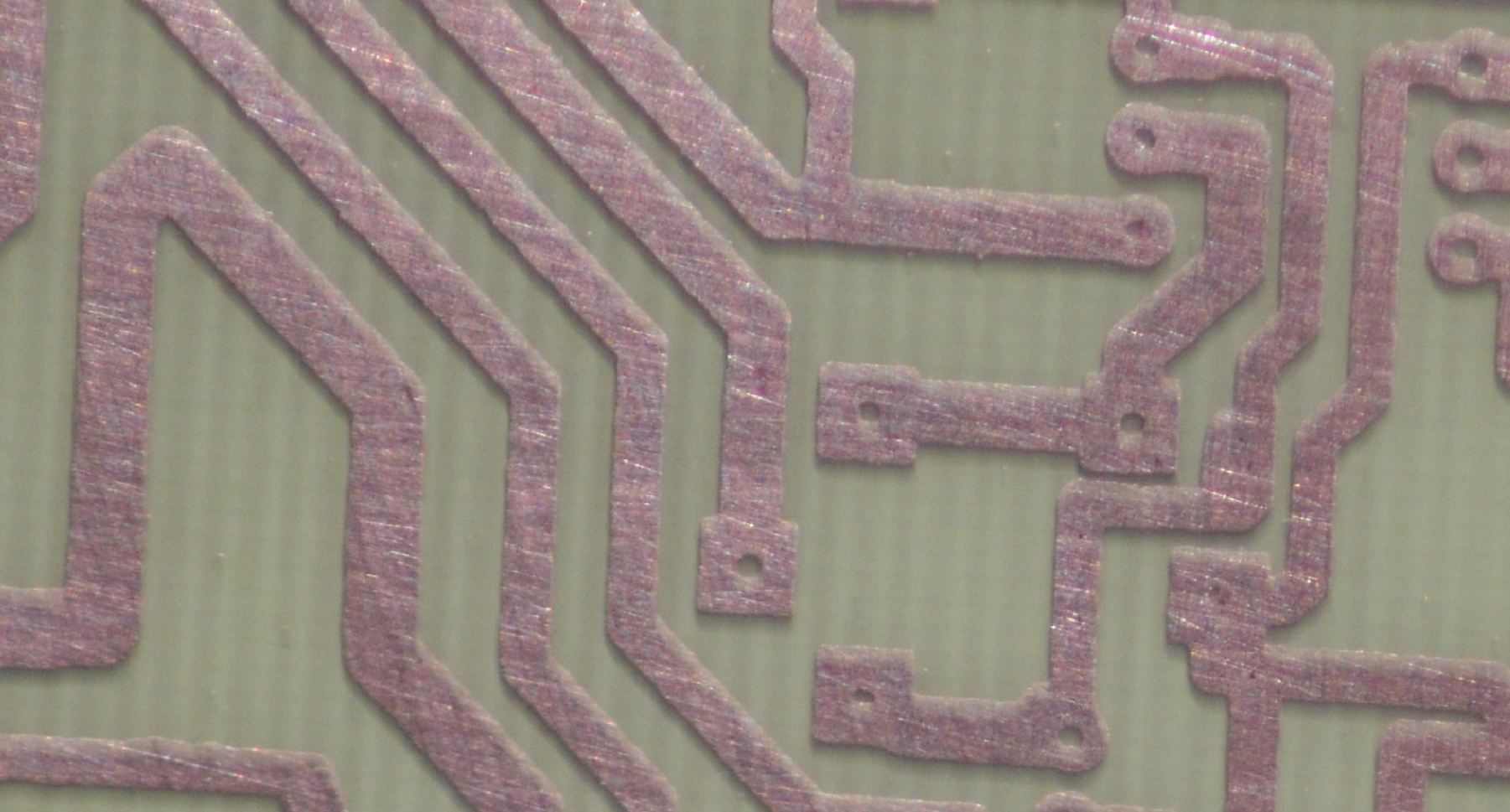

ok got some pics! keep in mind i havnt made a board for well over a year and havnt made that many before anyway! also the pics are taken at hi mag so you can see fine detail of tracks even the tiny scratch marks from cleaning off the toner lol, also note that the bad corner by Q8 actually by some miracle came out fairly well
I've had time to look over your board. I'm going to support you on Q8, it has a turn on the base in Pic 3, I'm not sure if electrons care if it's on that angle or not? If this is your concern, there was plenty of real-estate to do it? Again, I'm not sure of your concern. I did see some cut or clean marks on Pic4, no big deal either. I like it:)
If there is an electrical reason that it might be a problem, else I don't see it.
most te marks are cleaning marks, they look bad because i took hi res pic at hig mag then zoomed in a little more on the pc and did a screen capture to post. i think the concern with the tight corners is more that normally they dont etch well, the reason for redoing the board at a later date is solely because most of the Leds are not where i want them :D and the board could do with being smaller.

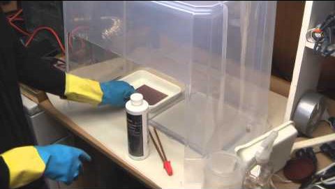

I think in the future you should protect yourself by making a chemical hood. Vent the gases up and away from you. Heres on someone made, it doesn't have to be the same it, could even look like a sandblasting box. The just pipe the fumes up and away from you. You don't want your head just above it, breathing it in.

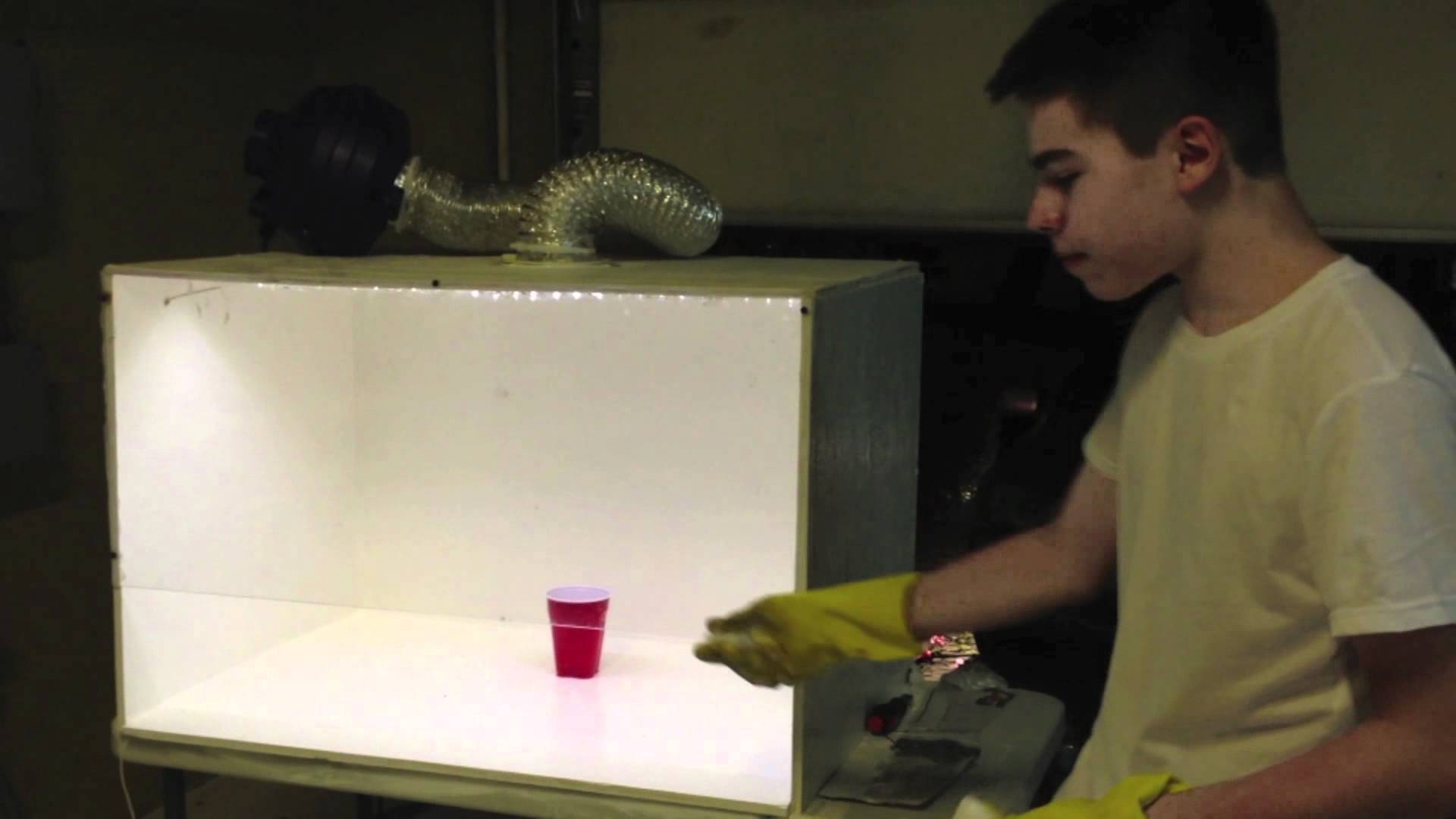

thats a really good idea!
I like the second one better, but I think it should be more on an angle, like the professional ones. An old dryer blower and tubing should work ok for the vent pipe.
Even an old cooktop hood would work if you modify it.
second is better, also as we are (ok as dad is) ripping out the kitchen there are some kitchen units one in particular that would make a good box like the second one, we have a old bathroom extractor and some flu liner from just having a wood burner installed :D that just leaves finding some acrylic for the front! i might get dad to make a frame for some old green house glass we have, and a small mod to make the front bit on hinges so it can be lifted up for bigger stuff to go in :D
