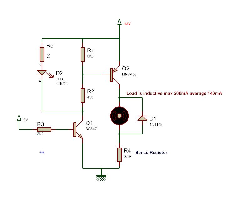

transistor switch help
i thought of doing the following
so replace R2 with 430R so Q1 can sink a little more and adding a 1K to Led, would this work? (nowhere near ready to sim stuff on spice yet lol or i would try it on that :D
What then you won't have any magic smoke:p
Your new circuit with the LED will work fine.
I couldn't think of anywhere he could put the LED, everywhere I tried and failed. When he dropped into the collector, I thought that will work, that will work.
I'm glad I'm not designing it or there would be magic smoke:facepalm:
Good Job, LG. We want details:D
i have added a sense resistor but would like to add a indicator LED, i have thought about it but not sure the best place to place it, i would like to keep the mA from the pic pin down as much as i can, the LED need only be run at around 10mA so where would be best in the circuit with the least inpact??
Hi L,
Add a series resistor and LED across the Inductor, ie: in parallel with the inductor.
Set the LED current at say 15mA, if the led is Red with a Vforward of say 2Volts, that would make the resistor value >
[12V-2V]/0.015 = 666R, use a preferred value of 620R or 680R
How do you plan to use the voltage across the sense resistor.?
E
EDIT:
With the LED in the position shown in your posted circuit, all it will tell you, is that Q1 is working.
It will give no indication if Q2 and the Inductor path is working as expected.

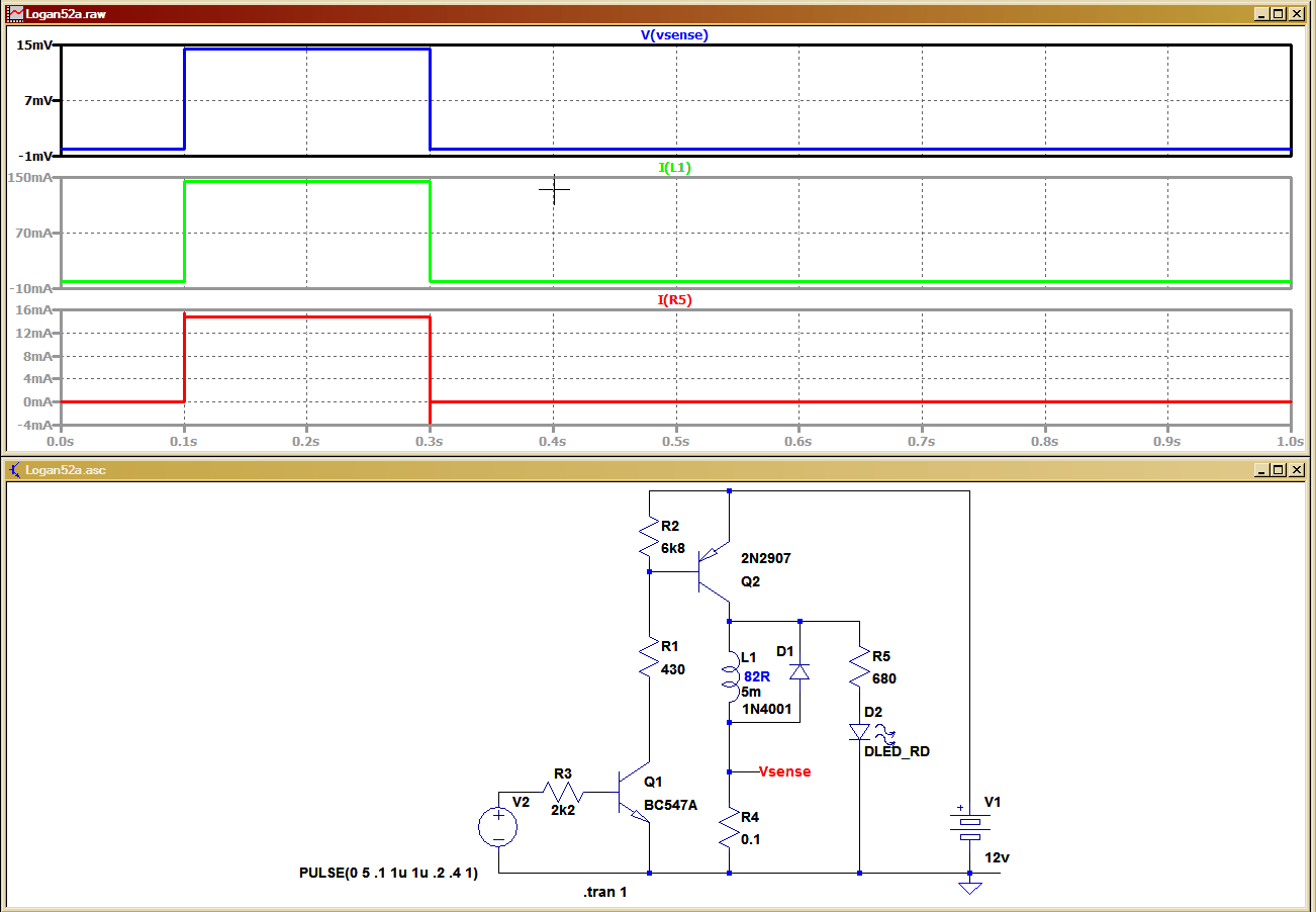

hi Logan,
If you have installed LTSpice you could try running this 'asc' simulation.
I have used a 2N2907 in place of the MPSA because its included in the LTS transistor select option window.
Note the very low Vsense of ~15mV, this why I asked how you are going to use it.?
E
  • Logan52a.asc

tried to run the sim and got the following error :confused:
Circuit: * C:\Users\jason\AppData\Local\Temp\Logan52a.asc
Error on line 2 : q1 n005 n007 0 0 bc547a
Unable to find definition of model "bc547a"
Error on line 10 : d1 vsense n003 1n4001
Unable to find definition of model "1n4001"
Error on line 13 : d2 n004 0 dled_rd
Unable to find definition of model "dled_rd"
Direct Newton iteration for .op point succeeded.

hi L.
You must place the asc files in the LTSpice folder, mine is C:\Program Files\LTC\LTspiceIV
That folder is created when you install LTSpice.
I then create my own sub folder to LTspice, called MyWork: C:\Program Files\LTC\LTspiceIV\MyWork\Logan52a.asc
Move the asc file and retry the sim.
E
LT Spice does not know about a European BC547A transistor and a 1N4001 rectifier diode. Those models must be found at the Yahoo Group.
hmm i should have realized that the sense resistor would be low at only 140 mA being drawn by the fan. due to low time before i need to actually build the sense resistor will stay, i was going to connect to the pic ADC but for now any unused pic pins will be brought out to a header on the board in case i need to add something later. This whole thing may seem mad but it's about alot of things including a chance to try many things out and learn alot.

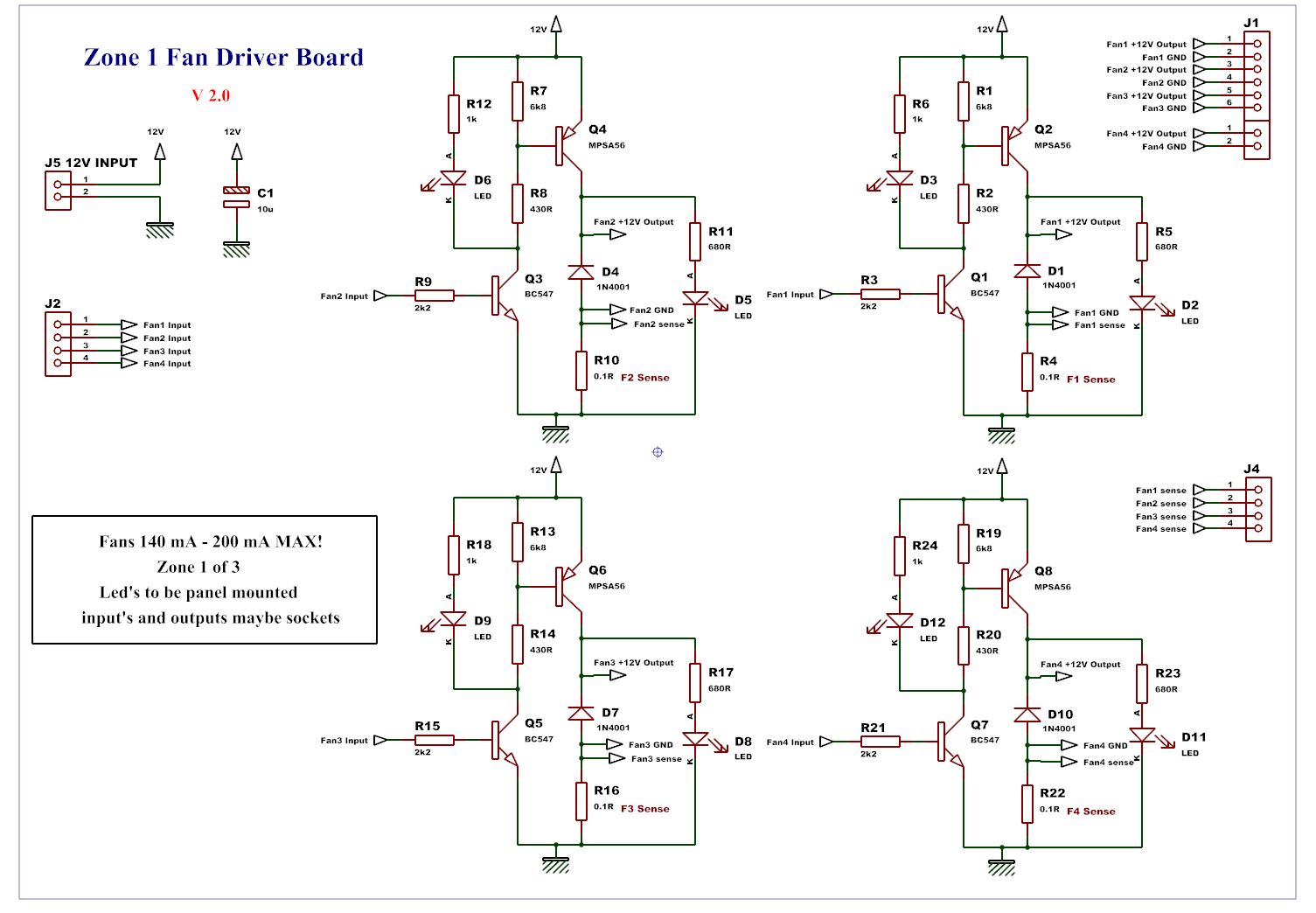

i have done most the woodwork now, i am doing a updated schematic for each zone fan controller but have a small problem, normally i go the 40 pin chip route for testing and prototypes then i down grade the chip once i know exactly what i want it to do and how many pins etc i actually need. this time i was going to go straight for a smaller pic, so i went to have a look what small pics we got and i have 4 18f1330's great 18 pins blah blah blah, but it dosnt have spi, it does however have 3 pwm generators with 6 outputs, wich would save me coding interrupt driven pwm.
one way i can think of making it easier for me is to use the 1830's as fan drivers and connect the EUSART (it has one) to a master pic with 2 usarts one for connection to pc and one to connect to the fan controller chips. not sure on all this so will try it, i will make a single board first to control 3 fans, if it works out ok i will do a bigger one with all three pics for the fans on. so today is finish schematic for test board and with luck have time to make test board. or find bigger pic and go the 4 fan per zone route with software pwm, lets try the 18f1330 first. will post schematic later
logan
edit
forgot to add i have been playing with dads super duper function generator to find best frequency and duty cycles for the fans, will post results and pics later. I am ment to use opto isolator with his FG but could only find a triac one so didnt bother :D
the fact he wants me to use a opto makes me think he paid more than the £20 for it that he told mum it cost ;)
here is the first fan driver board revised schematic
not as tidy as i like but was a slight rush job, the inputs and outputs maybe swapped over to D type sockets on the project box but for the sake of pcb layout i have used T Blocks. The Led's will be panel mounted. wich reminds me i havnt added 12V power indicator :banghead: i will go do that now! then do the pcb layout
