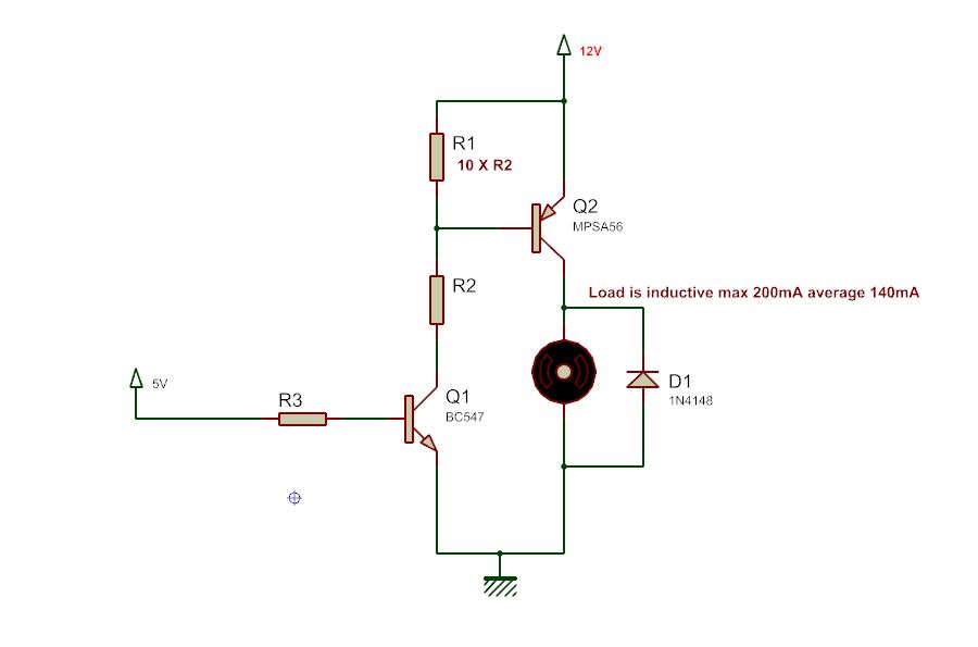

i need to switch 12V inductive load with a pic BUT i have to use the transistors in the following diagram (reason dosnt matter at the mo), now i think the following diagram is how i need to do it
sorry i keep getting there was a error uploading file!!! i will be back with question and drawing soon as i can get it uploaded
ok changed browser from firefox to chrome this should work :D
i have both data sheets in front of me, so can someone take me through step by step referencing the Data sheets how i go about working out the resistors!
i understand Q2 needs to pass 200 mA tops so rule of thumb means base resistor needs 10 x lower current so 20 mA , first part that confuses me tho is the Hfe for Q2 is 100 min so surely the base of Q2 could be run at 2mA and still be fully switched on??
i also understand rule of thumb 2 says R1 is 10 X R2??
i have no idea in this configuration how R3 is worked out.
i chose this way of switching because i needed to switch a little more than a BC547 can handle on its own, the pnp i have to hand will handle it ok but i dont want to have to invert my code so i chose to switch the pnp with the npn
so can anyone walk me through the calculations and point out how the numbers relate in the datasheets, especially things like max emiter base voltage, is that number the difference in voltage between base and emitter?

Whats the specification of the inductive load, how much current.?
Also is your PIC 3.3Vs or 5Vs supply.?

Calculate R2 to give at least 20mA into Q2 Base, assume that Q2 has a large signal gain of only 10.

now working out 20 mA for Q2 seemed straight forward my first thought was take the 12V - 0.7 drop for transistor giving 11.3, then 11.3/0.020 = 565 Ohms so nearest 560 will do for R2 and x10 that for R1 is 5k6
BUT is that the correct way??? because what i got thinking was the two resistors R1 and R2 form a divider? and at the chosen values will give a voltage of 1.091V without taking any off for the transistor??
anyway assuming my R1 and R2 are correct then R3 is 5V -0.7 (transistor) 4.3V and needs to supply base current of 2mA?? (not sure about this as i was thinking gain for Q1 would be higher)
so
4.3/0.002 = 2150 Ohms or around 2K or 2K2 would do it?
can someone tell me if i was correct please then i can ask some more questions about this circuit :D

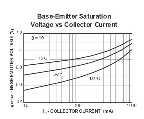

hmmm i am wrong i know i am! i have made too many assumptions, for a start the mps isnt a switching transistor as such, so trying to make sense of the datasheet the base to emitter saturation voltage is actualy 1.2V qm i now on the right track?

Hi Logan,
This conclusion regarding the 1.091V for Vbe on Q2 is not correct,
Q2 Base to Emitter [internal diode equivalent] will start to conduct at ~0.6Vbe and will not go much above 0.75V, so nearly all the currect thru R2 will flow into the Base of Q2.
I would use a 620R and 6k8, also 2k2 for base of Q1, your values are OK.

although the datasheet says that i found the following graph in it
wich makes me think the voltage drop is 0.8V

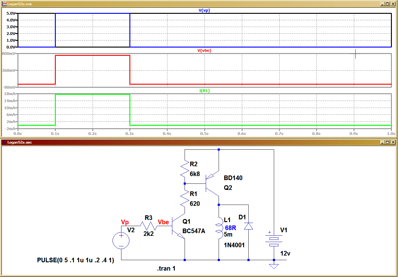

Look at this LTSpice simulation of your circuit, I have used a BD140 [ no MPS]
Top plot is Vin , 2nd Vbe of Q1, bottom is the inductor current.
E

i need to find a good book that explains what all these graphs are for and what info they are actually giving me.
transistor theory seems harder than i thought! but determined to master it :D
thanks for the help
great sim! i must learn LT spice its ace makes more sense seeing it on a sim
