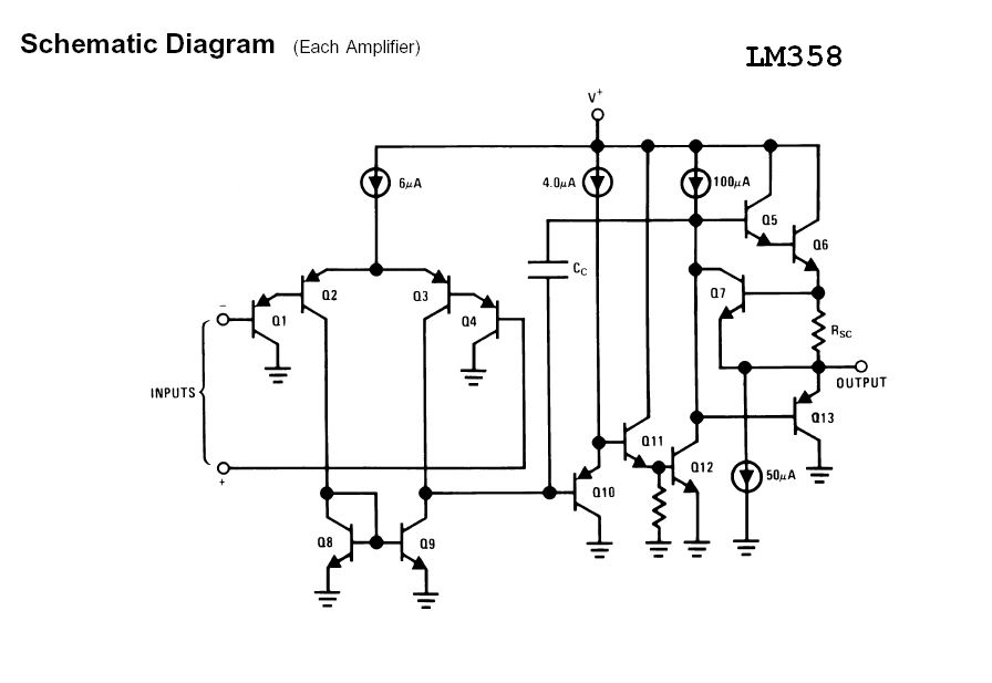

What you say about the LM358 is hard to decipher because i am not sure what level of 'distortion' you are talking about here. You know, like 10 percent, 1 percent, 0.1 percent, etc. All i can really tell you is that the crossover distortion in the output stage is eliminated with the right choice of output biasing, and it's not hard to imagine how this works. If there is something else going on then that must be a different issue and has to be handled separately. I can tell you though that once this is done, the output sounds clear enough for a headphone amplifier.
You can take a look at the schematic on the data sheet of the LM358 where they show the basic internal connections.
Any crossover distortion usually shows up as a blip or something, so if you have a spec on that you can state that as well if you like. I can tell you though that without the special biasing the cross over is quite pronounced and visible on the scope, and worse, audible :)
I would think the LM358 internals and the LM324 internals are similar, but i dont know if there is any different biasing going on due to the added two amplifiers. It doesnt take much though to set up a little experiment by wiring up an LM358 and pumping a low freq sine wave through it and testing for any noticeable crossover with a scope. You might also listen to the output too with headphones at various frequencies (but not too high) and various gains probably less than 10. There is a light chance i can do this myself later today but not sure if i can get ot it or not yet. I also have an LM432 which i believe has an two amps like the LM358 internally, as well as a voltage reference, and i just made a breakout board for it the other day but still need to put the male headers on it. One of the amps is dedicated to work with the voltage reference as an error amplifier, but the other amp is free to use like an LM358. Very interesting chip too BTW. I think it only comes in SMD package though so i had to make a breakout board for it to use it in tests with various micro controllers.

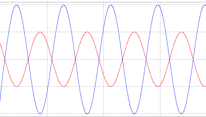

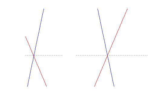

Back to the LM358 and related...
I tested an LM358 at least theoretically, and it looks quite good. So far only one frequency and one gain setting, but i can do more easily. The results as well as the internal diagram are shown in the attachments. The second picture is a Zoom in of the crossover points.
