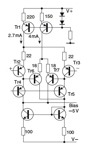

Another problem with making a differential amplifier from discrete transistors is offset drift with temperature.
When two devices are physically separated by a distance they tend to have different temperatures especially if there are any air currents. The closer they are together the better they stay similar. Not only should they be close together, they should be a matched pair. You can get matched pairs but they are quite expensive. You can also get transistors on a single chip (very close together then) but they may or may not be matched. Matching here means they both track over temperature. A mismatch causes a change in input offset, which in turn causes an output offset and so limits the useful gain of the stage.

You are spot on. A good way to keep the output offset to a minimum is to use the servo approach where an op amp monitors the output voltage and adjusts the input stage to make the output offset virtually zero. This is at DC so it does not affect the audio frequency range which is typically taken to be 0.1Hz to 40 KHz for audiophile amps.
Another consequence of not matching the transistors and their operating conditions is that the dstortion goes up. In hi-end amps they go to extrodanary lengths to keep the two input transistors running the same and under optimum conditions:
(1) matched transistor fabrication
(2) physically close
(3) optimise Ic (higher Ic better for minimising distortion and frequency response. low Ic better for low noise)
(4) minimise current modulation index (change in Ic for for input sigal= dic/IC)
(5) optimise VCE (high good for minimising distortion and maximising frequency response but bad for noise)
(5) minimise voltage modulation index (change in VCE for changes in input voltages = dvc/VC.)
Just the input stage of a high end amp is a subject in it's self! The first time I saw one of these circuits I couldn't make head nor tail of it. This one is fairly simple as they go and the practical aspects, decoupling etc, have been left out to make the fundamental operation clearer:
