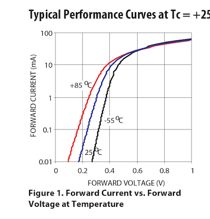

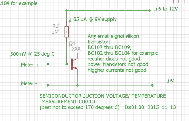

Yes all diodes can be used as thermometers, which is the essential part of modern disposable digital thermometers used in hospitals.
You can even heat up a power LED and measure the voltage drop with rising temperature or pulse it off and measure the Vf at 1mA to eliminate the variation in all LEDs due to ESR only. SO one can accurately measure the junction temp when they are driving them hard. Some are -3~4mV/deg C but depends on chemistry and can be found on most datasheets. ( but not the 1n4148)

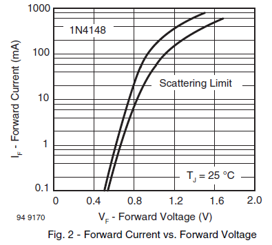

I'm sorry, but this is completely false. Semiconductor diodes start conducting at zero volts, and the current to voltage relationship is a power law. The forward voltage Vf (also falsely referred to as turn-on voltage) is simply the voltage drop across the diode at a specified current (often 1 mA), which is often well higher than RF signal levels which can still be detected. So, relying on Vf values is misleading.
Many weak radio signals are less than the typical Vf of a diode, but the diode will still detect the signal.
While Vf does give a vague indication as to whether a diode may be suitable as a detector, there are other more important parameters that determine how well it will work for weak RF signals, (signal levels well below Vf).

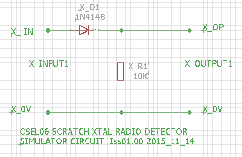

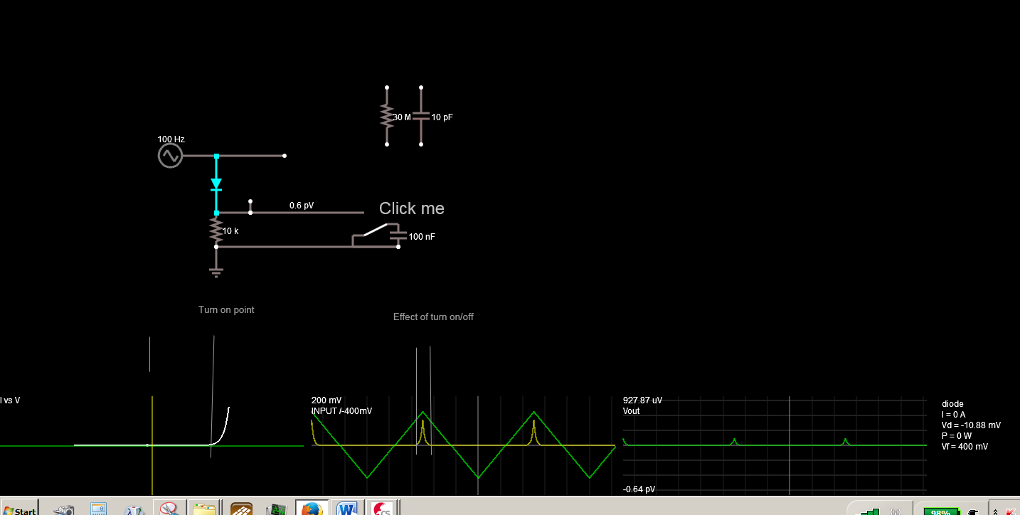

It's just occurred to me that if one of the emulation experts could do a run with a diode connected to a resistor, say 10K Ohms, with a sine wave input and plot against output that would be very interesting. Say start at 0V peak to peak and work up in 10 mV steps. I don't have an emulator myself or I would have a go.

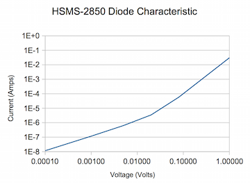

I'm sure you have, but maybe didn't realize. A typical 1N4148 behaves this way, but IV curves on typical datasheets tend to emphasize high level signals, and the low voltage behaviour is hard to read. However, have a look at the attached sample IV curves. You'll note that even with the voltage below the so-called VF, there is still current flow.
The last IV graph is an HSMS-2850 replotted as a log-log graph to highlight the fact that there is no point where the current abruptly stops flowing while the voltage is still greater than zero.

You make me smile- I have done similar experiments way back. I was testing a circuit built with some expensive components (new fangled transistors) and read that the gain went up with temperature so I heated it all up with my mom's hair dryer. The gain sure went up, but so did the transistors. That cost me about 3 months pocket money.

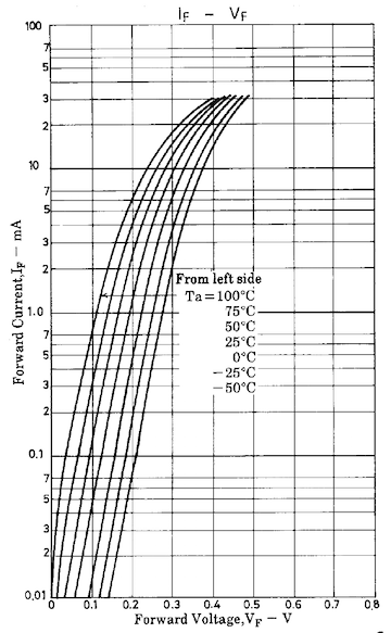

The voltage depends on the semiconuctor bandgap which should decrease fairly linearly with temperature. Have a look at this:
What you have probably seen is the nonlinear effects from the bulk resistance ( I think that is the term) , which cloud the issue, more so as the current through the diode is increased. The 1n4148 is a fast diode with low leakage but I think it has a relatively high resistance. The 1N4001 has a low resistance but a high leakage which would also cloud the issue. Try putting less current through the diode: 10uA would be good if you have a high impedence digital volt meter. The emitter base junction of a small signal transistor should be quite good for temperatue measuerements. Try both the base/emmiter junction and then the base/collector junction.
Water can never get hotter than 100 degrees C, it's a pysical impossibility, unless it is pressurised that is (no doubt you know that). What you were measuring, I suspect, was small bubbles of steam.

Could I be cheeky and ask you to have a go at the model in the attachment, when you have the time that is- I see from the number of posts on ETO that you are pretty busy:
(A static graph of X_OP against X_IP would be ideal)

As a favour to Spec...
Here is output of a triangle voltage input is shown on load R as V=I*R
.. neglecting leakage R and diode capacitance and leakage R and noise current , both which limit how high your load resistance can be , hence sensitivity of diode is much less than typical Vf at rated current but much greater than zero. Perhaps 5% of Vf rated@1A is a useful Rule of thumb in 10Meg load range... This affects sensitivity
you can edit any value ( right click) on schematic
or add any node to scope
FALSTAD SIM uses Java may be slow . Stop when not in use.

Many thanks for the sim Tony- what a powerful tool. It does show the 'cut-off point' as I call it as can be seen in the attached image.
Having said that, I agree with the points that Bob made in his second post but more about that when I can have a good look at the theory in the reference.
As you say, the leakage and noise limits how small a signal can be detected, at least that's how I see it anyway.
