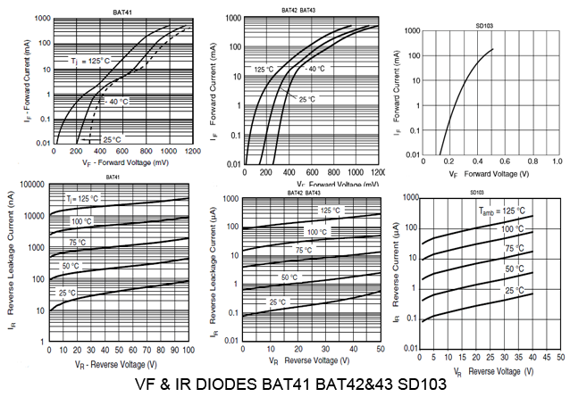

I haven't any hands-on experience of crystal radios, but it is clear that the detector diode characteristics are the critical issue. As has been implied by the other posts, the forward voltage (VF) of the detector diode defines the lowest amplitude signal that will be detected. This will not be a gradual thing: below the detector diode VF you will get nothing. It's only when the peak of the radio signal sine wave reaches the forward VF that you will get an out put. But another important characteristic is reverse current (IR), because it's not much good if you pump a nice charge into the detector capacitor on the positive half cycle of the radio signal only to have it sucked out again on the negative half cycle.
As stated already, the forward voltage (VF) of germanium diodes is 300mV and 600mV for silicon diodes. Schottky diode VF is also 300mV, which means that they should make good crystal radio detector diodes. But one disadvantage is their high IR. But the IR of small signal Schottky diodes is similar to germanium diodes. Generally, with semiconductors there is a trade-off in parameters. For example, you may get a Schottky power supply rectifier that will handle 10 Amps but it could have an IR as high as 5mA. This, among other factors, means that they would be totally unsuitable for crystal radio detectors.
I'm afraid to say that, in theory anyway, any form of light emitting diode (LED) simply has the wrong characteristics for this job.
The 1N4001 series and 1N5189 series of silicon rectifiers while, having some advantages, have too higher VF and IR and probably to higher capacitance. The 1N4148, 1N916 etc are high speed, small signal diodes with low capacitance but they are also silicon and therefor have a relatively high VF.
With all this in mind, I had a look at some small signal schottky diodes and put together a set of graphs from the datasheets of four likely candidates as shown in the attached image. Going by the graphs the SD103 looks particularity interesting as it has the lowest VF. Mind you, it also has the highest IR as a consequence, but I don't think that it's enough to cause a problem. Anyway, by definition, the detector reverse voltage in a crystal radio is very low, so this will keep the reverse current low in practice. The only slight problem with the SD103 is that it is only available in a surface mount package, but for experimental purposes just mount it on a small piece of printed circuit board so it can be handled easily.
Here is a list showing the VF at 100uA and IR at -2v for the schottky diodes:
DIODE___________ VF______ IR
BAT41__________270 mV___10 nA
BAT42 & BAT43___200 mV___100 nA
SD103__________180 mV___100nA

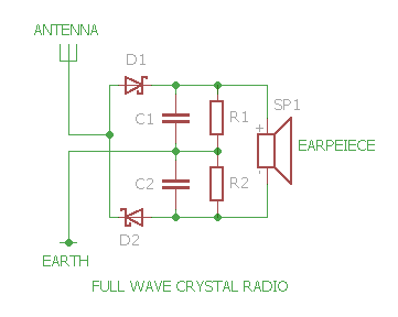

In theory, the performance of a crystal radio could be radically improved by matching the voltage/current (V/I) characteristics of the signal from the antenna to the input V/I characteristics of the detector circuit. This would require a bit of design work and experimentation, but I suspect it would be fairly simple to do with a miniature transformer which could be made at home. This is the approach used on the more advance crystal radios that I have seen on the internet.
Another, big improvement would be to tune the input to the frequency of the radio station that you want to listen to. This could be done with a singe capacitor if you just wanted to listen to one station or a number of switched capacitors or even a variable capacitor for many stations. I suspect that tuning would not only make the crystal radio selective but could also be designed to produce a higher voltage from the radio signal. This would better suit the diode detector.

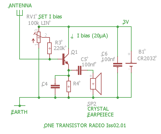

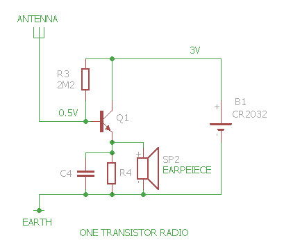

Here is a schematic for a one transistor radio. Once again, this is just a circuit idea and not proven, but I think it has a lot of potential for development and should outperform the single diode type. By biasing the transistor on with around 20μA collector current, the diode VF and IR problems should be greatly reduced, hopefully!
Another advantage is that there will be a better drive for the earpiece and the antenna matching should be better, especially if tuning is designed in.
This approach does need a power supply, although a button cell will do. A few solar cells connected in series would be another possibility, unless you need to listen in the dark that is. Pretty much any supply voltage will be OK as long as the VCE of the transistor is not exceeded. To change the power supply voltage R3 needs to be changed in proportion but the value is not critical. Here are the values:
Voltage____R3
3V_______2M2
6V_______4M7
9V_______7M5
If the high value resistor for R3 is hard to get, let me know; I can change the circuit to suit what you have. Q1 should be a small signal type: BC109 etc. Once again not too critical, although a radio frequency type would be ideal, but it must have a current gain (hFE) of at least 20 at 20μA collector current. It would probably be best to divide the normal value for R4 used in single diode crystal radios by 10 and multiply the parallel capacitor, C4, by 10 to lower the impedance while keeping the same time constant.
ERRATA
(1) The 0.5V at the base is incorrect: I forgot to add the voltage across R4
(2) It may be better to put a capacitor between the emitter of Q1 and the earpiece, say 10nF upwards, but not an electrolytic type.

It looks pretty nice and simple. I will remove emitter resistor because I am going to use my pretty loud dynamic earpiece which is already around 32 ohms. (also I will try with emitter resistor with crystal earpiece with 7V or 9V supply with high swing.) Sure will share result here. Probably I don't need huge antenna here as discussed before. Thank you!

Hi Willen,
Great to know you will be doing some experimenting.
Just a couple of points though:
The time constant, R4 x C4, helps to recover the audio signal from the radio signal efficiently so you may need a larger capacitor if you put a 32 Ohm earpiece in the emitter. In theory, it should work even without a capacitor but I'm not sure how well. By the way the impedance of a crystal earpiece is around 20k Ohms so there is a radical difference between the two earpieces.
The single transistor circuit will not produce any more voltage than the single diode circuit however high the supply line is. It's effectively an emitter follower which has a voltage gain of 1. What the one transistor circuit should do is to recover the audio from much smaller radio signals and 'not cut off' as badly as the single diode circuit.
As far as the development of the single transistor circuit goes though, it would be best to try the circuit with the high resistance crystal earpiece first and get that working. I suspect that the transistor bias current will be critical and need some adjusting to get the best result. An adjustable bias control may be useful for development and could even be worth having as a permanent feature.
Once the basic concept has been established we could then take the next step and develop a circuit that would make your 32 Ohm or crystal earpiece as loud as you like. To get the maximum voltage swing from a 9V supply you would need +-141 mA peak to drive the 32 Ohm earpiece which is quite a lot of current. It would be extremely loud though and you would need a volume control!
This is what I have in mind for the development circuit:
C5 should make the crystal earpiece sound better by removing the direct voltage and C6 is just decoupling which is always a good thing. Neither value is critical, but C6 should be a high frequency type; ceramic is a good choice.
A time constant of 100 microseconds seems about right to give an audio frequency response to about 5kHz. An R4 of 5k6 and a C4 of 3n3 would suit the transistor and will have a low impedance compared to the crystal earpiece impedance load of 20K Ohms.
