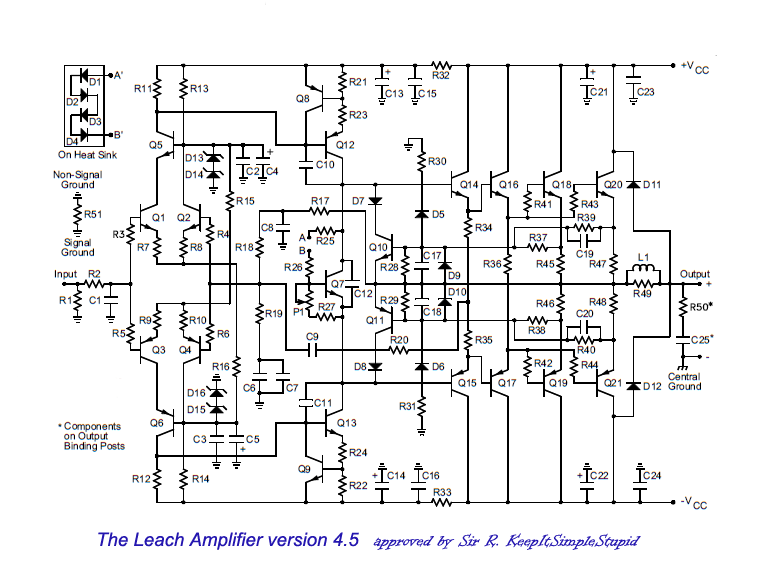

I am curious now, do I able to make dual-rail supply amp? I said despite I not have much money but I will spend money for sound quality. Usually one times for several years I have a big project so I won't afraid so much about spending.
Don't worry!
Yes, build dual rail amp- it would be far better than single rail, but only spend money were essential, and then do it in stages. Like I say, one bridge at a time. You can't build a house until the foundations are designed and laid. Just to say again, case, heatsinks, PSU first. They are the amp foundations :arghh:

Leach Amplifier Output Current Protection Components
Positive
R39, C19, R37, D9, C17, R30, D5, C17, R28, Q10, D7, Q8
Negative
R40, C20, R38, D10, C18, R31, D6, C18, R29, Q11, D8, Q9
Very sophisticated and will allow plenty output current :cool:

This is again where the case and power supply eat up the costs quickly. Let's just say you picked this http://www.digikey.com/product-detail/en/LNR1K103MSE/493-7694-ND capacitor.
Some choices are: Do you want two independent dual supplies or one single one. Custom transformer or two separate ones.
For a double dual supply/case might have:

No power limiter in my version. I did use the alternate feedback network. fc=~50 kHz. It used 3 diodes in series, not 4 for thermal compensation. Three is easier to mount.

Thanks for your carefully, it isn't the first time I made an amplifier, I have made LA4440 amp with TDA2003 BTL subwoofer in my summer holiday. This amp pretty complete. The case made from wood. It sound better than many high grade computer speakers but sound not loud enough to fill my living room in holidays.

Well, I forgot your drawing, spec. The draw very look nice but I fell it has some problem:
- heatsink use as back panel. How can I attach spring wire terminals, RCA jack, headphone jack....?
- no space for subwoofer circuit?
On back panel in centre. Will detail drawing further to show all
Two options.
Make case wider to take sub amp if that is the way you want to go or make separate sub amp case.
