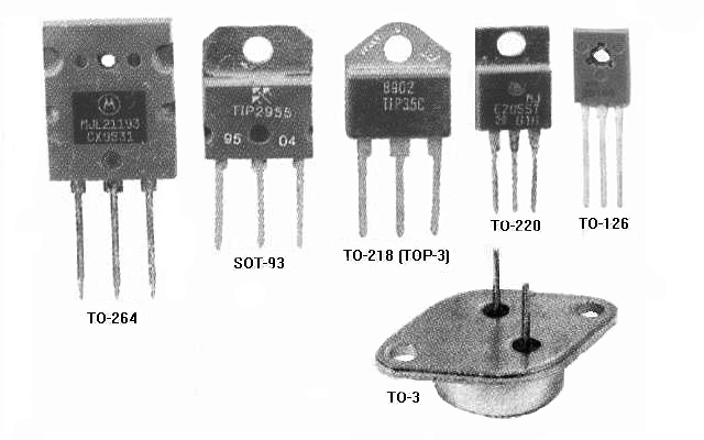

TIP41-42 don't need a heatsink, right?
Right, but put individual heatsinks on each because you are a professional and not difficult to do anyway.

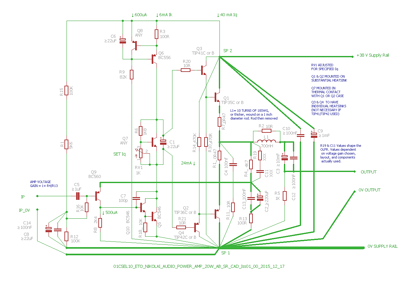

Can you do a drawing of your intended case because, if a certain design, it can be used for a very good heatsink for the output power transistors. That would be best.

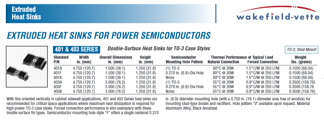

Instead of guessing about a heatsink, go to www.digikey.com and search for Thermal Heatsinks where they have thousands with dimensions and thermal ratings. But they are not in a logical sequence and entering your dimensions did not find one. So go to the website of one of the many manufacturers listed.
Hi audio,
I would not be guessing, but a good suggestion all the same.
That site, I suspect, would not cover the case as heatsink approach, but haven't looked at it yet.
In the meantime could you do the dissipation calcs for each output transistor, both in the 40W and a 20W amp versions.? That would be help because it would save me doing it.
spec

Most class AB amplifiers are about 60% efficient so a 40W amp would have a total draw from its power supply of 66.6W and heat with 66.6W - 40W= 26.6W, about 12W for each output transistor and about 1.3W for each driver transistor.
But music is not continuously at full blast so I think heatsinks calculated at 8W for each output transistor will be fine.

(1) C1 & C9 should read 4m7F (4,7oouF) minimum
(2) 60V label should read 38V

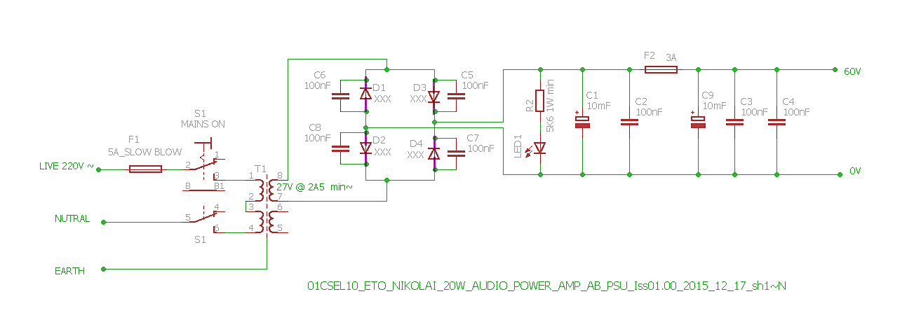

Can you change schematics to PCB layouts?
I also want to know what kind of PCB should I use: glass or bakelite or other type? Now I only have bakelite
A typical substrate is FR4 glass epoxy, 1 oz copper. I used 2 oz copper for my amp.

I can't no. I am new to Eagle and don't know how to do it at the moment- much as I would like to.
Fibreglass by a mile
Thank you anyway. I plan to print the schematic into paper, then I will use my "traditional method" to make PCB. draw copper track with permanent makers then etching. :D:D:D
