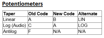

Your photo has a pot marked "B" so it is a linear pot, not an audio volume control that should be marked "A".
