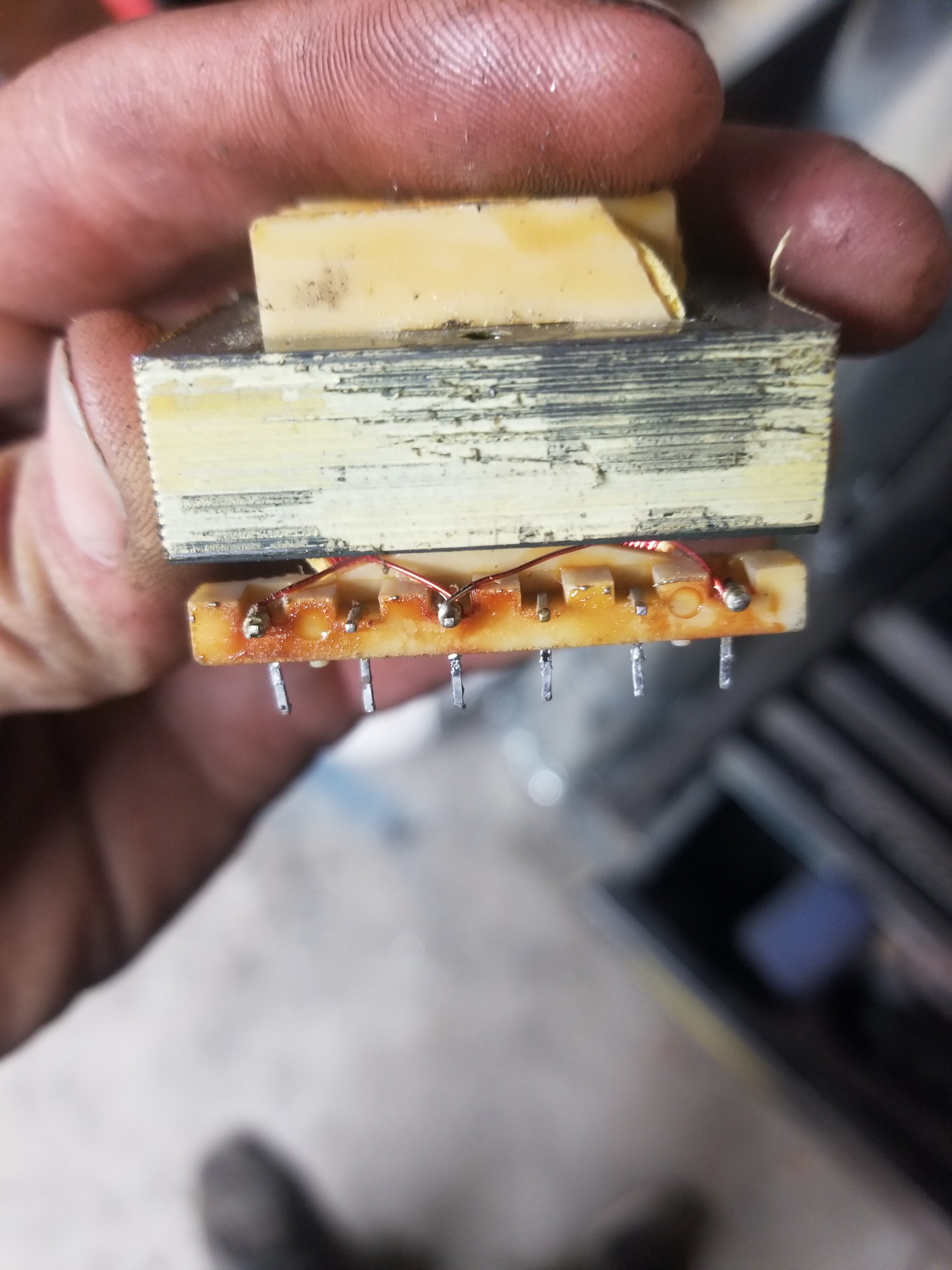

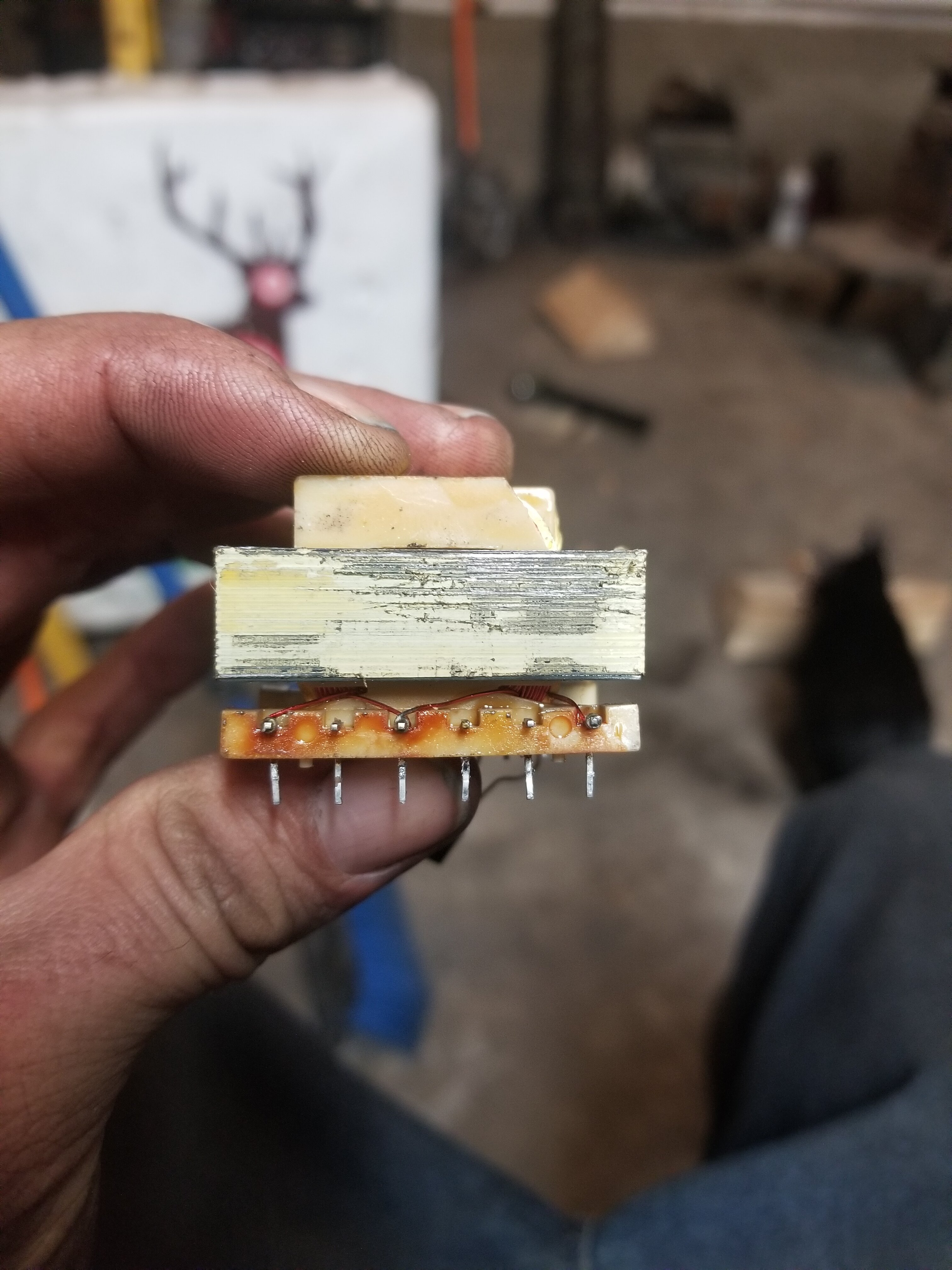

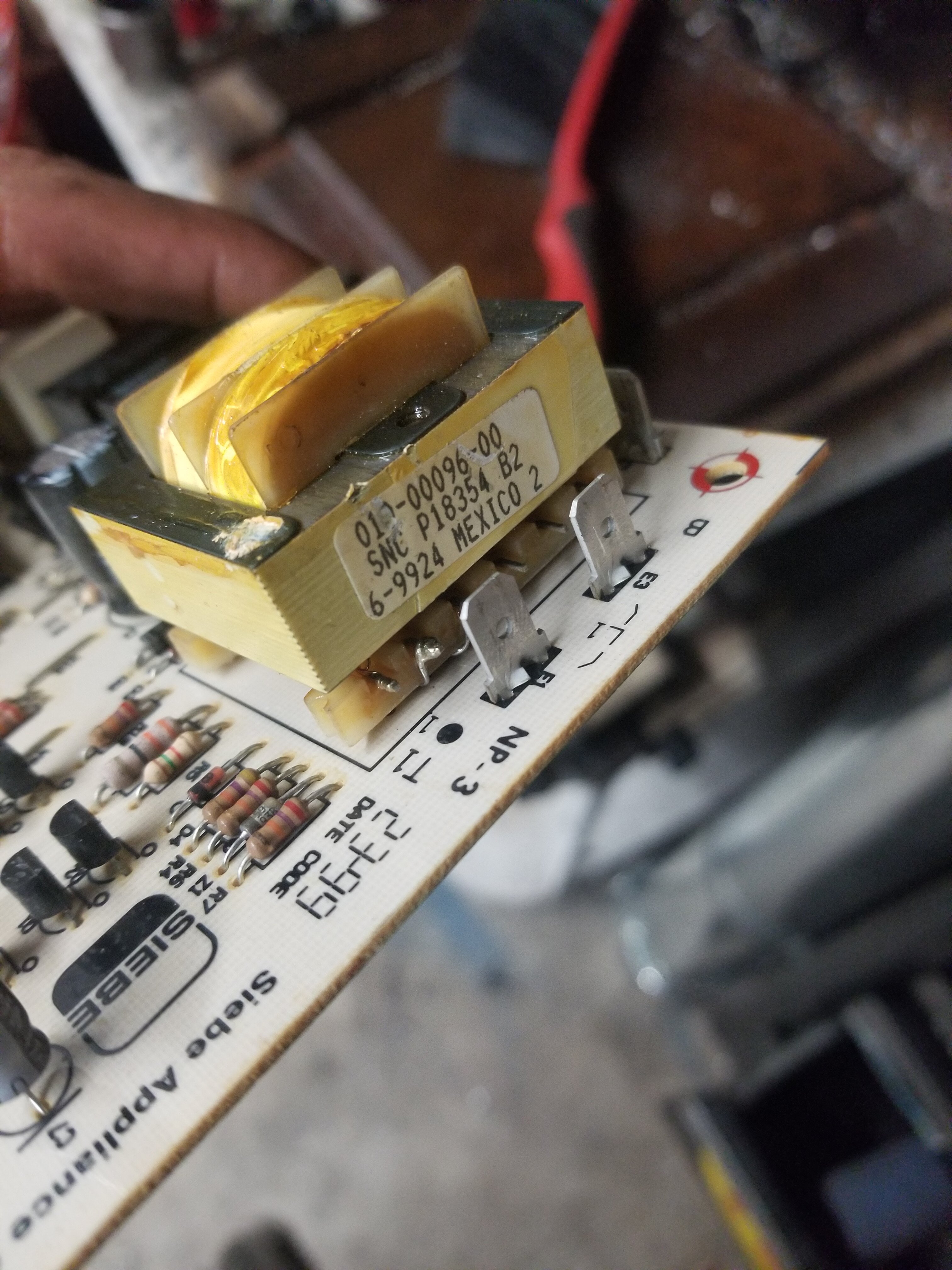

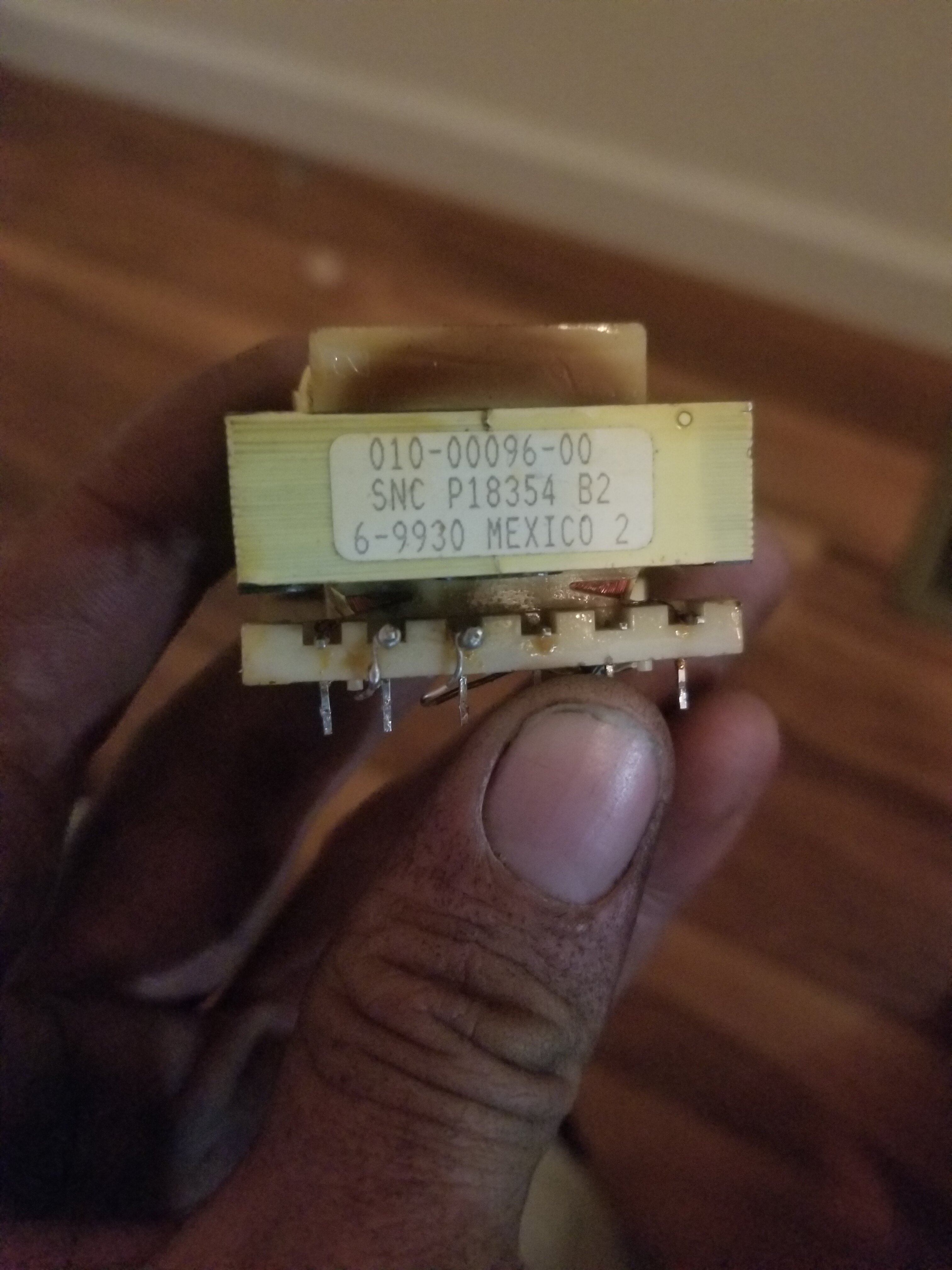

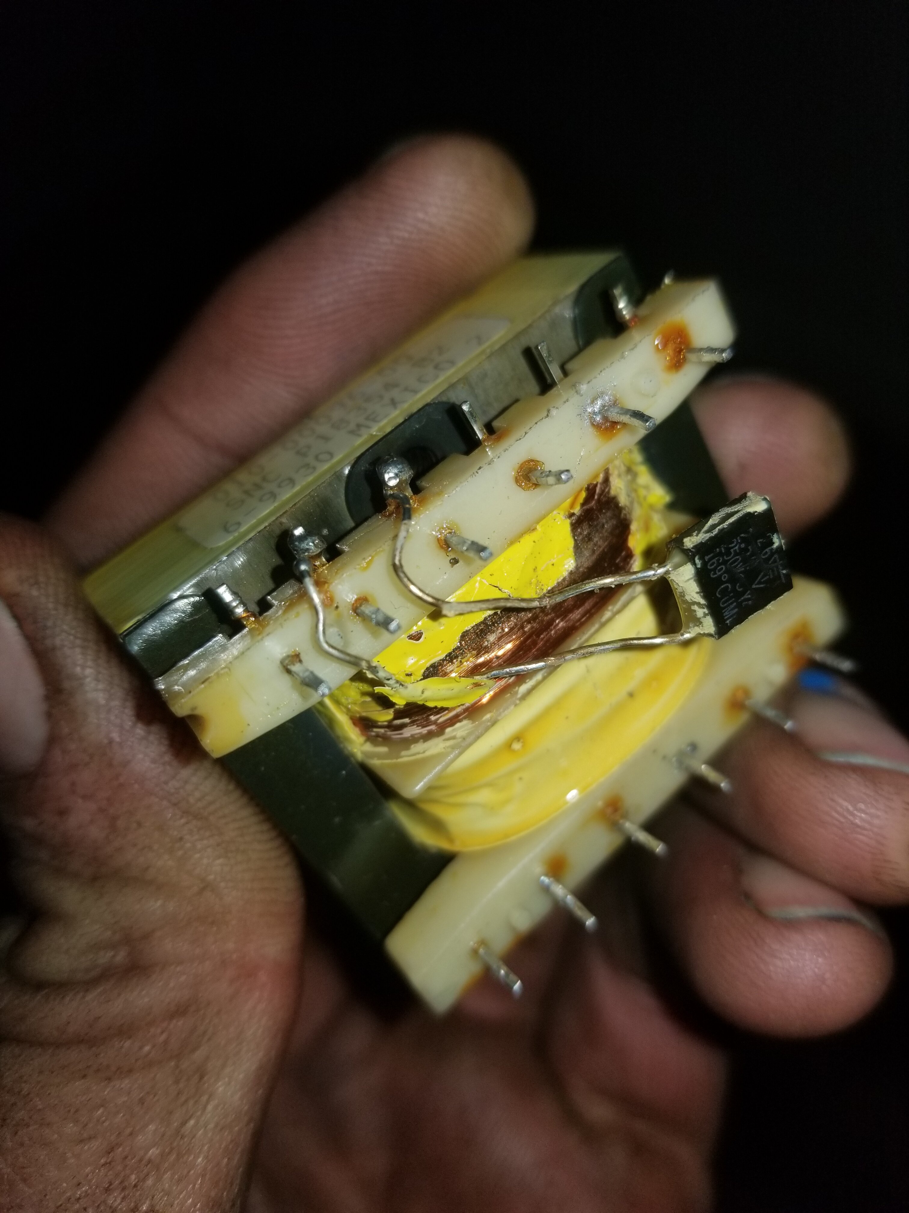

Hello I was hoping someone could shed some light on this transformer. It goes to my oven and I'm trying to identify it so I can buy a replacement to solder back on the board. I've never dismantled a transformer before but this particular one has me scratching my head. The input wires go directly into what appears to be a transistor? Which was taped to the first winding. An explanation of how this works would be cool.. even cooler what are the specs of this thing so I can order replacement.
Thank you

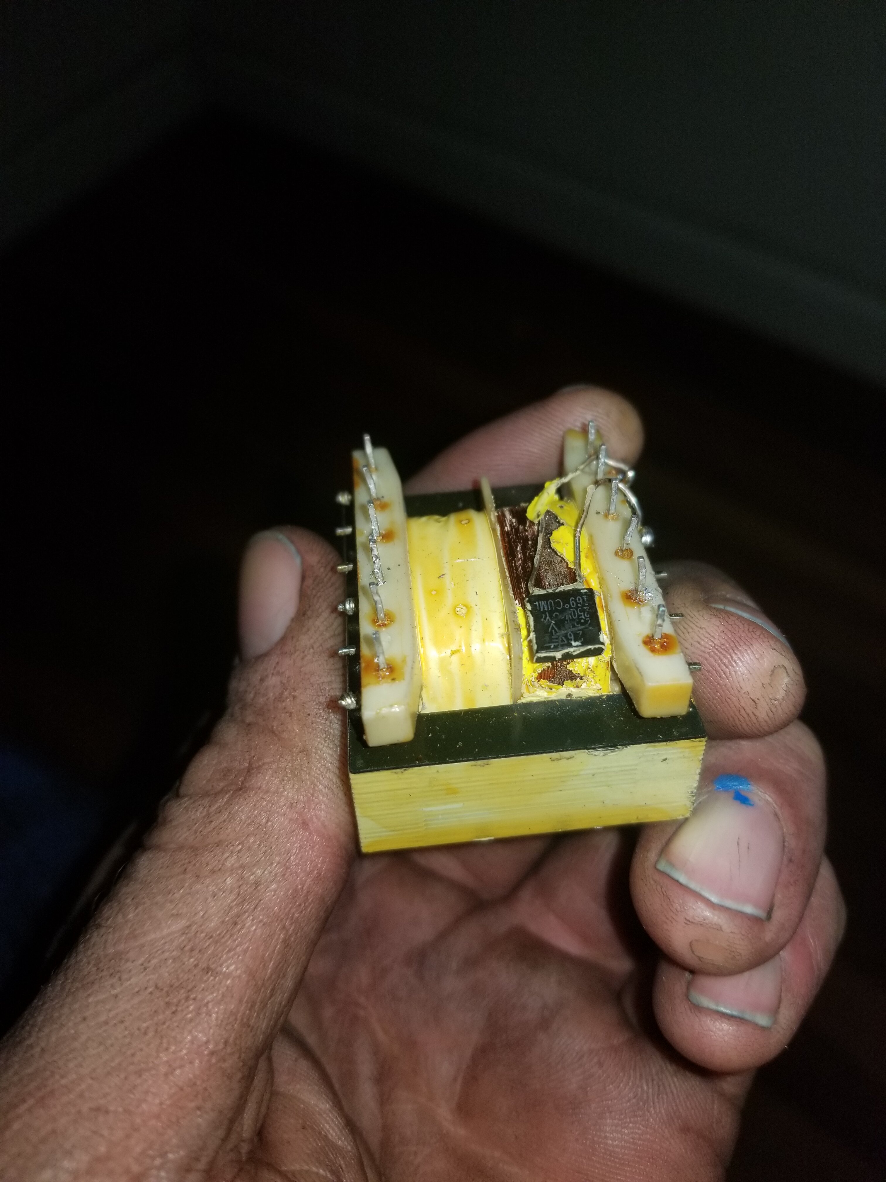

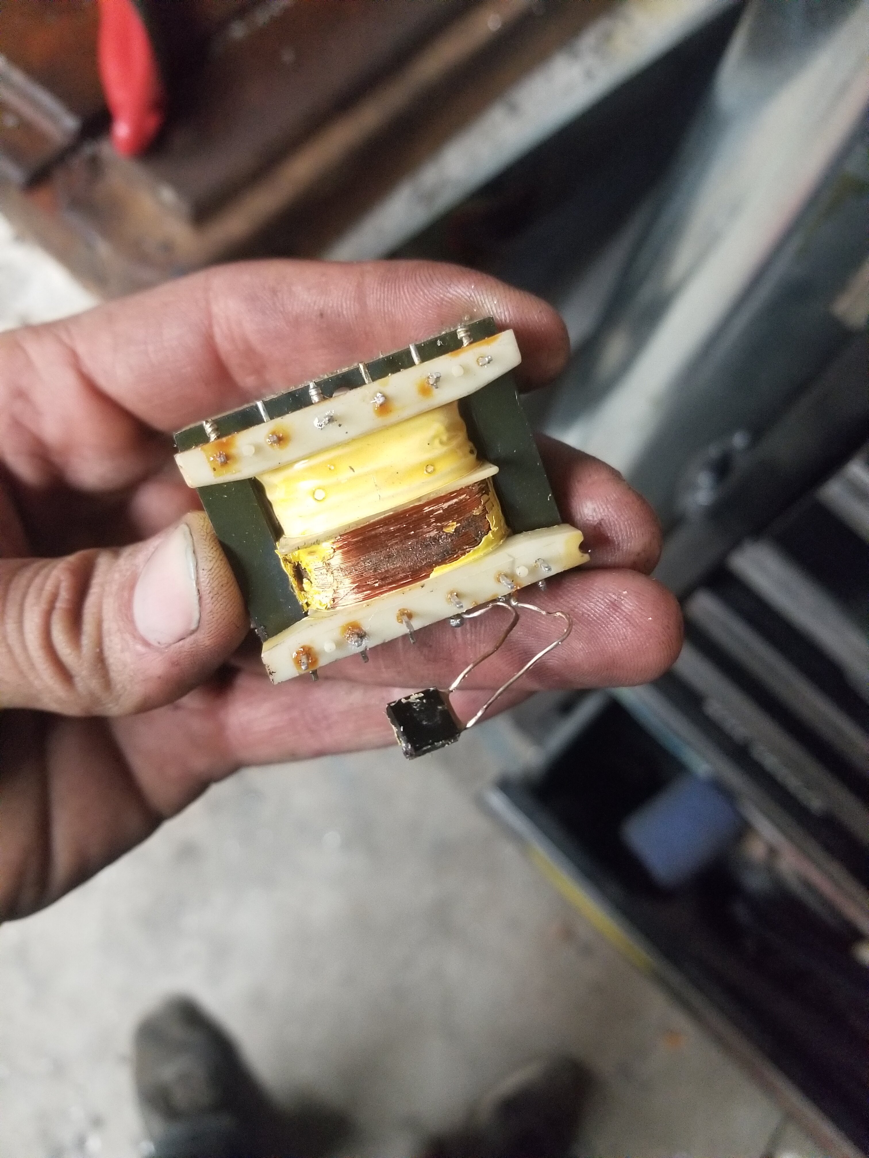

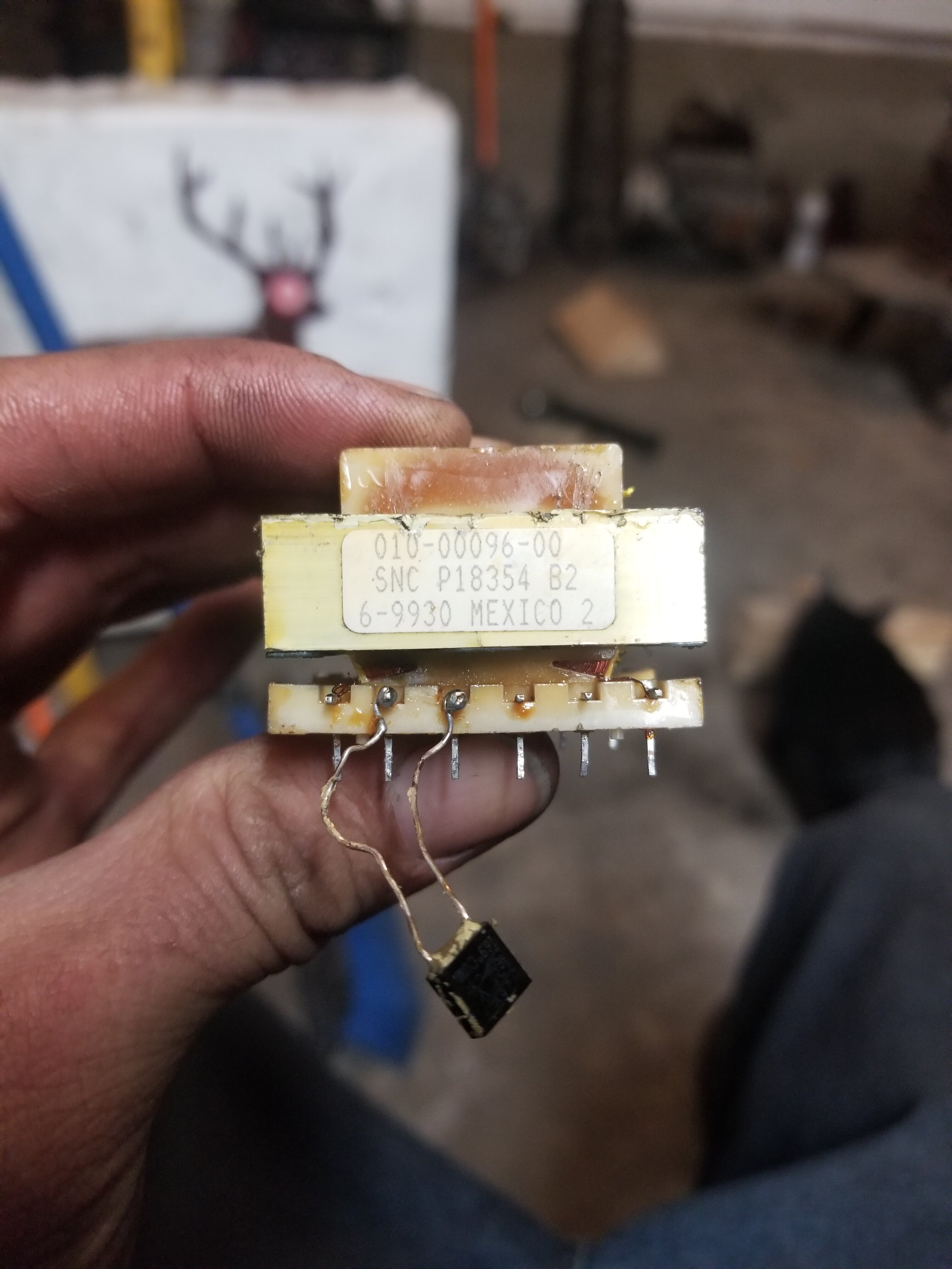

The device in the windings is a thermal fuse, it's there to disconnect power and prevent a fire, in case of a fault.
They are very common in appliance transformers.

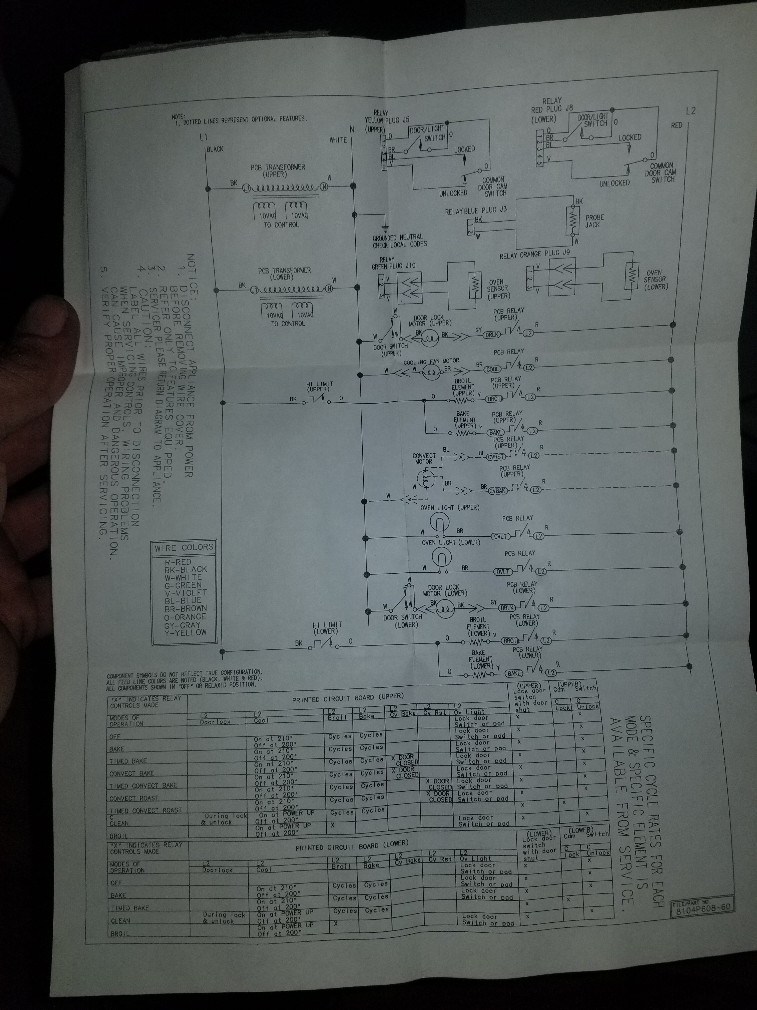

The transformer part number turns up an appliance model with a schematic ; Jenn-Air SVE87600B or Maytag???
If that is correct, the transformer is presumably 110V primary with a 10-0-10V secondary, and this is the oven control schematic.
It looks like there may be three of those transformers in it, if this is the correct thing?
Oh thank you. Yes it's a jenn-air/maytag double oven. This particular oven has only 2 transformers. They both got fried. Now the search for the replacement with the fuse.

Here is the folded schematic I found in the oven...
So I'm assuming this would be 115v input. 10-0-10 vac output? So this would have a center tap of 0v?

I suggest that you use these:- https://www.digikey.co.uk/product-detail/en/talema-group-llc/62051/1295-1073-ND/3881358
You will need to mount them somewhere else, maybe on the metalwork, but they only need one mounting bolt each. Toroidal transformers usually come with a round metal plate, two round foam pads and a bolt. The bolt clamps the transformer between the metal plate and a flat metal surface that needs to have a hole drilled for the bolt. The foam pads go between the transformer and the metal to even out the pressure.
The transformers I suggested are 9 V, not 10 V, but that probably doesn't matter. A transformer is at its rated voltage at full load, so the original transformers would have been a bit above 10 V, probably nearly 12 V, with no load, dropping to 10 V at full load. The replacements that I've suggested are larger and have a higher rating, so they won't drop as much, and they start at 10.5 V with no load.
Also, you can add a few turns to a toroidal transformer quite easily by just threading ordinary wire through the hole in the centre and around the outside. Each pass through will add about 1/8 V for that size of transformer, so adding 1 Volt isn't a big deal. There's a short thread here https://www.electro-tech-online.com/threads/kef-psw2500-active-base-unit-repair.159244/ about adding a second winding to a transformer. To add voltage, you just put a few turns in series with the existing windings. If the voltage goes down not up, reverse the direction of the additional windings.
The suggested transformer has dual primary winding and dual secondary windings. You have to connect it correctly and as it has wires not pins, you have to be methodical. The schematic of the transformer is on page 8 of the data sheet https://talema.com/wp-content/uploads/datasheets/Transformer-Catalog.pdf
To connect the primary windings to 120 V you connect the live wire to brown and grey, and you connect the neutral to blue and violet.
On the secondaries, the two circuit diagrams are different. One shows the windings connected in series, and the other shows them as separate windings. The transformer that you have has a few spare pins so it's not clear which ones are actually used. If you post a picture of the circuit board that show the tracks, we can probably tell you how to connect up the secondaries.

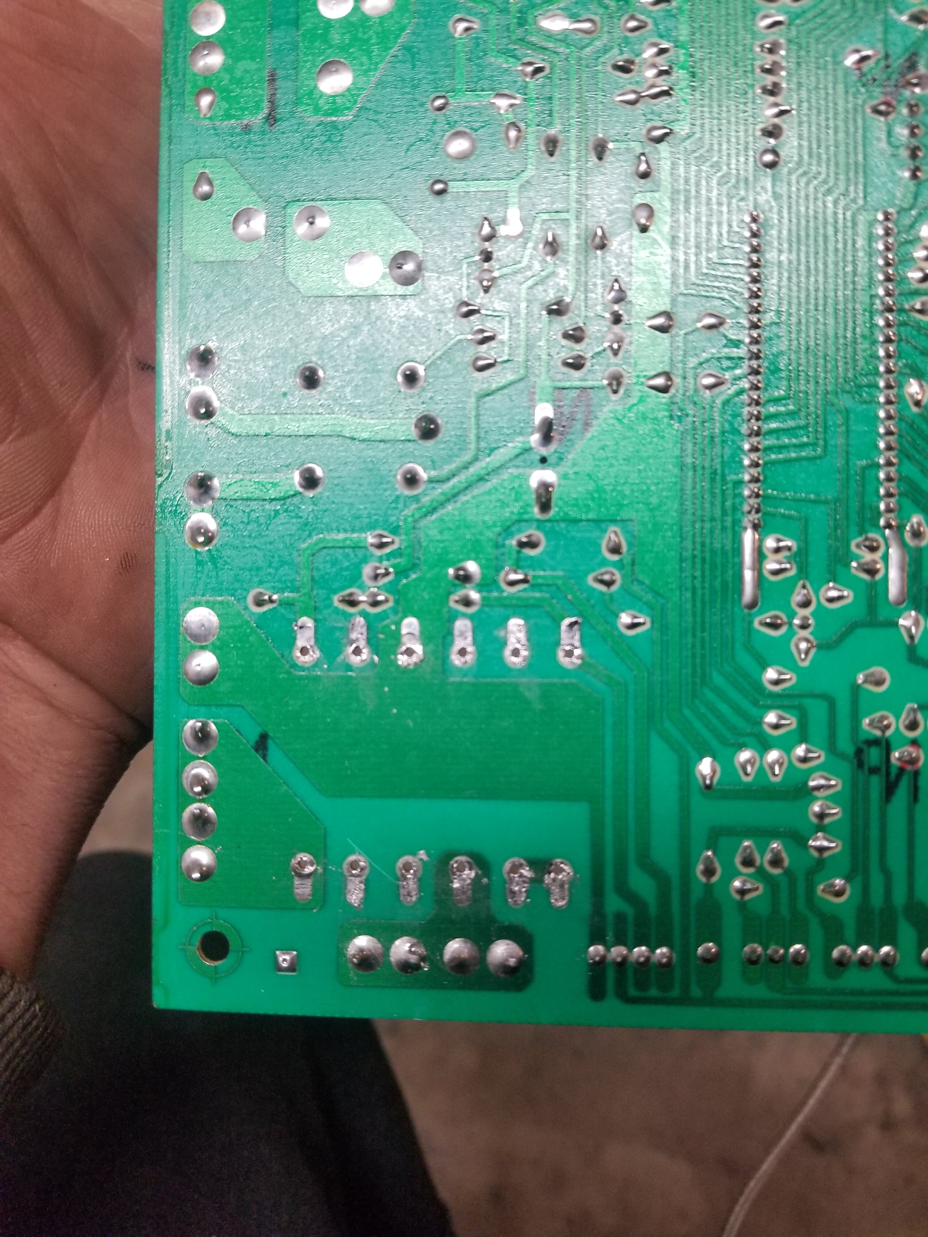

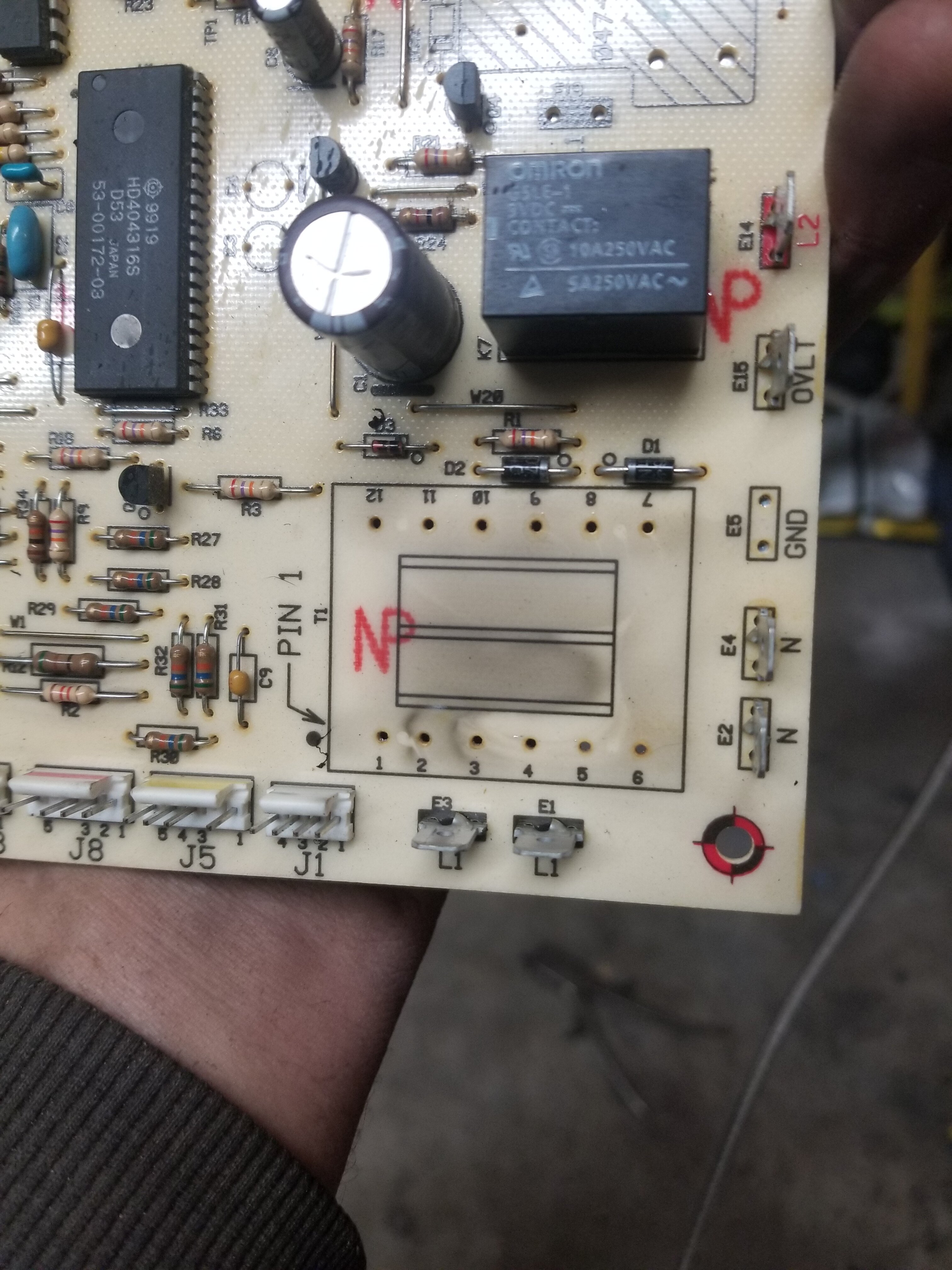

Pins 2&3 are input and pins 7,9,12 are the secondary.

With there only being 3 pins that are the secondary, if you use the transformer that I suggested you need to connect both yellow and black to where pin 9 goes, and red to pin 7 and orange to pin 12. There are other ways that would work.
Pin 2 should go to brown and grey, and pin 3 to blue and violet.
The toroidal transformers probably won't have a fuse and it would be a good idea to add a 1 A fuse in series. On end of the fuse would connect to pin 2 and the other to the brown and grey wires.

Side note... how difficult would it be to dismantle the transformer and remove the bobbin and count the wraps and re wrap it. I already have the magnet wire.
Thank u. I will look into it today...
It's really very difficult. The laminations interlock, and are held together with varnish. It's very difficult to get them out without bending them, then they won't fit back in. It's difficult to get the windings to be as compact as the machine-wound ones that you would be replacing.
I honestly don't think that it's worth trying.
Upthread I suggested adding a few turns to a toroidal transformer. That is very different from the 1000 or so turns that the primary of a mains transformer has. The extra turns that I have added to transformers have been low voltage, low current additions. The low voltage means few turns, so they don't have to be laid very carefully, and the low current means that thin PVC insulated stranded wire can be used, rather than the less forgiving solid enamelled wire.
Also the transformer kits that I referred to didn't have the laminations held together with varnish. They just had some clamp bolts so taking them apart would be merely tedious. Also the primary winding was machine-wound, so it would only be the secondary that would have had to be wound. Also they were bigger than the ones you have, so less fiddly to work on.

I agree. I started dissecting one of them and said f%$@ this. I will order the transformer u suggested.

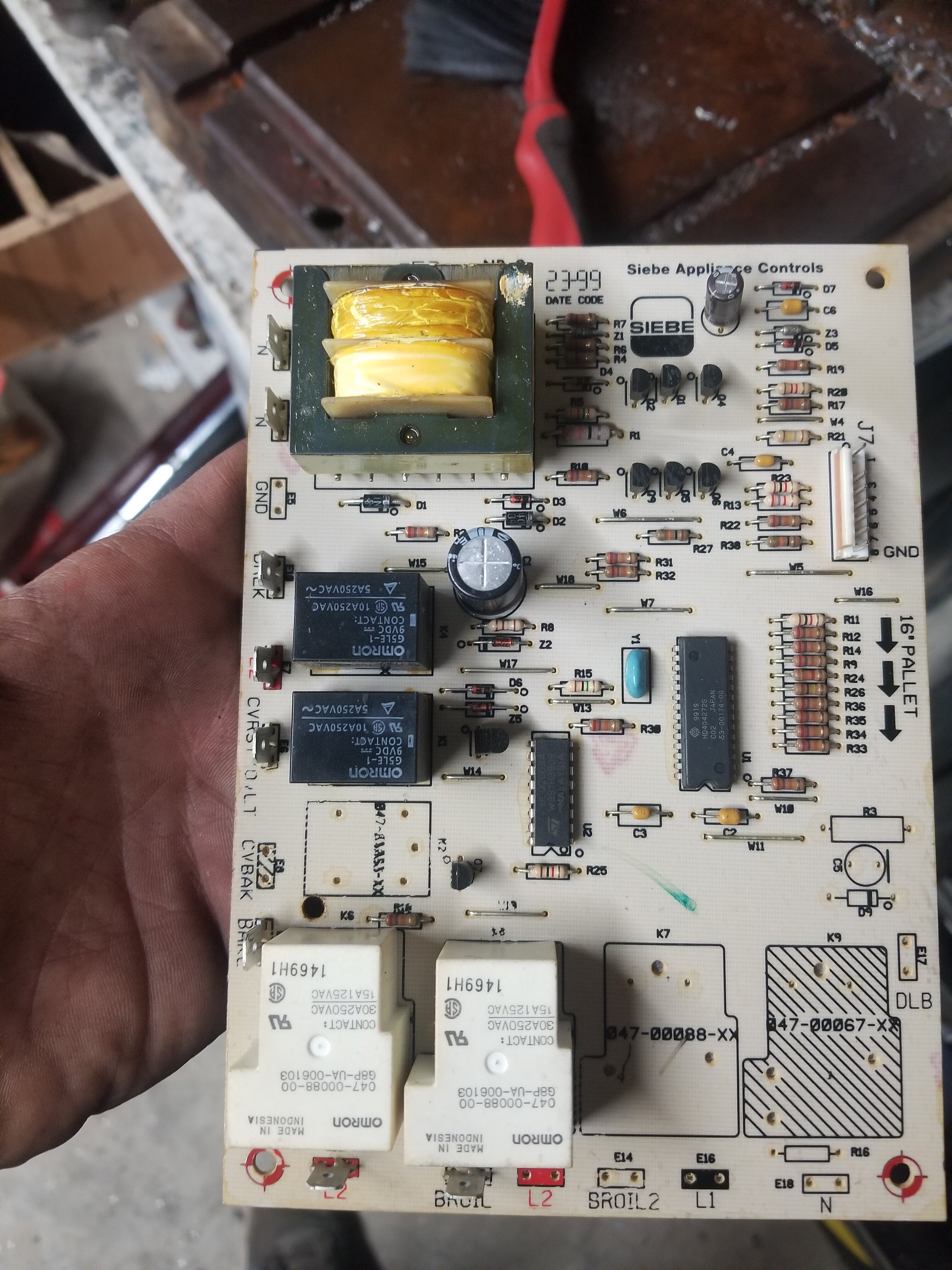

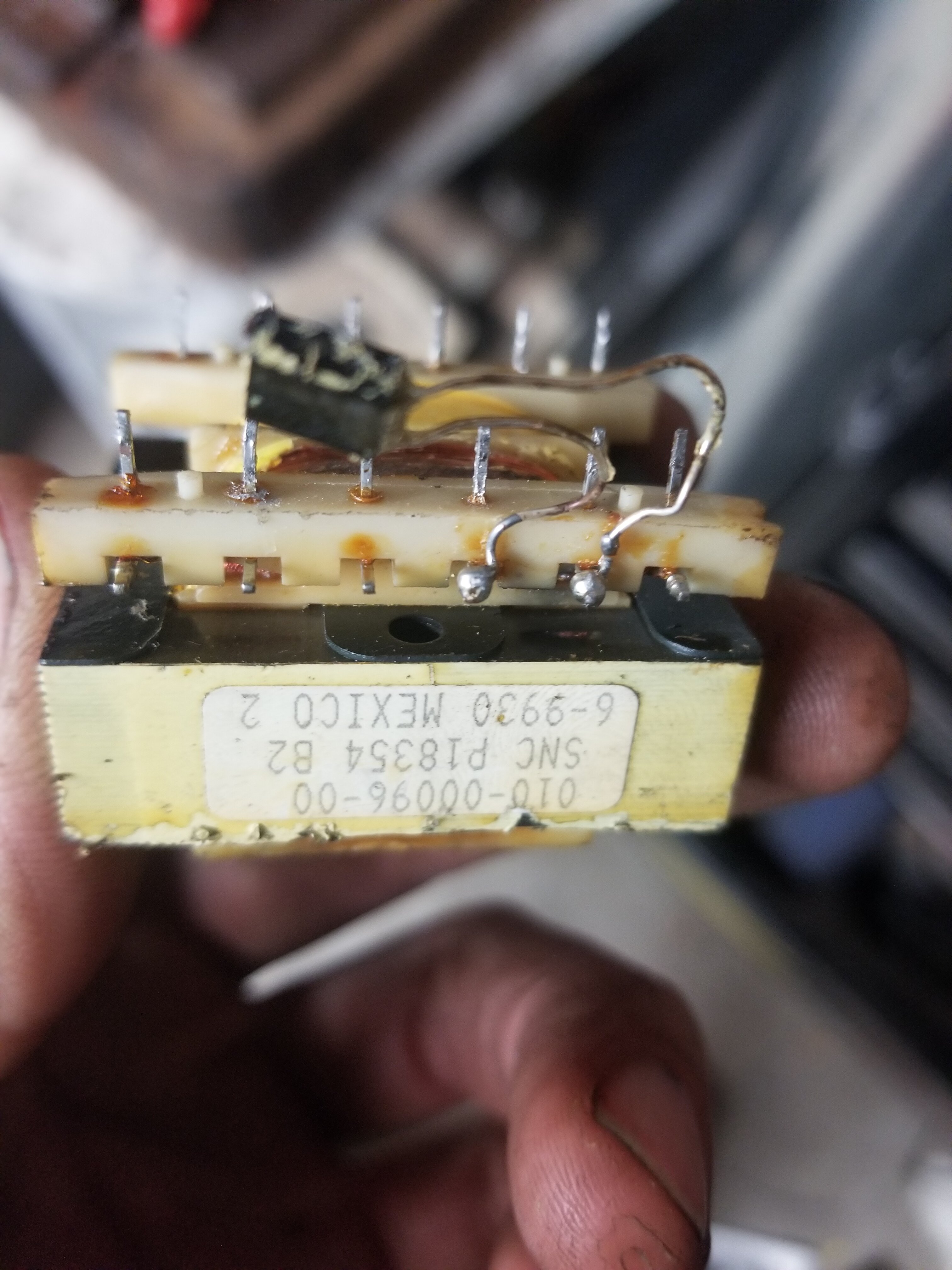

The transformers will be here tomorrow so I wanted to be sure I understand here...
I made a mistake explaining the previous pictures I sent.
The photo with the fuse in it...
Pins 2&3 are only for the fuse.. pins 1&6 are the primary winding. 2&3 run through the board then to 1&6 I assume.
So does that mean I should put brown and gray on pin 1 and blue and violet on pin 6? Then get a 1amp 250v fuse and put it between pins 2&3?

Here's board photos too
