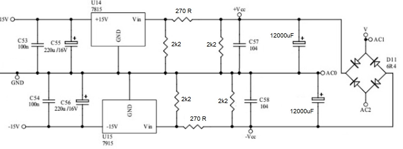

I found the circuit diagram here:- masterelectronicsrepair.blogspot.com/2019/02/kef-psw-2500-powered-sub-woofer.html but the one I'm looking at isn't quite the same. Here is the circuit of its power supply that I have modified to match the PSW2500 that I have here:-
The 270 Ohm resistors are the white, square section ones that are mounted remotely.
The question I have is about the 2.2k resistors. They are 2W rated, and have discoloured, and some have come loose. Obviously the two that are before the 270 Ohm resistors are worse. They are right beside the 12000 uF capacitors.
What is the function of the 2.2 kOhm resistors? Could I just remove them?

The capacitance doesn't matter, it's ESR that does - VERY commonly the capacitance is within tolerance, but the ESR is absolutely shot, and the capacitor is completely useless. However, this mostly occurs with switch-mode supplies, I'm presuming this one is just a conventional transformer.
The power supply itself is horrible though, it's a REALLY, REALLY bad idea having large droppers like that, and as you've seen they WILL overheat and damage the board. It's also really poor not having capacitors across the input of the regulators, I thought 78/79xx's required those?.
As for the 2.2K's?, I can only imagine they are there to discharge the 12,000uF's at switch off.
It is just a conventional transformer. It's a toroidal.
I'm looking to supply the +/- 15 V from an alternative supply, to avoid the dropper resistors. The actual droppers, the 270 Ohm ones are on the heatsink on long wires, so they aren't such a problem as in the video.
It's the parallel resistors that I was wanting to get rid of. I wasn't sure what the consequence would be of omitting the parallel resistors, or having higher resistance ones, would be. There's a relay that disconnects the speaker from the amplifier, and I wonder if the resistors are there to discharge the power supply quite quickly, so that the relay drops out quickly and there isn't a pop from the speaker if the power is turned off and back on again a bit quickly.

The owner got some information from KEF. They won't repair this model any more, but suggested C52 (labelled 5 in the photo) was changed, along with the two big capacitors. It was a useful suggestion as C52 is nominally 47 μF and it measured less than 1 μF and appeared to be discoloured. The two big caps were going to get changed anyhow.
C52 smoothes the supply to the relay that isolates the speaker. The supply to that is half-wave rectified from the main transformer. Label 3 on the photo shows where there was one pair of the 2.2 kΩ, 2W resistors. You may be able to see the outlines of where they were on the circuit board. The other pair would have been behind C52 in the photo, between 5 and 4. Those resistors were running at well over half their rating, even when the amplifier was on standby. C52 had been cooked.
Anyhow, to stop it happening again, I arranged an alternative supply to the ±15 V regulators. The regulators are 7815 and 7915 and you can see their heatsinks at 4. I wound 2 lots of about 65 turns on the transformer (1) to give around 2 x 15.5 V rms with centre tap, and rectified and smoothed that with the components at 2 to give ±20 V which is wired to the regulators.
It all seems to work fine.
I still can't work out why the four 2.2 kΩ, 2W resistors were there. With the ±15 V regulators no longer fed from the big capacitors, the ±55 V supply decays quite slowly, maybe taking a minute to get to ±20 V. The resistors would have brought that down to 10 seconds or so, but it would have been less than a minute if the regulators were also taking power from the big capacitors. I can't see why the manufacturer was so keen to get it to turn off fast. It's a subwoofer. No-one ever turns off a subwoofer at the mains or the switch on the back to silence the sound, as it doesn't work. All the mid-range and higher frequencies will be running. If the sound has already been muted, I can't see any problem with the capacitors going down slowly.
Now that the ±15 V supply is separate, that decays in less than a second. It could be that the amplifier does something funny if the main power supply decays while the ±15 V supplies still work. However, the relay would turn off in well under as second, so I can't see what the amplifier could possibly do that would make a 10 second discharge important, especially when it was those resistors that we such major cause of unreliability.
