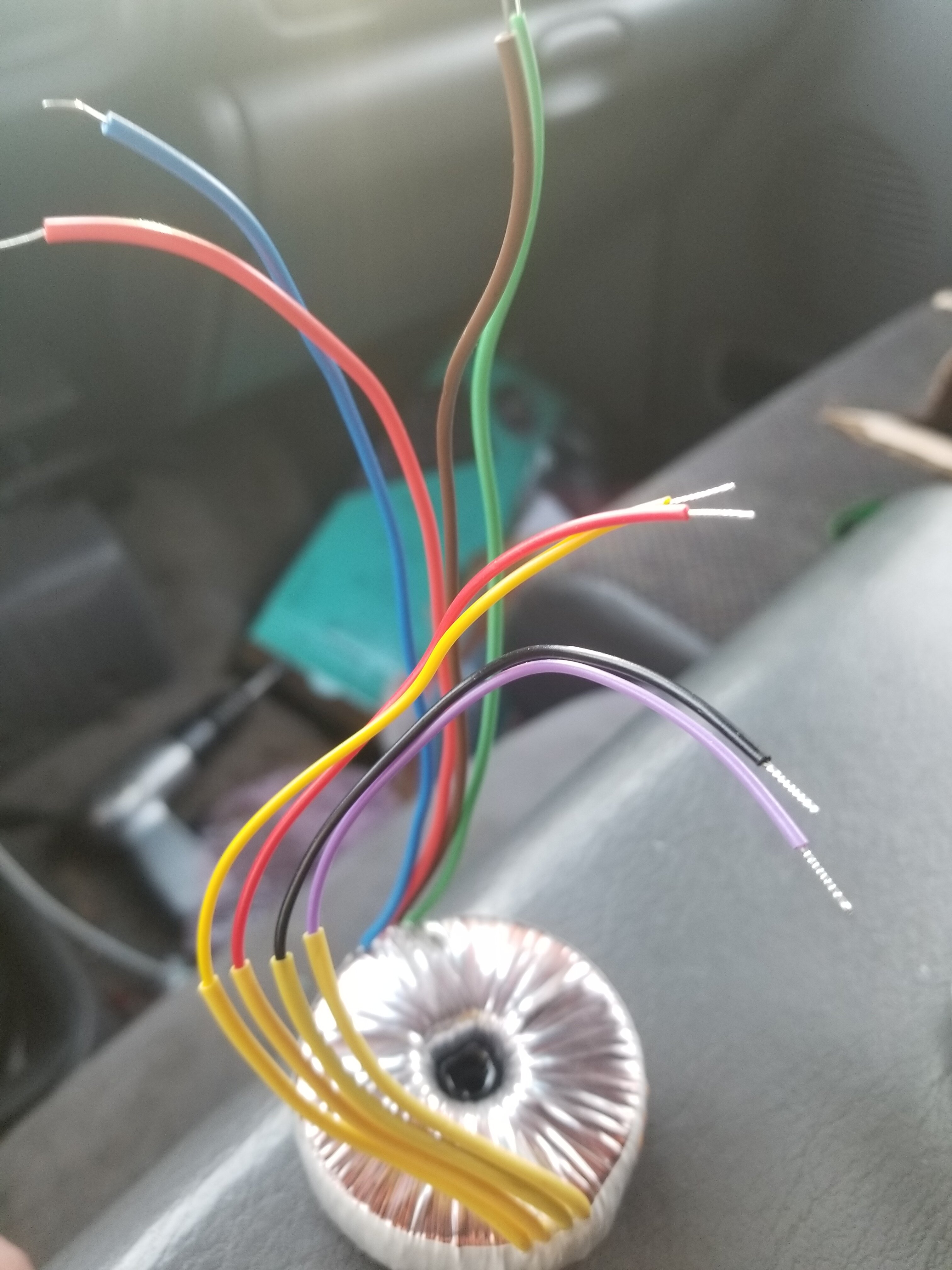

The colors are a little different than expected..

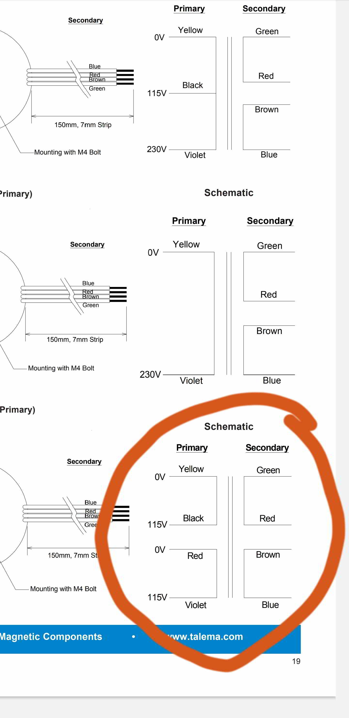

So I would hook black to violet and yellow to red (N)? Then green and brown (0) and red (10) and blue (10)?

You have to connect yellow and red together, and you have to connect black and violet together. It doesn't matter which pair is live and which is neutral. In the old UK colours, red is live. In USA colours, black is live, so take your pick.
On the secondary, you need to connect red and brown together and to where pin 9 went on the PCB. Blue and green go to 7 and 12.
When you've powered it up, check that there's about 20 V ac between green and blue.
Thanks again for all your help. Got to learn some good stuff and save some money. Oven works great!
