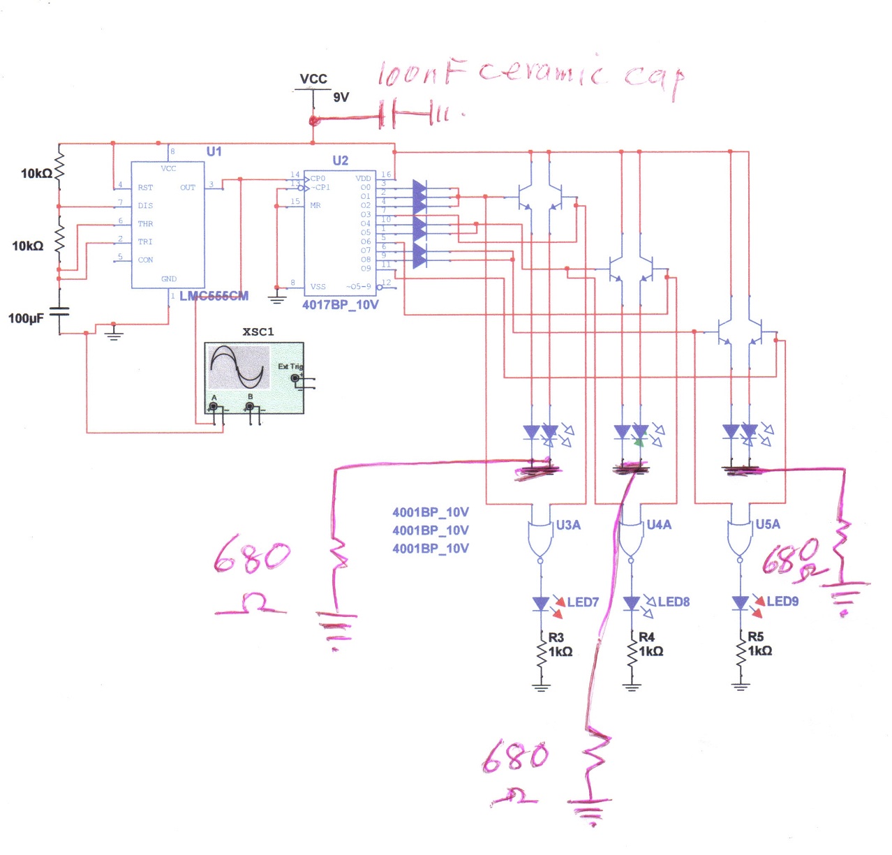

I have studied your latest circuit.
If you are intending to make one, you will need to add resistors in series with the LEDs as in your previous circuit & a 100 nF capacitor connected from Vdd to Gnd.
Note that: what works in a simulation may not be viable in practice.
In this case, you would possibly damage either your transistors or LEDs or both due to too much current.
Without the resistors, the current will depend upon the gain of the transistors & the output resistance of the 4017.
The 100 nF cap is essential to prevent odd behaviour of the 4017.

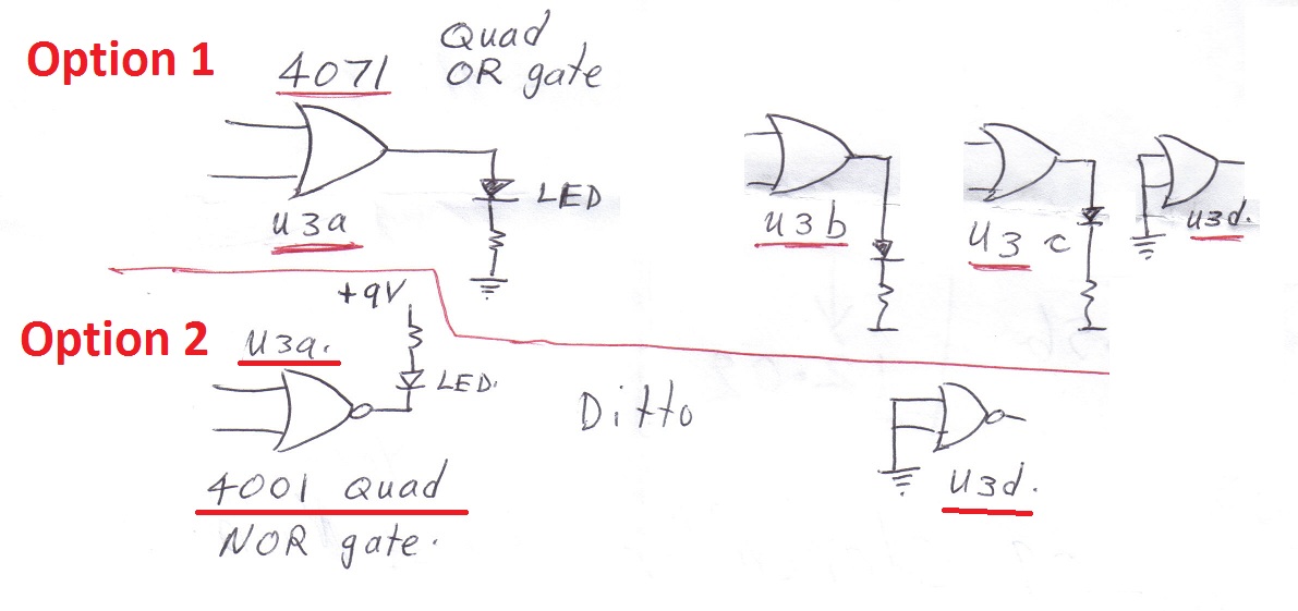

I noticed another problem with your circuit.
You copied a mistake I made in the circuit I posted in Post # 11.
I should have drawn OR gates, but accidently drew NOR gates.
See the attachment - it shows both options.
Also note the IC numbering. The convention is to use letters for the sections inside the IC. So in the example attached, the OR or NOR gate package is labled U3 thus its gates are labled U3a, U3b, etc,
Also note that the inputs of the unused gate (U3d) need to be connected to either Vdd or Gnd. Don't leave them open.
