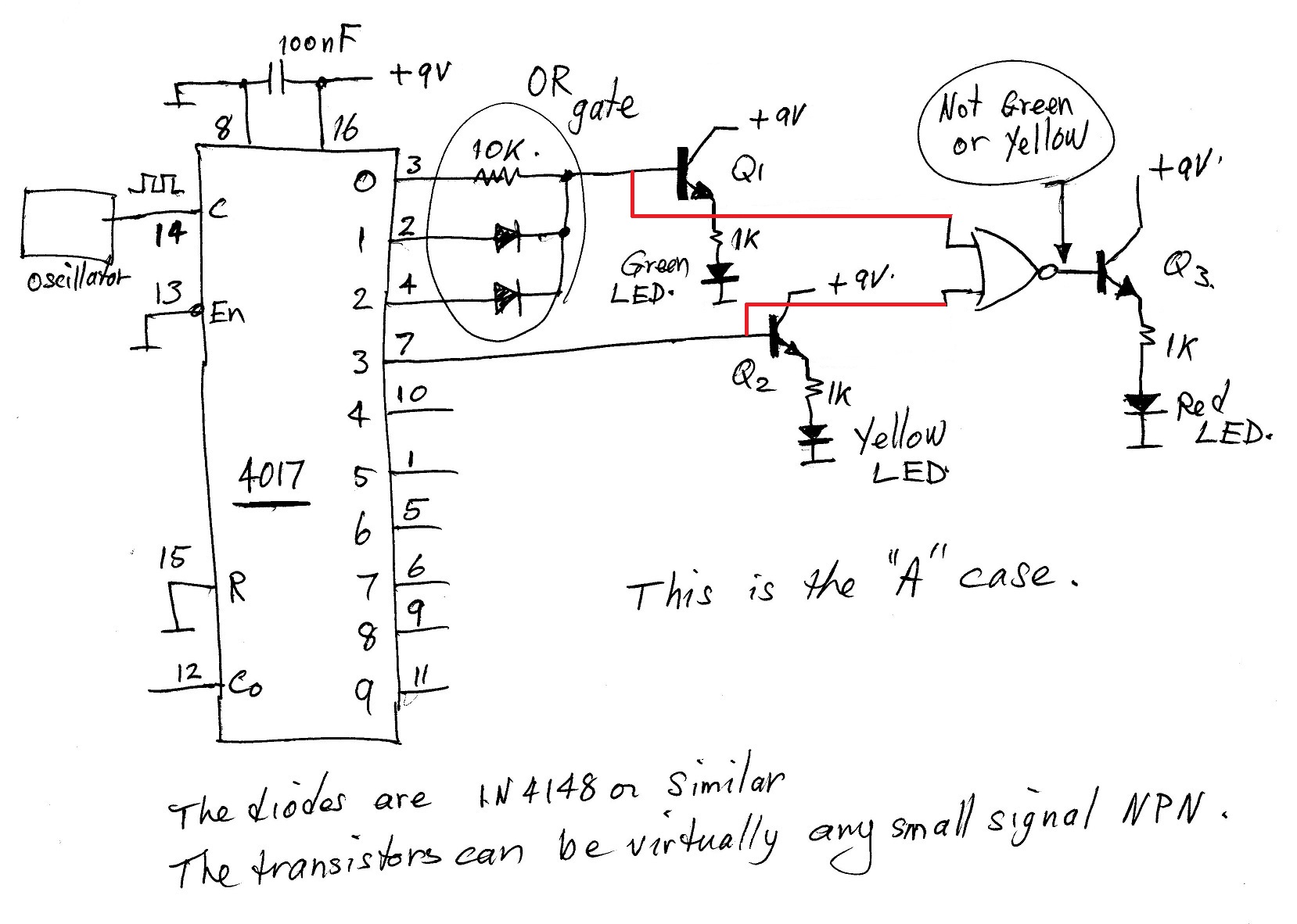

Perhaps I'm missing something, but as far as I can see, you have 9 LEDs therefore you need 9 BJT to drive them.
If so, then you can do the logic either with OR gates or with diode gates.
BTW the 4017 counts from 0 to 9, not 1 to 10.
0 is the first digit of all numbering systems.
The 4017 may not necessarily be the best counter for this job. A binary counter may be better. See my post#22 in this thread. https://www.electro-tech-online.com/threads/led-5-blinks-and-then-a-continuous-light.123628/
Thank you for your information , it was very good and helpful . can you give me one simulation for that ?
You're welcome.
I do my designs on paper, not by simulation.
I have drawn the A case for you. See if you can do the B & C cases.
When you have done it, please post your circuit so we can advise you.
Note that I saved some components by using a NOR gate to drive the Red LED.
The logic is if the Green & Yellow LEDs are off, then the Red one needs to be ON.

man i dont understand that , why u write
0 3
1 2
2 4
in the counter , what is 3 , 2 , 4?
Did you look at the data sheet of the 4017?
0 is output 0 which is connected to pin 3 of the IC.
1 is output 1 which is connected to pin 2, etc.
See page 2 of the attachment.
