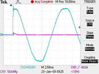

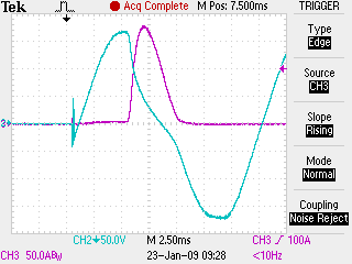

The earlier scope captures I posted don't show unequivocally when the grid voltage was applied to the primary of the toroidal transformer. I've captured a couple more, with the green trace showing the voltage across the primary, instead of the unswitched grid voltage.
I've left the secondary rectifier+caps connected.
Tcur3 shows the current in the primary when the grid voltage is applied at the peak of the sine wave. There's a small current surge of maybe 10 amps due to the charging of the caps, but there is no large surge due to saturation of the transformer.
Tcur4 shows the current in the primary when the grid voltage is applied at the zero crossing (actually, just slightly before) of the sine wave. You can see the nearly 180 amp surge which doesn't even begin until 5 mS after the voltage is first applied. This surge current is so large that it distorts the voltage applied to the primary by causing a substantial voltage drop in the wiring resistance. The DC resistance of the primary in this particular toroidal transformer is about .5 ohms; that, plus the resistance of the house wiring, etc., is what limits the current to 180 amps.
