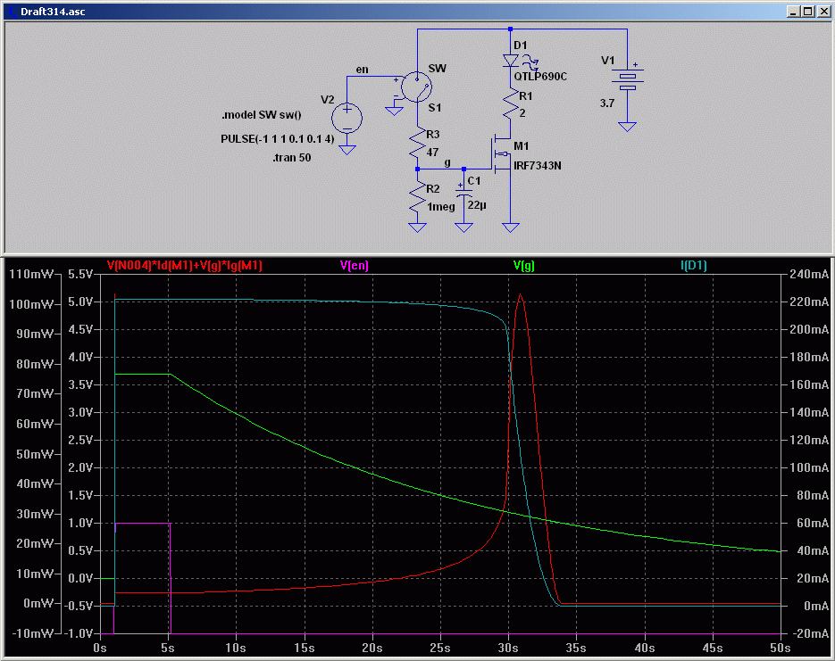

A noise/vibration/motion sensor amplifier should trigger the gate of a mosfet to turn on a lamp, and stay on for about a minute after the sensor detects nothing. Sort of a VOX
If the gate-to-source has a selected capacitor in parallel plus a bleed/pull down resistor; would the mosfet turn off after some time if there is no more triggering from the sensor ?

Yes, but the turn-off time would be dependent on the Vgs threshold and hence on the particular FET. If accuracy/stability is not too important then that would work.
If the gate voltage changes very slowly on the MOSFET, the lamp could take a long time turn on and off, which would result in a lot more heating of the MOSFET than if the transition were faster.
You might need to have one MOSFET for timing, and then some Schmitt trigger to turn the power MOSFET on and off quickly.

Here is the story about dissipation in the NFET: (Not enough to even need a heatsink).
  • Draft314.asc
