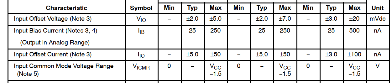

The LM339 common mode range is up to (positive supply - 1.5V) so you cannot use the same voltage at the inputs as for the supply.

When you say I cannot use the same voltage at the inputs as for the supply you mean the maximum voltage that goes into the non-inverting input of any LM339 must be at least 1.5V lower than the positive supply voltage? Or I need a seperate voltage source (like a voltage reference)? Or both?
There is a spec that is called common mode range for inputs, and it insures
inputs always function properly if that is met. If not in spec input can produce
unpredictable output.
5. Positive excursions of input voltage may exceed the power supply level. As long as one input voltage remains within the common mode range the comparator will provide a proper output state. Refer to the Maximum Ratings table for safe operating area.
No you dont need another power supply, its just the range of V that can be put on input pins,
+ and - input pins (not power pins), to maintain functionality.

This tip with lowering the voltage on the input pins has given me the biggest advance in weeks! I went from 160% off target to 20% and I just need to be withing 10% for the pitch to sound correct. What else can I do to improve the accuracy of this circuit? The problem is still the same. As more of the 83.3mV get added together more voltage comes from somewhere. It's much less now but still needs to be lower. Are there better components I can get? Someone on reddit mentioned tl074s are from the 70s and outdated. I switched to TL051 but I don't know if those are any better for my application. Are the switches and comparators I'm using decent? I don't know if the bug is due to type of components, circuit design or both.
The input offset V is 5 mV, an offset to each R divider tap V, so real
issue is divider accuracy. The divider absolute errors compound as you get
to max values at top of divider.
