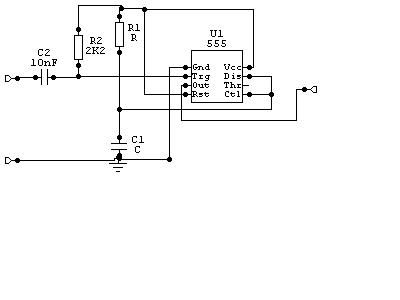

I need a simple way to build a circuit that would receive an input pulse and output a pulse after a period of time. A better way to describe it is like the lights on a cell phone, when you press a key the keypad lights up and after a period of inactivity the lights go off. Thanks for any help.

what you need is a 555 timer ic operated in the monostable mode, or if not you can also use small signal transistors.
with a little patience try browsing thru this forum and you can find the circuit diagram of both suggestions.

As Mozikluv suggested 555 could be connected as a monostable pulse generator as shown in my schematic. Here the monostable timing period is initiated by a falling edge (i.e.a high to low transition) applied to the trigger input (pin 2). When such an edge is received and the trigger input voltage falls to below 1/3 of the supply voltage, the 555 output (pin 3) goes high and the monostable pulse is generated for a period determined by the time constant C X R. The amplitide of the pulse will be approximately equal to the supply voltage. The period for which the out put is high is = 1.1 RC. Hope you understand
