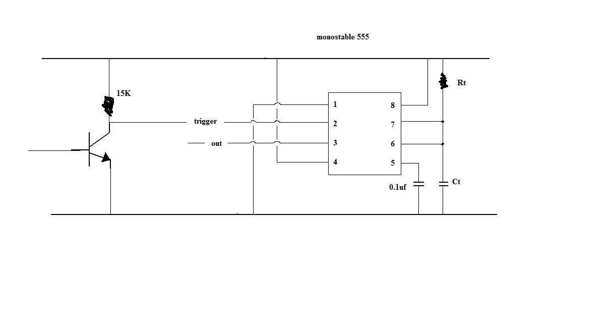

If you want a timer that gives low output until it recieves a pulse then it goes high for 7-8 seconds then you can use a 555.
You need to use it as a monostable. Pin 2 of the 555 is the trigger, when it goes low, the output (pin 3) goes high for a time determined by 1.1RtCt (time in seconds) then stays output low until another trigger pulse.
As you want a positive pulse to trigger the 555 i've used a transistor to convert a high pulse in, to a low pulse for pin 2.
I'm quite new, i'm sure theres a better way to do this but i think this wil work!
if you want to interupt the output high before the 7-8 seconds you would need to take pin 4 low

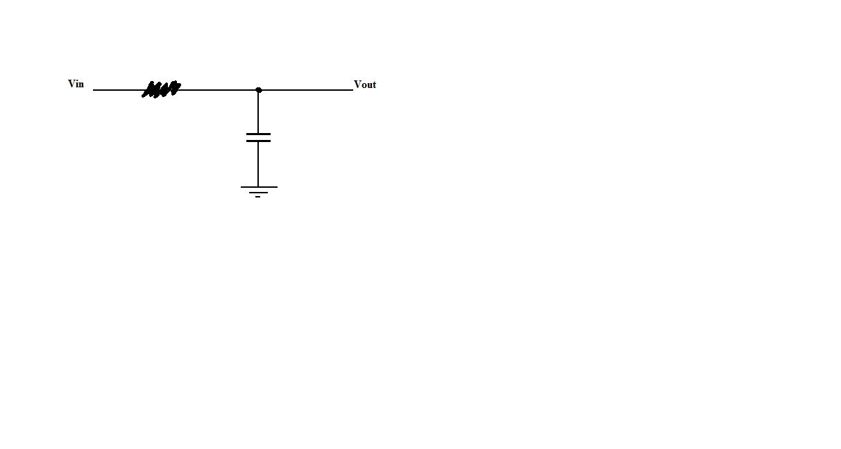

If all you need is to reach a certain voltage after 7-8 seconds (enough to trigger 'high' input you can use a simple resistor and capacitor. The voltage out will continue to rise from 0V when power is first supplied until it reaches Vsupply. (63% of Vsupply after RC)
What are you using this for?

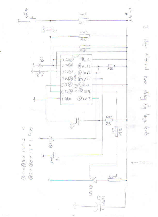

Dude, what about this, it is a two stage 555 timer. basically you push a trigger the out put will delay for a set amount of time the it will go high for a set amount of time?
On my diagram it is driving the gate of an SCR, just ignore it.
It use an 556 chip which is just 2 555 together.
Here is the circuit diagram Sorry about my messy handwriting if you can read it, just tell me then i'll explain.
Chingyg, thanks, but I'm affraid it not what I need. I need it to delay about 7 sec. from the time voltage is supplied to it without any intervention (no pushbuttom, switch or anything). then stay "high" or "on" not for a given period of time, but as long as the supply voltage is on.

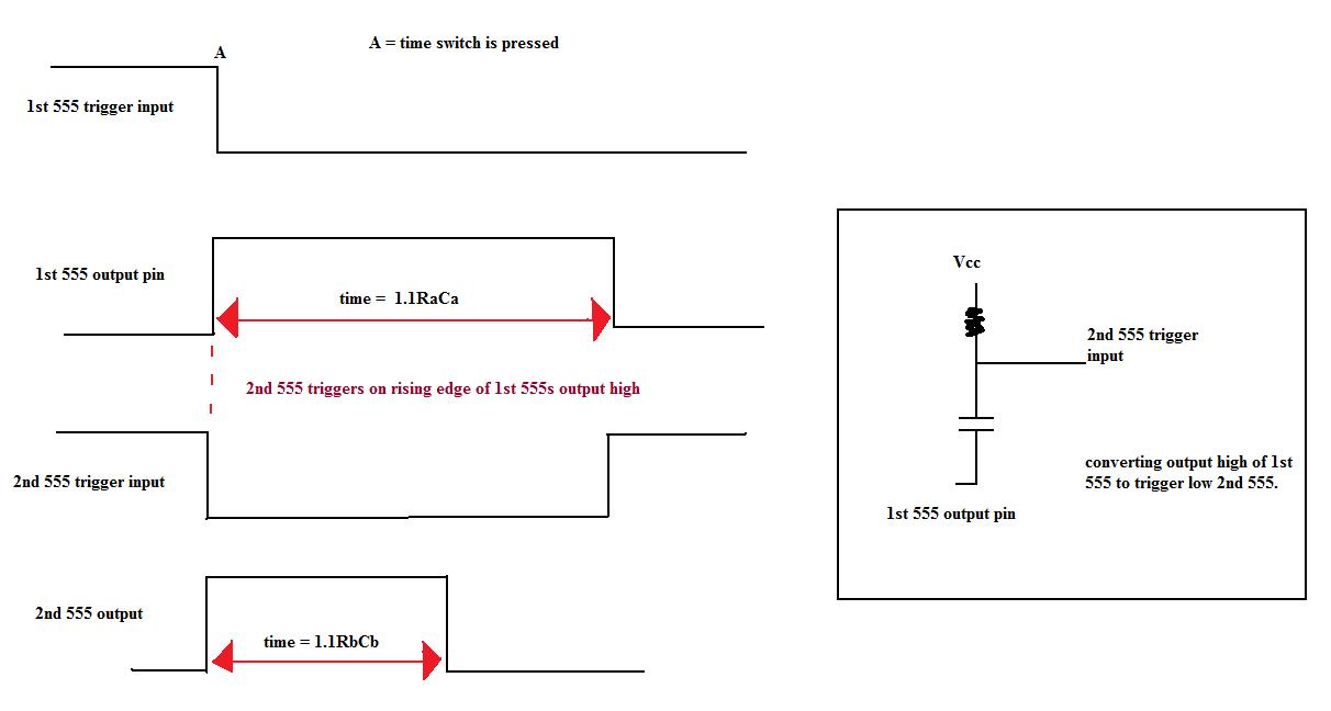

hi chingyg, how does your circuit stop the rising edge of the 1st 555 timing pulse out from triggering the 2nd 555s trigger input?
I've added a sketch to show what i mean.
Could anyone tell me why it doesnt trigger on that rising edge?

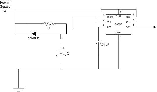

See attached circuit using a 555.
Simply speaking, the time delay is determined by multiplying R and C, which is called one RC time constant. In one RC time constant, the voltage across the capacitor (C) is 2/3rds the supply voltage, as it charges up through R. There is a flip-flop inside the 555 designed to be set when a pair of comparators, also inside, detect that the voltage at the joined inputs (Thresh and Trigger) is above 2/3rds the supply voltage, and reset when below 1/3rd the supply voltage. The output of the 555 is low when the voltage across C is higher than 2/3rds the supply voltage (flip-flop is set), and high when the voltage across C is lower than 1/3rd the supply voltage (flip-flop is reset).
The diode is there to discharge C quickly as the supply voltage drops (when you turn off the power supply), by bypassing R. The 0.01 uF capacitor acts to supress any external noise on the otherwise floating, unused CV input (though, internally, CV is not really floating). The RESET input is held high to prevent false resetting of the internal flip-flop from an otherwise floating input.
I know what you mean, I just used a switch of the second 555 output, triger, wait then switch on.
