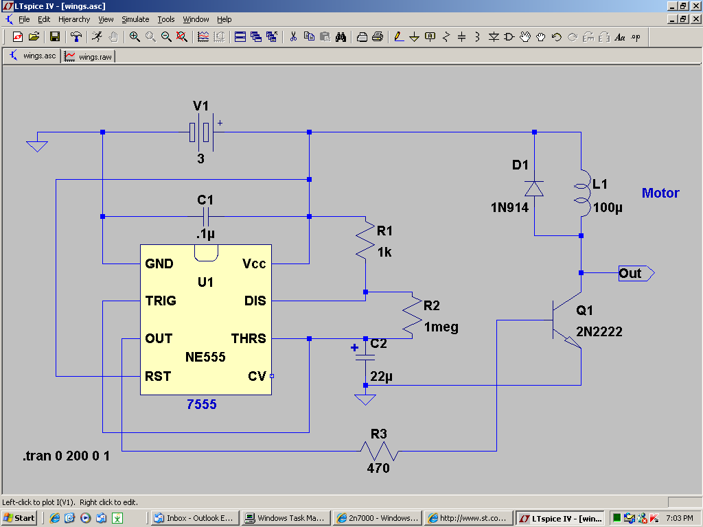

Jason,
Attached is a schematic that should work for you. It occurs to me that you may want to run several birds off of one or 2 circuits. If that's so let me know and we can beef it up a bit.

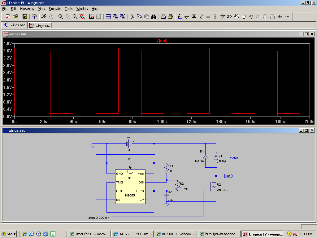

Real world....Vgs(th) for the 2n7002 is between 1V and 2.5V for an Id of only 250uA. And that's just the threshold, not the saturation Vgs. The Vds(on) can be as as high as 3V. I think you would better off driving an NPN transistor, with only a 3V supply.
Ken
Wings II
Ken is right. The fet is marginal at this voltage. Here is an update with the transistor. Uses a little more current, but with the 2 batteries you have plenty i think. Two other things: Get the CMOS version of the 555 if you can. It uses a lot less current If you go to someplace like radio shack they will have both types. Also note the polarity of the 22 ufd. capacitor.

Okay I got all the parts, except I couldn't get the CMOS as every store in the KC area is out of them and they couldn't tell me when the could get more. So i got the regular 555. I couldn't find the original transistor you recommended so I grabbed another that I thought might work. So I put it all together and all I got was a continuous running motor. I was a little confused as to which pin on the transistor went where, so I tried it in all the different positions. I tore it all apart and tried again but still no luck. So I thought maybe I would try a simpler circuit just to see if I was doing anything right at all. I tried the first astable circuit listed here **broken link removed** . I just used the parts I had and I got it to kick the motor on for about 15 secs, then off 15 secs. Is there any reason that this circuit won't work in the long run? I think I can live with the results of that unless you guys see something that will cause a problem in the future. Its a little cheaper too since I want to build a load of them.
Wings III
Here is an updated schematic with pin numbers etc. Switched back to the FET to save power. If you send me your e-mail I'll send you a link to the parts with price and data sheets. There is about a dollars worth of parts excluding the batteries.
