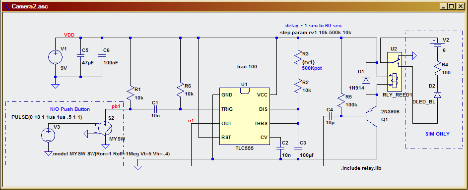

I have mounted a micro switch to a device that, when activated, fires a digital camera. The camera is pre-focused, so all that is needed is to close the contacts in the camera, and fire the shutter. The problem is that the camera fires before the device has done its bit, and there is no way of speeding this action up. What I need is a timer switch that delays the firing of the shutter once the micro switch has been activated. I am looking for a variable delay between 0 seconds to say, 2 minutes, though the important timing is in the 0 - 10 seconds range.

A simple way would be to use a 555 timer IC.
Fitted with a variable resistor you could vary the delay time to suit, if you attached a simple home made dial to the variable could 'calibrate' the timer.
Push a button to start the delay and at the end of the delay it operates a relay,

This is an option.
This will give a variable time delay of 1 sec thru to approx 60 secs.
