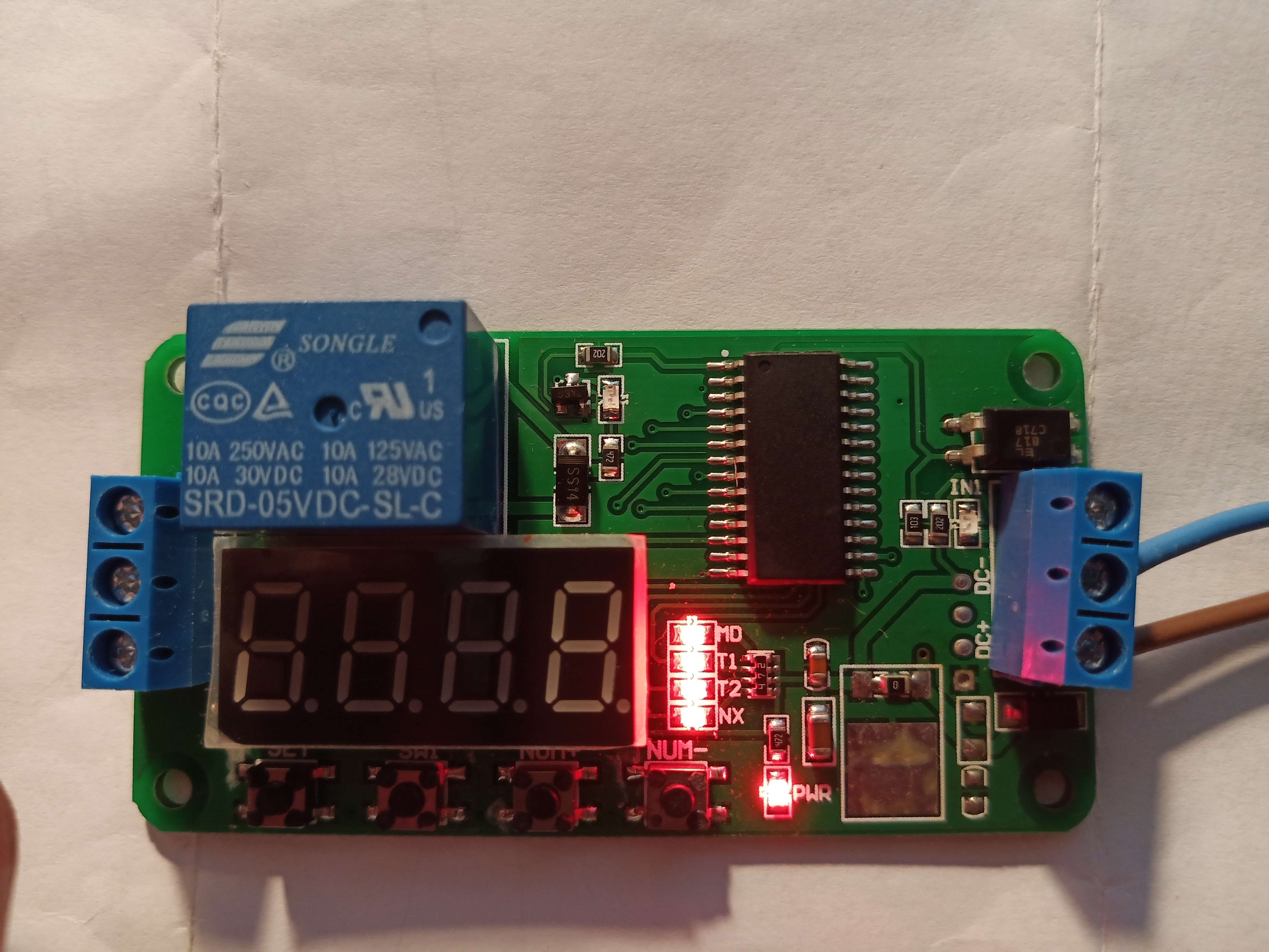

Hello, sorry I'm a Newbie and i've got a problem.
I bought a time relay CE030 and connected it. My problem is that the display remains dark, all LEDs light up red (MD T1 T2 NX) and Power LED. How can I switch on the display so that I can set the individual parameters.
I pressed SET, SW1 and NUM + and NUM- short and long, to no avail, either I'm doing something wrong, or the part is defective, which I believe less. I would be grateful if I get an answer. thank you

Can you post a picture of how your unit is wired please ?

ohne Worte .. without a Word
as you see the LEDs are burning (all of them) but not the Display. It would help me if you would read what a wrote above :
"I pressed SET, SW1 and NUM + and NUM- short and long, to no avail, either I'm doing something wrong, or the part is defective, which I believe less."

Those are setting actions, that is, they are used to set the parameters for the timer. They have no bearing for switching the actual device on or off.
If there is correct power applied to the device the display should illuminate/
What voltage are you applying to the terminals DC+ & DC- ?? 12vdc ?

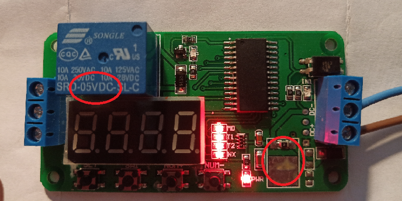

The device you have is designed for 5vdc input NOT 12vdc .. .. .. Look .. ..
The 12vdc version has an additional Voltage Regulator sited in the red circle, and the relay coil is rated for 12vdc not 5vdc as seen in the ellipse.
If 12vdc has been applied it may well have fried something on the board in which case the device is indeed now faulty. Some of them have over-voltage protection so you could try reducing the input to 5vdc - you may get away with it - but don't hold your breath.
