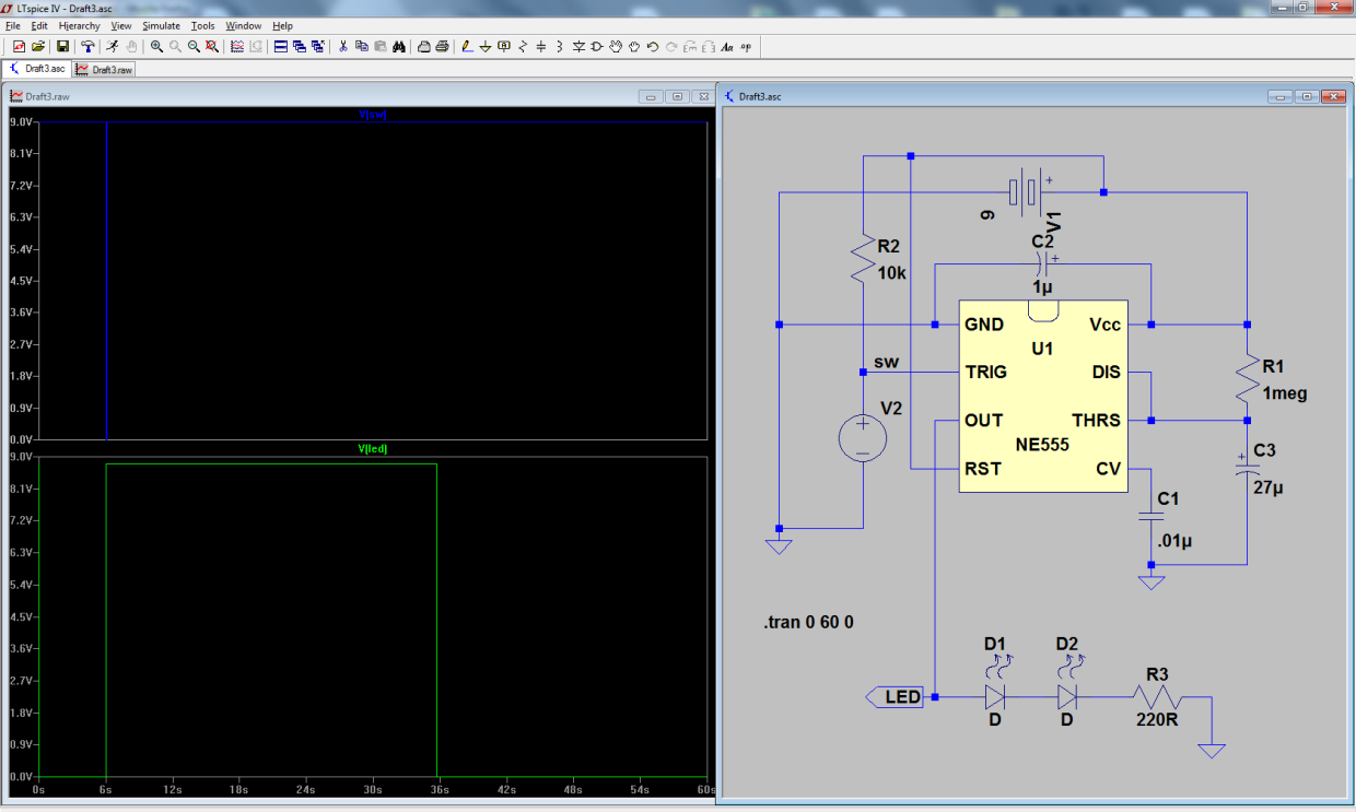

Hello,
I am building a toy wooden truck and would like to build a circuit that would allow my child to press a button and have headlights (LED's) turn on, and then turn off automatically after about 30 seconds. I can't even seem to work out what type of circuit this is called. If someone knows of one or could design one for me I would really appreciate it.
Thanks so much,
John
High Beams
John,
Here is a circuit that should do it. You should be able to get all the parts at Radio Shack. Keep in touch if you have any questions.

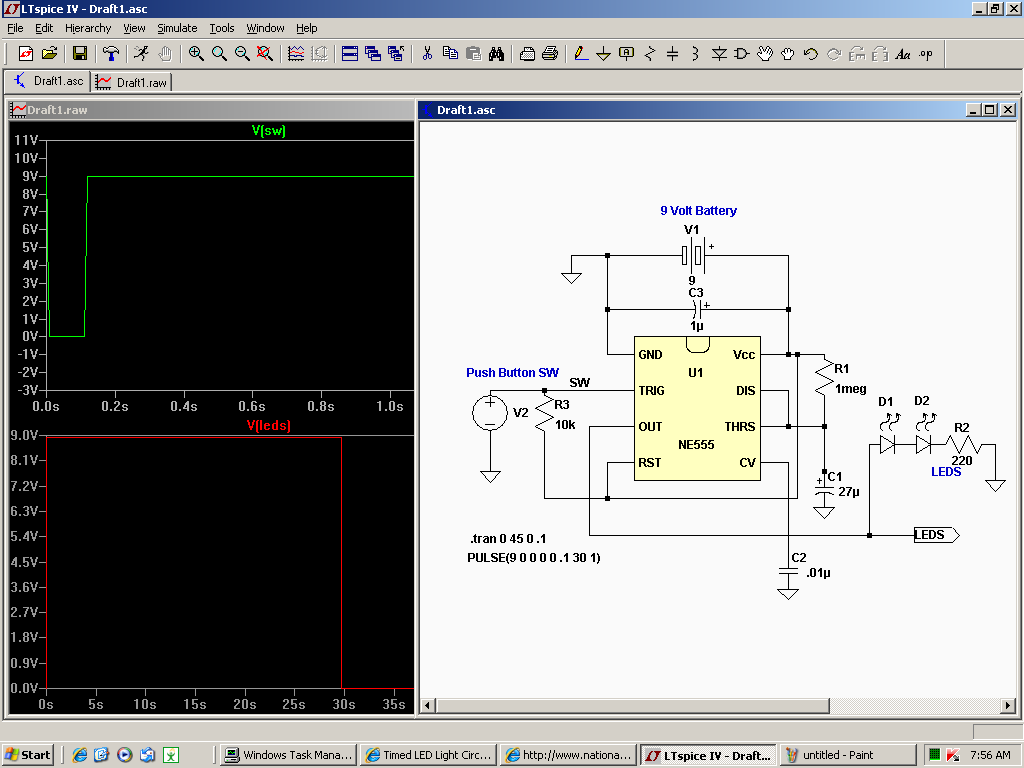

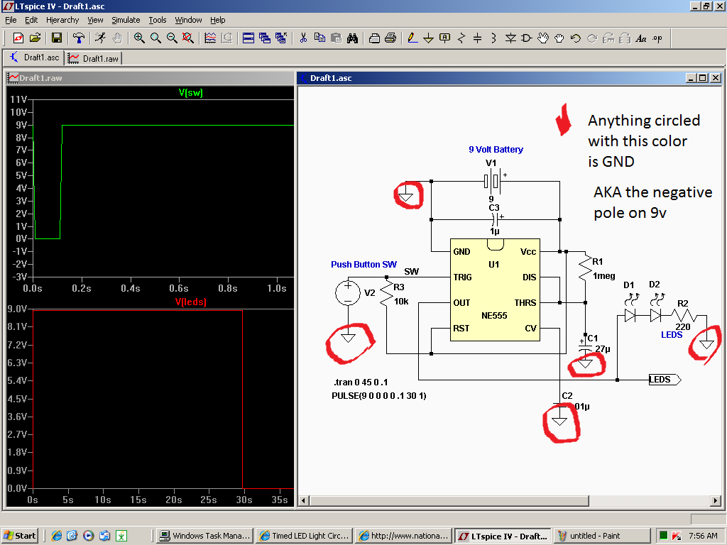

Thanks guys! RonV, I'm sorry for my ignorance but a question about the triangles in your diagram that come off from the capacitors, push button switch and LED's. Do these just represent joining those parts back to the negitive of the 9V? I see that D1 and D2 are the LED's, so what does the symbol of the rectangle with a triangle end enclosing "LEDS" mean? Where would this join up to?
Once again, thanks so much,
John
Thanks AtomSoft, so I did have it right. Do you happen to know what the "LEDS" box in the right hand bottom corner is for? It looks to me as though D1 an D2 are the LED's. So I'm not sure what to do with this.
Thanks,
John
Thanks,
John
That is just the way that RonV labeled the electrical node which is connected to pin 3 of the 555 and the Leds. Think of the "dog-house-laying-on-its-side" as an electrical terminal. It has the name "LEDS". It is used to reference an electrical node so that it can be plotted in the plot-pane. Look at the red trace "V(leds)". Note that one end of the switch is named "SW", but without the dog-house. It is also plotted as the green trace, v(sw).

It would be simpler to say:
Thats just a label. Its there to show you the name of the wire and what its for.. for example if you have more than 2 leds in series you connect the rest of them to that line(wire)... (and for simulator purpose)
English is not my native language, heh!

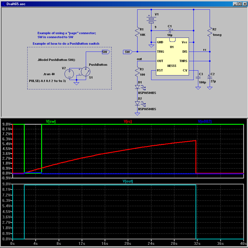

There are two independent things here; one is "naming an electrical node (wire)", the other is adding a "port" (pin, terminal). You can do one without the other.
Here are several tricks: Note the use of a real switch (instead of a voltage source). Note the use of a Page connector (node SW). Note that the traces are much more readable when posted here.
Note that the plot shows "n002" (dark blue). Which node is n002?
