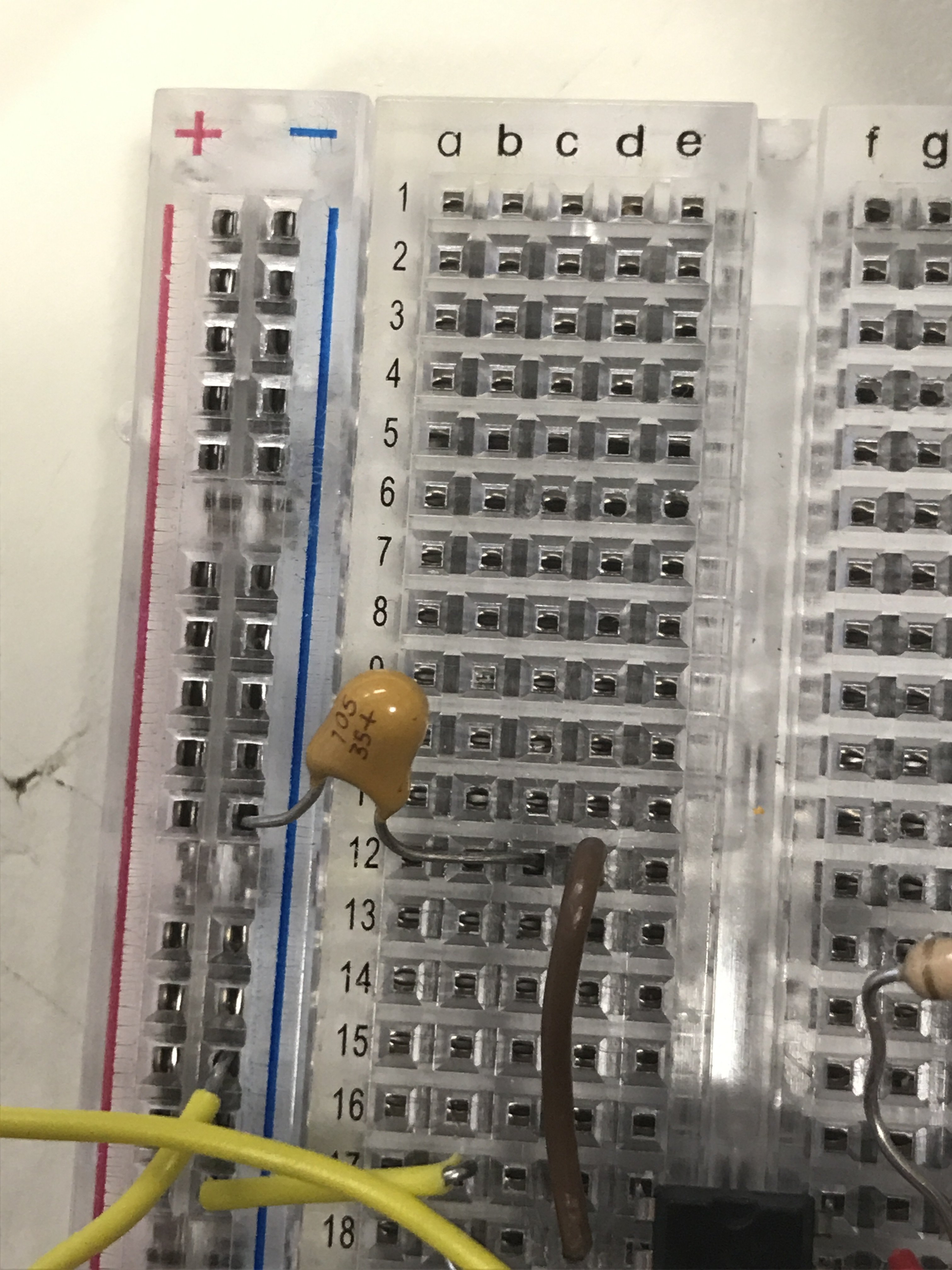

The 10 nano Tantalum, (0.01 uF) - lead is in the positive rails connection point and the Tantalum + lead is at pin 2 of the 555 timer. The pellet can fuse into a short when the part is powered with reverse polarity. If the pellet is fused internally that can make the trigger function act un predictable when operating in connection with the timer.
Sorry if my picture werent clear before. It was actually in the negative rail. The negative lead in the negative rail and the positive lead was beside the wire connecting to Pin 2.

A 105 is a 1uF value, for an logic input that's quite a load to alter for the trigger alone, or even for a pull up resistor of the 10k range. That 1 uF KEMET looking part Tantalum part will cause variouse issues on pin 2.

Oh im not sure about that but based on another person that replied to my chat too. i was told to put that capacitor there.

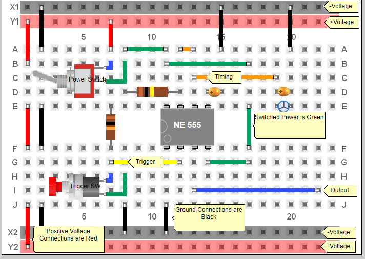

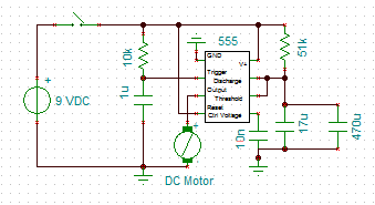

This is the OP's current circuit, as per his stated needs. Component values are as per what we can see in his pictures and what he states.
As you can see, it is a self-triggering monostable timer. The OP has had many inexplicable problems that seem to never end...

The circuit as drawn, by cowboybob, will always be a retriggerable monostable flip flop. I used a similar circuit. different chips, with a lightning detector to produce one alarm (edit) not matter how many lightnight strikes were detected. So if the alarm was active for 10 minutes, it meant there were numerous lightning strikes from the first to about 8 minutes ago. (end edit)
I've used one exactly like Bob's to extend the time an attenuator was active to reduce cross rate interference. The interval was 8900 uS and I extended it out to almost 18 mS.

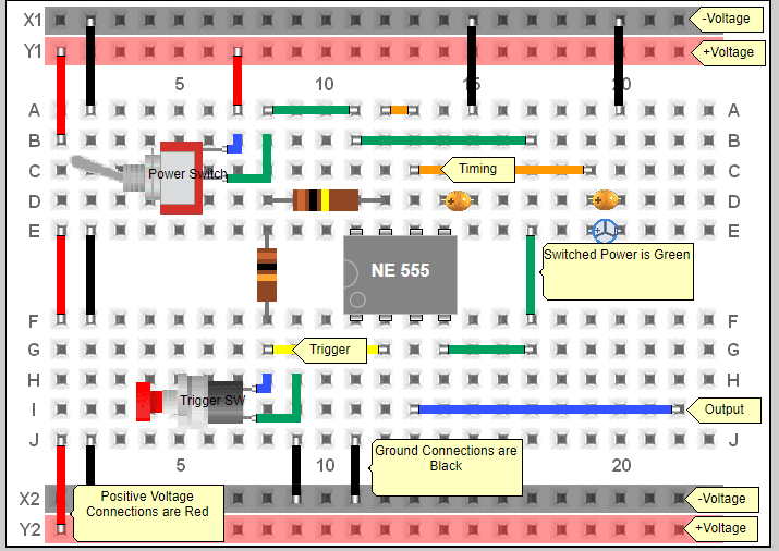

Here is the breadboard circuitry using Pebble. I did not put the values in for the capacitors.
Sadly, the above picture had an error. Below is the corrected picture.

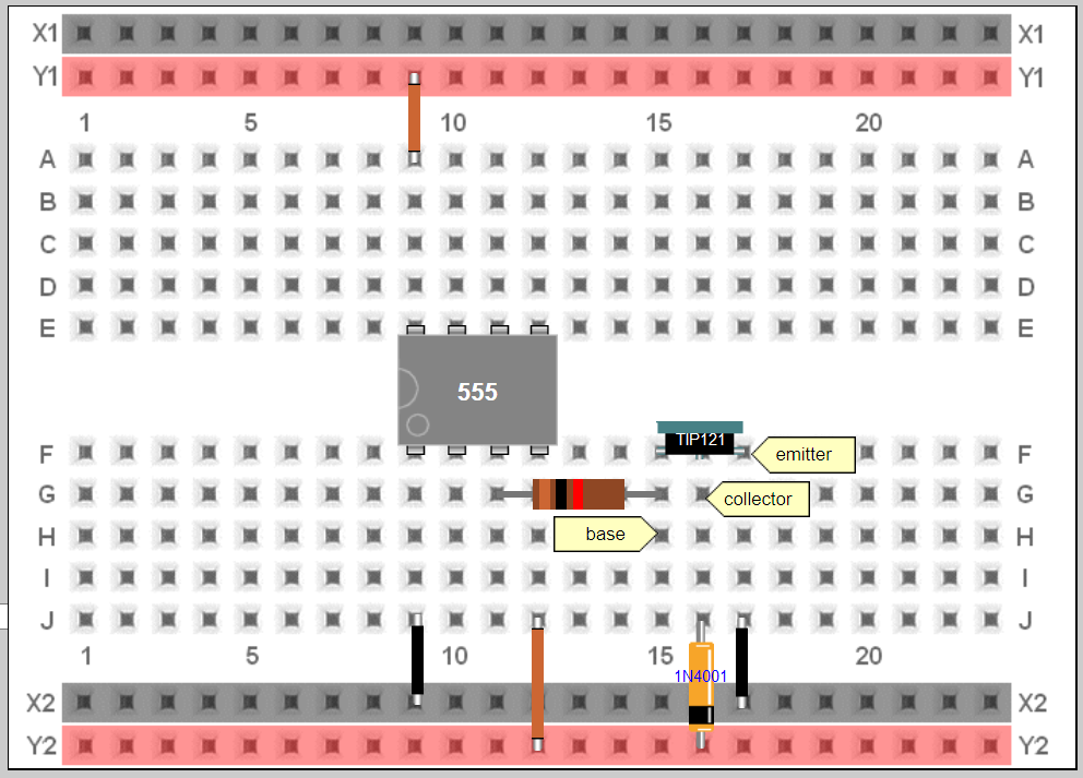

I think the reason why my circuits keep stopping at such short timing is because of the 555IC getting slightly hot. is there any reason or ways in why my 555IC is like that? i changed the 555 too
Or sometimes if it runs for a longer time the 555IC gets really hot.
If your motor draws more than 200mA, then driving it directly from the 555 will overload the 555 and cause it to get hot and/or become damaged.
Then what should i do to reduce its current? or any way to help cool the IC down while running?
Mind showing me how can i make use of a Transistor to reduce its current? like how do i connect my motor/IC and transistor on the Breadboard . Thank you!
Here's one way you could do it :
I have not shown all the connections to the 555; just how the output pin 3 drives a transistor.
The transistor can be, for example, a TIP120 or TIP121
The resistor value can be in the 1k to 5k range.
The diode can be, for example, a 1N400x, where x is in the range 1 to 7.
The motor connects to the collector (column 16) and the +ve rail (Y2).
N.B. This layout is shown for simplicity but is not ideal, because motor current is passing through the breadboard connectors (which are intended for low currents only).
