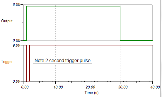

This is how your original monostable 555 timer's graph should look using a momentary push button to initiate the 29 second output:
Note the "Trigger" pulse is short (2 seconds). It could be much shorter (milliseconds) and the output timing would remain the same.

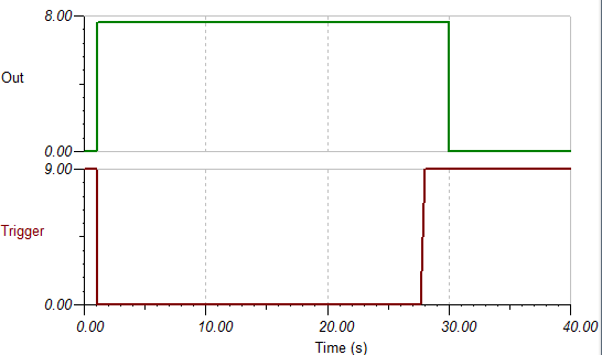

It could also be much longer:
And the output is still 29 seconds.

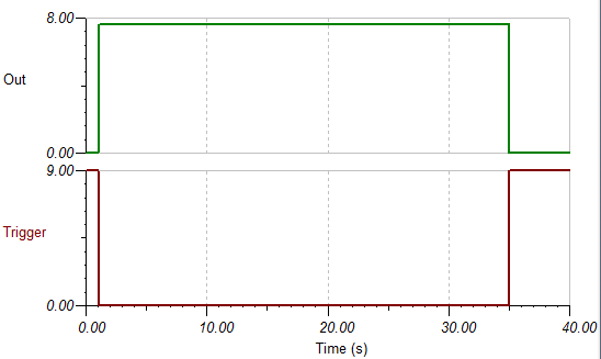

But if the trigger exceeds the 29 second delay dictated by the caps/resistor circuit (47uF + 470uF + 51k resistor), then this happens to the output duration:
In other words, if the trigger pulse duration is greater than the timer's delay circuit duration, the output duration will equal the trigger duration.

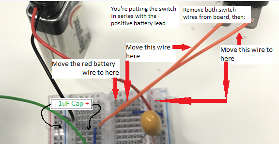

The new circuit will achieve that end with this change to the switch (that you are currently using) wiring arrangement:
This change to the new circuit will give you, when you turn the switch ON, a fixed trigger duration, a consistent output duration and the option to stop the output pulse at any time by simply turning the timer OFF.

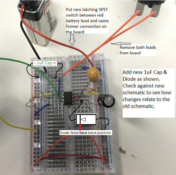

Does this means i can circuit my board without the use of the Diode? or does the diode have to be part of the circuit. What effects will it bring to my circuit whether having the diode or not?
Also for the 1uf capacitor that i had to include do i use the 35V or 50V ?

Yes, the diode is necessary. Here's why. In those events where you turn off the timer BEFORE it has timed out, there is a good chance that the 47 and 470uF caps might retain a portion of the electrical charge that they acquire during the course of the timing event. That means that if you were to immediately turn the circuit back ON (after having prematurely stopped the timer by turning it OFF) , the new timing event might be incorrect since the caps might not start their charging sequence at zero volts. The diode is there to "bleed off" any leftover DC charge on the caps (it does it very quickly).
I should add that if you allow the circuit to "time out" normally (no premature OFF), the 555 internal circuit will immediately "ground" (basically short out) the caps, returning their charge to zero volts and ready for the next trigger to start fully timed output duration
You can try it without the diode, but I think you'll occasionally see inaccurate output timing without it.
Since your circuit operates at 9VDC, a 35VDC cap is fine.

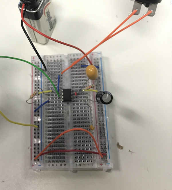

I just tried the circuit and yes finally the switch works now! It stops whenever i off it.! Thank you so much!
However, the time delay doesnt work it doesnt stop unless i off the switch. Well i did not try it with the diode yet but since the diode is meant for accuracy , the motor should at least stop i tested it for like 1min+ it still didnt stop . I wonder why though

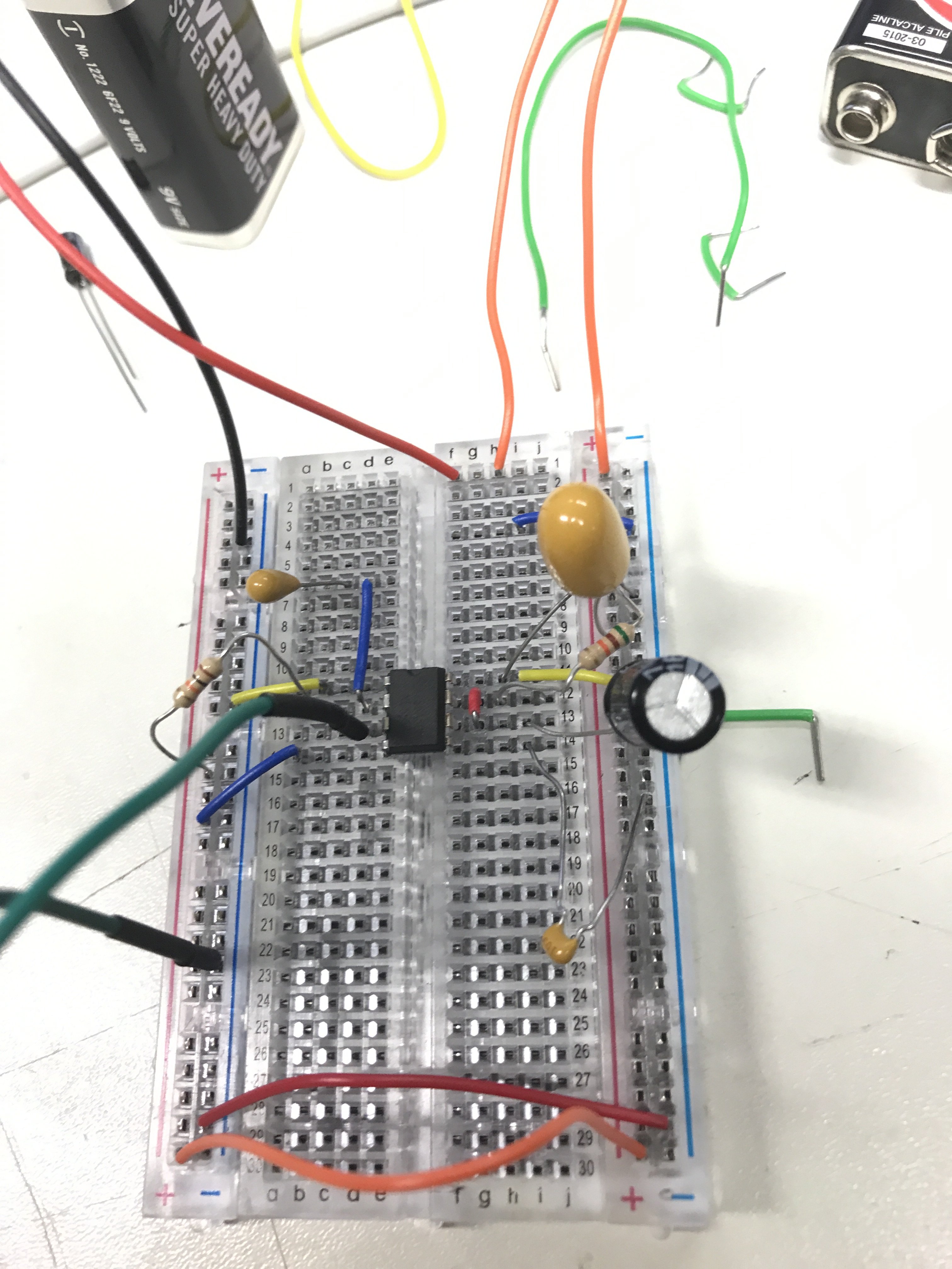

This is currently how my circuit looks like without the Diode. which i will try to get it ASAP. Is there any like parts should be connected to so that the timer will work? because for now the time delay does not work but the switch thing works already. Thank you
Now i am getting a time delay of around 19 seconds, what should i change to allow the time to be longer? like around 26seconds?
Wiring error. See below:
Move the indicated cap lead from row 14 to either row 13 or row 12 (either one will be fine).

Single Pole Single Throw switches have only two connectors.
Latching SPST switches also only have two connections, but the button itself, when pressed down (which often makes a "click" sound with each pressed) will remain in the down position (ON) until pressed again, releasing the latch (again clicking) and returning to the up or OFF position.
Note differences between old:
and NEW

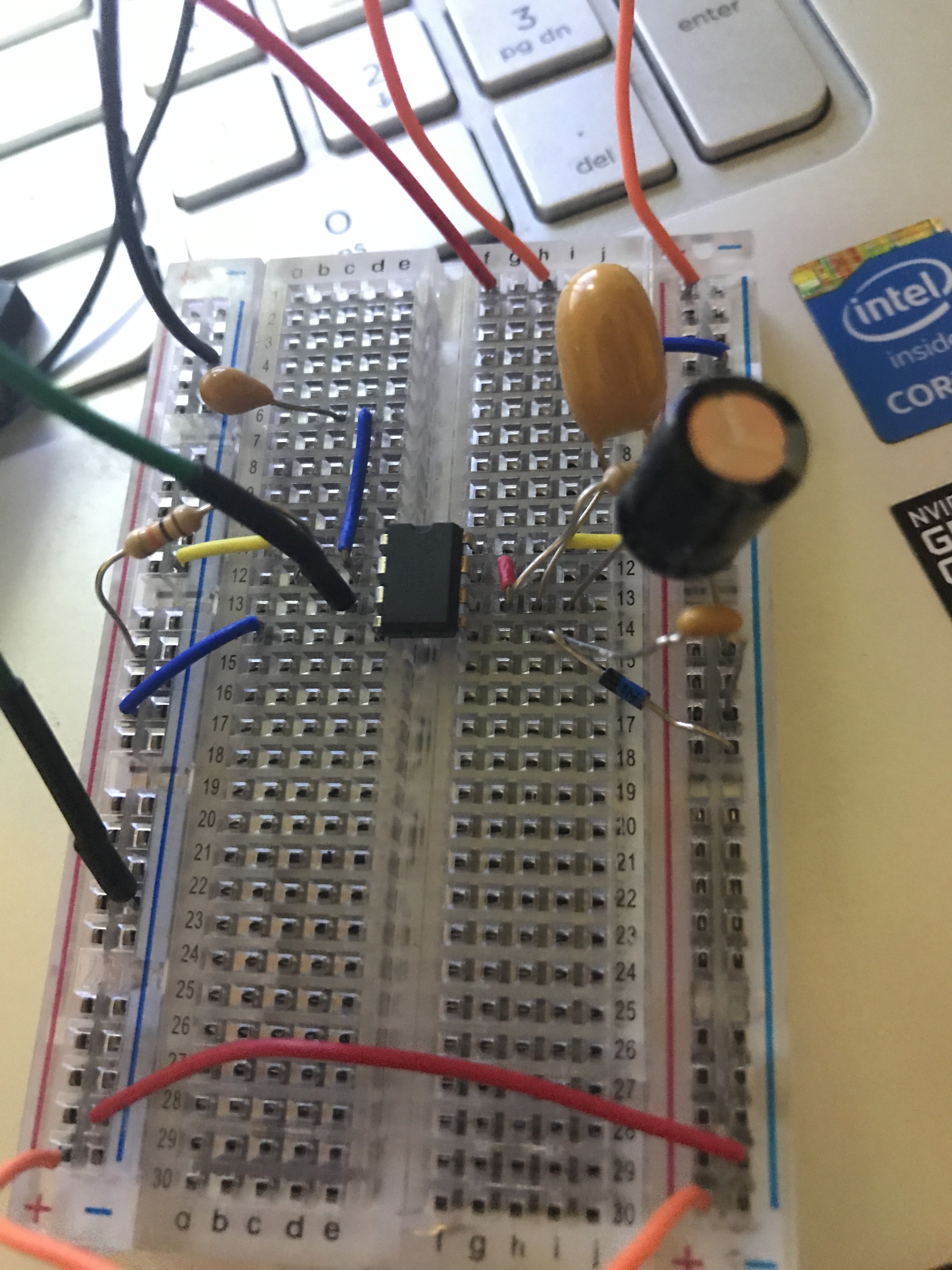

sorry but for the diode arrangement u drawn, which pin is the diode on? i cant really see clearly isit on row 13 or 14 haha thank you
help after i added the diode my whole circuit doesnt work now. even after i remove the diode. the timing doesnt work again omg!!! it doesnt stop and continues to run atw unless i off the switch
this is the circuit with the diode. the diode is quite short so i did not pin exactly how u showed on the picture but i still pin to a negative terminal so is it still correct? also im not sure whether the other side u showed is row 13 or 14 . i used row 14 as row 13 is already used up for the capacitor u showed at the top that the wiring is wrong
Forget about the diode for now. Remove it.

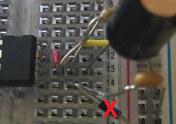

Then re-check ALL your connections to make sure they are inserted in the board correctly and that there are no shorts between leads, especially in this area of the board:
You appear to have 2 wires stuffed into 1 hole in row 13. That's a no-no.

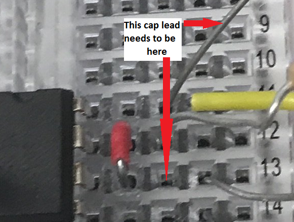

However now i moved the capacitor lead back to the original position from row 13 to row 11. it is working again. however the time out timing is around 19 secs.
but if i want to try it with the diode i dont kniw how to connect it as the diode i hve is v short and i cant connect the way like how u shown in the other picture. what should i do
there isnt any stuffed in the same hole tho
That's ok then. The photo is unclear as to what is inserted in the hole next to pin 6 of the 555.
Row 11 is "-", or ground. Moving the cap lead there shorts it and, basically, removes it from the circuit. The cap's lead needs to be in either row 12 or 13.
Also, might be time for a new battery.
And, again, forget the diode for now. You're worrying this death.
