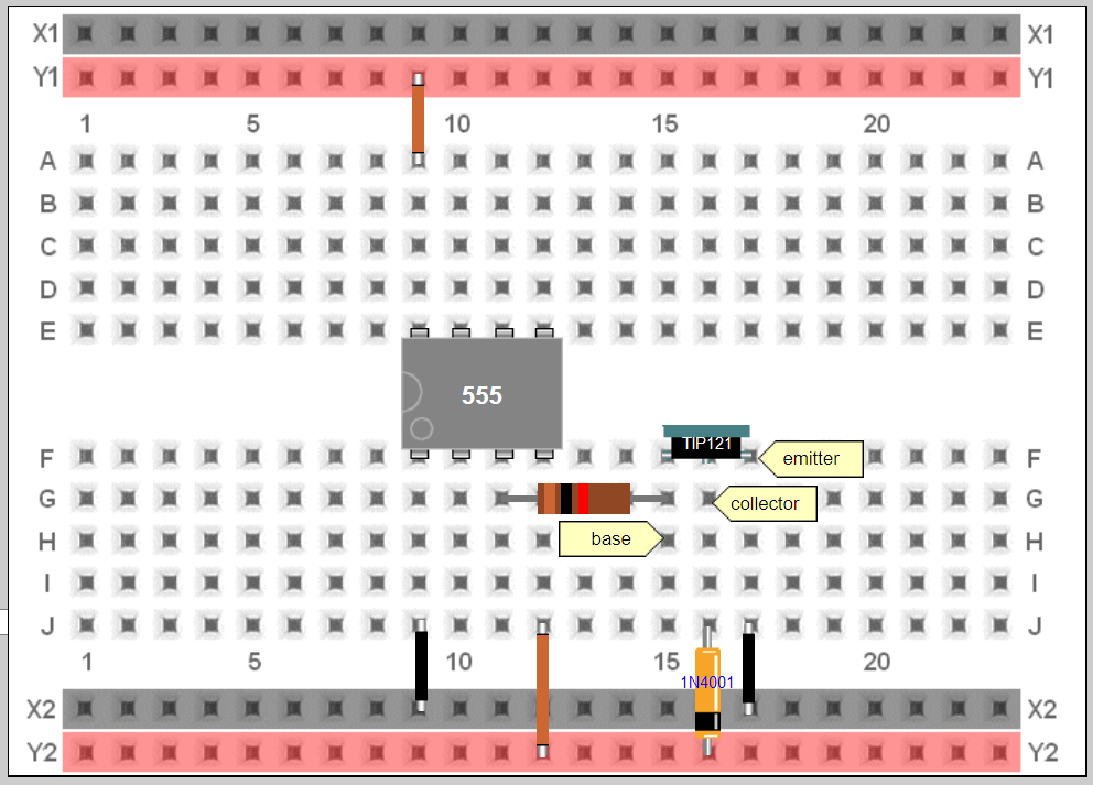

Here's one way you could do it :
I have not shown all the connections to the 555; just how the output pin 3 drives a transistor.
The transistor can be, for example, a TIP120 or TIP121
The resistor value can be in the 1k to 5k range.
The diode can be, for example, a 1N400x, where x is in the range 1 to 7.
The motor connects to the collector (column 16) and the +ve rail (Y2).
N.B. This layout is shown for simplicity but is not ideal, because motor current is passing through the breadboard connectors (which are intended for low currents only).

Neither of those has a current rating as high as your motor current, so they would get hot and fry.
Get into the habit of reading the datasheets for components you want to use in a circuit, to make sure they can handle the expected voltages and currents.

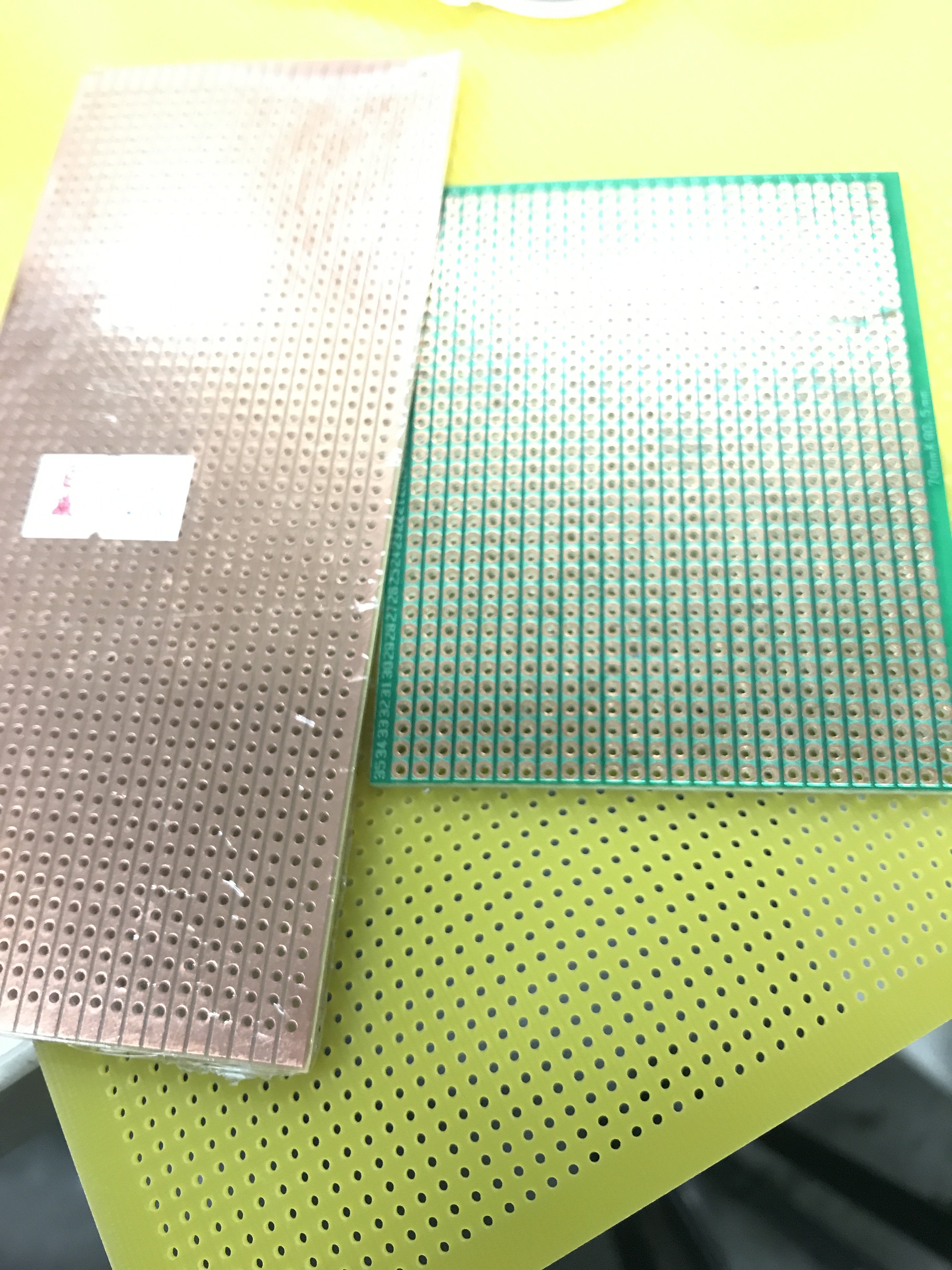

Also, my next step of my project is to convert the breadboard circuit and use it on a PCB. How do i do it on a PCB board now, i heard i cannot just copy and arrange the circuit exactly like how i see on the Breadboard, since theres no negative or positive rails.
I currently have 3 types of pcb . One has non plated holes, one has holes that are individually plated and the other pcb has holes plated row by row.

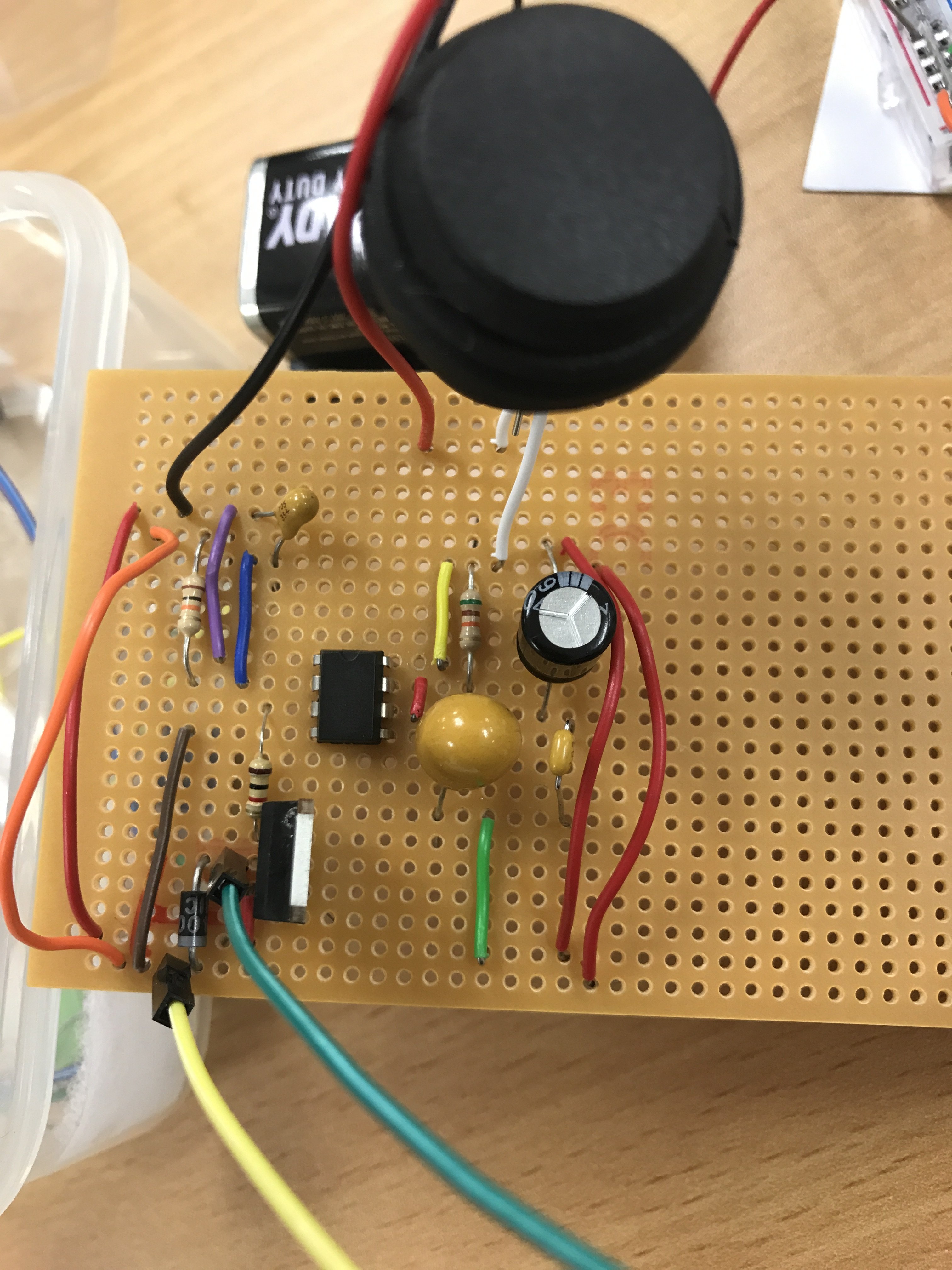

I tried connecting my circuit using the PCB that is plated row by row. and this is how my connections looks like im not sure if this is how we are supposed to connect .
The 2 wires on both sides act as the + and - rails like a breadboard. im not sure if this is how it is supposed to work like . Thank you.

The 'row-by-row' board (aka stripboard or Veroboard) is what I would have used.
Do the copper strips of the board in your pic go from top to bottom or from left to right? Whatever, did you remove copper from between the pins of the 555, and elsewhere where needed, to prevent shorting the wrong bits?

Its going from left to right. I do know that i have to "cut" the copper between the 555. however i dont know where else to remove. but based on the pic i sent and to my breadboard is this how the connection should be like?
From the pic it seems you haven't done the soldering yet? I haven't spotted any obvious mis-wiring.
Yup i havent solder it yet. I wanna make sure i have arranged it properly before soldering. Is my arrangement that i had done the same as my breadboard?
So does this means i can proceed on with the soldering?

Show the picture of the component side and the other side of the PCB. Show the picture of the schematic you are currently using.
Make a list of every point you tested and write what you measured.
Do NOT disassemble it. If you do the pictures become worthless.
