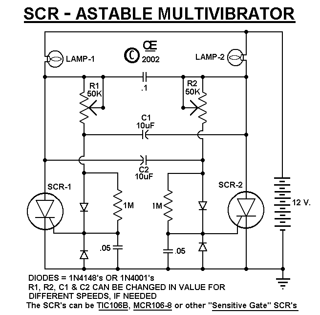

Never Tried this on a Transformer, But this Might Work.
Transformer enter tap to the 12 Volts, one winding to SCR-1 and the other to SCR-2
This Assumes it can operate at 50 or 60Hz.
Also it would require some Transient Protection.
