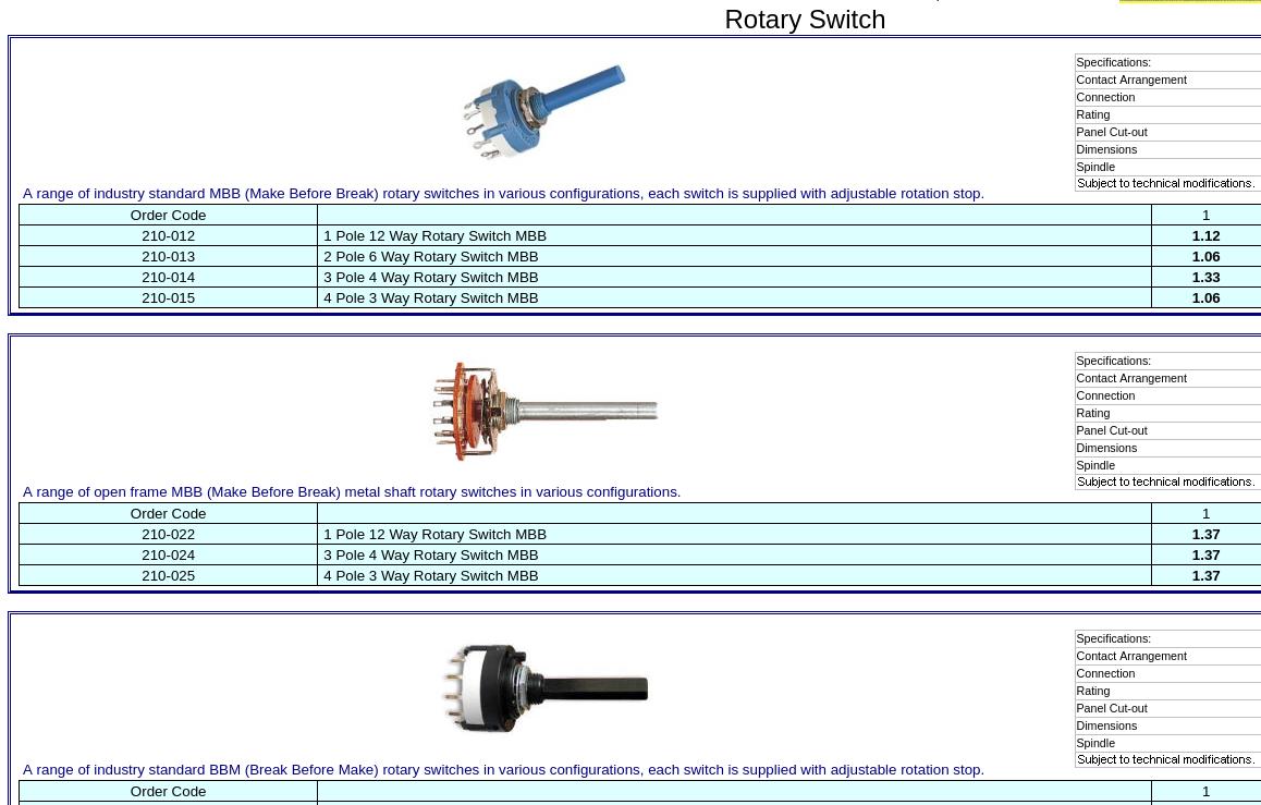

Does anyone know of a rotary style switch that has 6 positions, has fixed positions and sprung (or momentary) positions???
The positions OFF, Run Up, HOLD & Run Down are fixed. The positions Notch Up / Notch Down are sprung and when selected will return to the HOLD position...
Or, does anyone know of a way of creating such a switch??? Dunno if I've made any sense but hopefully someone may know what I'm on about...!!!

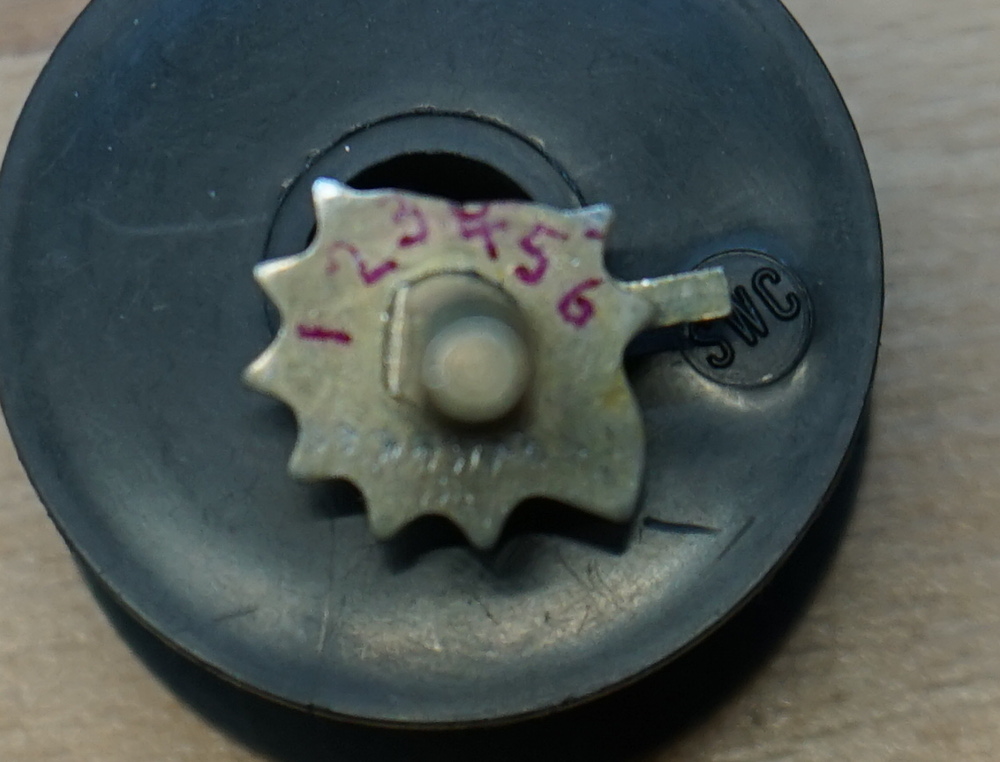

It could be done using a built-up detent system, so a hidden arm with a sprung roller and a "sawtooth" style detent with some teeth replaced by ramps, to give spring return if the handle was not moved all the way to the next notch.
The electrical switch could be a wafer style with no detent, or have a magnet on the arm operating magnetic reed switches as it moved.

I cannot find any pictures much like the mechanism I was thinking of; this is the nearest:
Imagine the "teeth" spread out on a larger diameter quadrant, then for the spring return positions replace the tooth between those two notches with a ramp, so the spring roller lifts as you move to the momentary position and runs back down, returning the lever, when it is released.
The arc part could be metal wood, or 3D printed, with a small ballrace & spring mechanism for the roller part.
Set the teeth at the correct angles and you could add a switch wafer to the spindle that turns the quadrant, or use individual microswitches or slotted optical switches arranged around it.

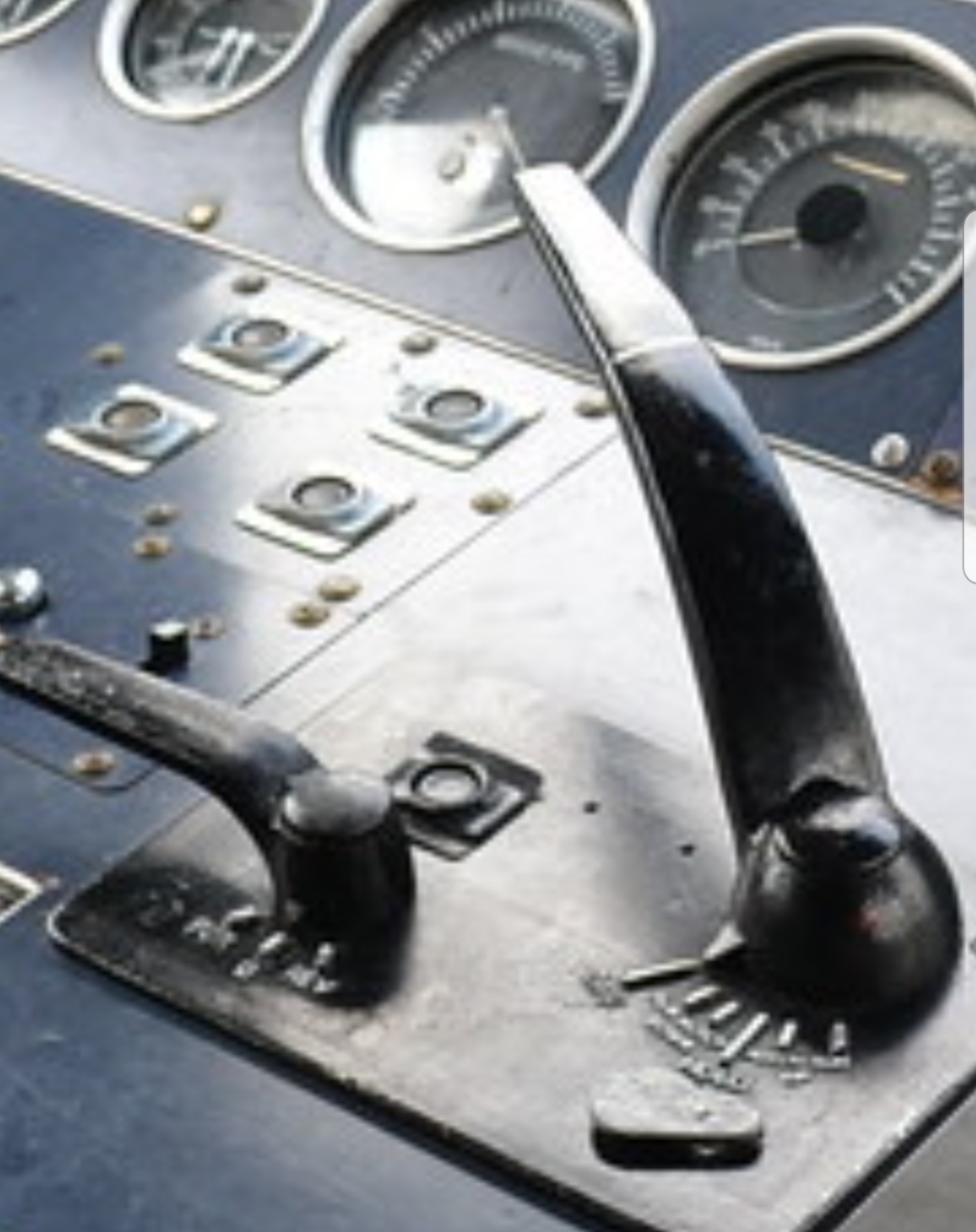

This is a view of the power controller, the smaller lever to the left is the "reverser" (Forward, OFF, Reverse)
Is it an optical illusion that the main (big) lever in this image appears to be rotary, but the one in the video appears to be linear (back and forth)?
Also, the embossed graphic in the image above appears to show two clicks between Hold and the extreme clockwise detent position; and two clicks, but no detent in the extreme anticlockwise position?

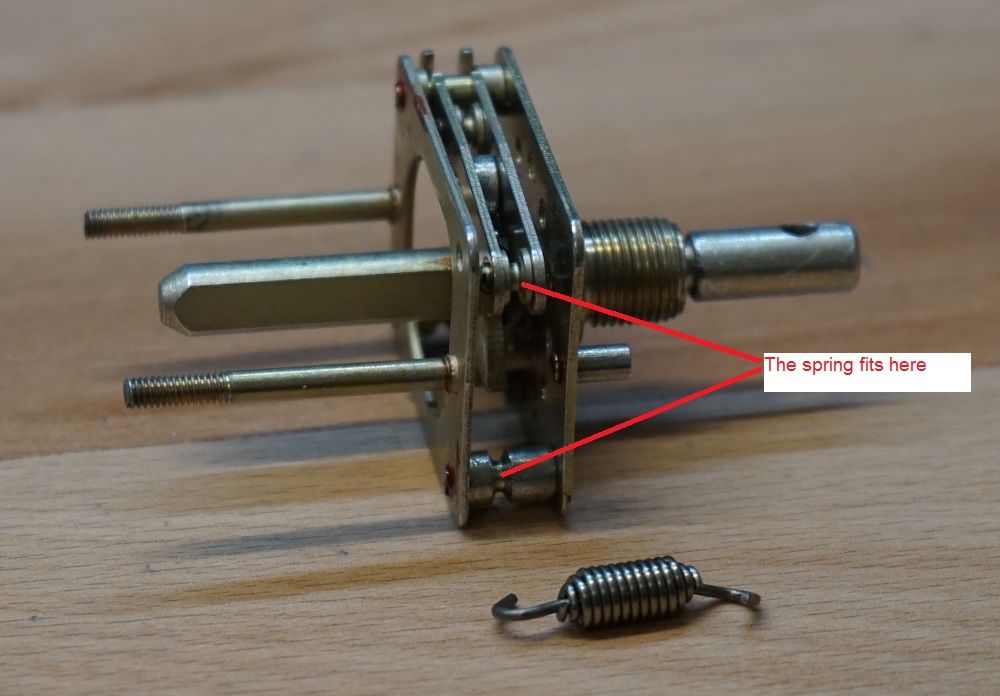

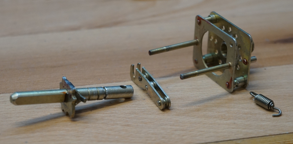

Well, I have just had a happy hour on the tools in my mechanical workshop (aka garage), and I have modified a switch mechanism in the manner proposed above.
The good news is that it works in principle, but could stand a bit more fettling, maybe on another mechanism, to make it work a bit more like the real thing.
Look at the pictures...
The switch mechanism:
I left the spring off because it is a tough mean finger busting little thing.
To give you an idea of the scale of this thing, the shaft through the switch is 62mm overall length.
The individual components:
And the end view of the modified detents on the shaft:
The problem with this is that where I have filed away the detents, in order to get sufficient angle for the little roller which engages with the detents to slide into the HOLD position, I have removed a bit too much metal such that the spring is practically closed up and providing very little force to hold the switch in position.
But hey ho, there has to be several ways to sort that.

I'm gobsmacked... You did that in an hour???!!!
Maybe, just maybe this project may get off the ground with the help of you bunch of amazing people...!!!
Hi Buk...
Yes its an optical illusion, it's a rotary switch that moves through (I think 90°) but when the driver operates the power controller, it looks as if he's just moving it backwards and forwards...
Little bit confused about what you are asking about this??? I'll explain how the controller works if it make it easier for you???
Starting in OFF the handle is moved to the HOLD position then to the NOTCH UP position and released so it springs back to the HOLD position... As the speed increases & the ammeter decreases, the driver manipulates this process until such time that the handle can be mover to the RUN UP position to let the tap changer do it's stuff without overloading the ammeter (traction motors)
Once the tap changer has reached it's maximum of 38 notches (I think off the top of my head), the handle can now be moved back to the HOLD position until such time that the driver either:
1. Returns the handle back to the OFF position (in which case the tap changer automatically runs down from notch 38 (or what ever notch it's in) to notch 0, BUT, during this time power CAN NOT be reapplied UNTIL the tap changer has reached notch 0...)...
2. Returns the handle to the RUN DOWN position in which case the tap changer will automatically decrease the notches until the driver chooses to move the handle to HOLD or NOTCH DOWN / NOTCH UP /RUN UP positions
3. Moves the handle to the NOTCH DOWN position and then releases the handle which then springs back to the HOLD position. This must be repeated if the driver want to make fine adjustments to the tap changer...
Apologies about the essay, has it made anything clearer for you??? The YouTube video I posted further up in the post may make things a bit clearer if you watch it...

One thing I omitted to say (sorry!!! :confused:) is that the lever quadrant turns through 90° - 120°... I think in reality it's 90° but I'd accept up to 120° if it makes things easier to make...
Most off the shelf rotary switches have 30 degrees between steps, your controller has six positions, ie five steps, so modifying a standard rotary switch as I have done will result in a total control lever travel of 150 degrees.
To produce a controller with a 90 degree overall movement would be a large task, probably involving making everything from scratch.
