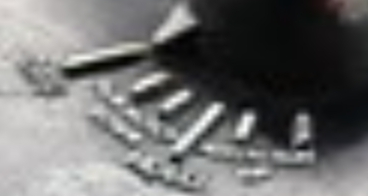

I was talking about the embossed scale shown around the base of the lever in the image here:
does anyone know of a way of creating such a switch???

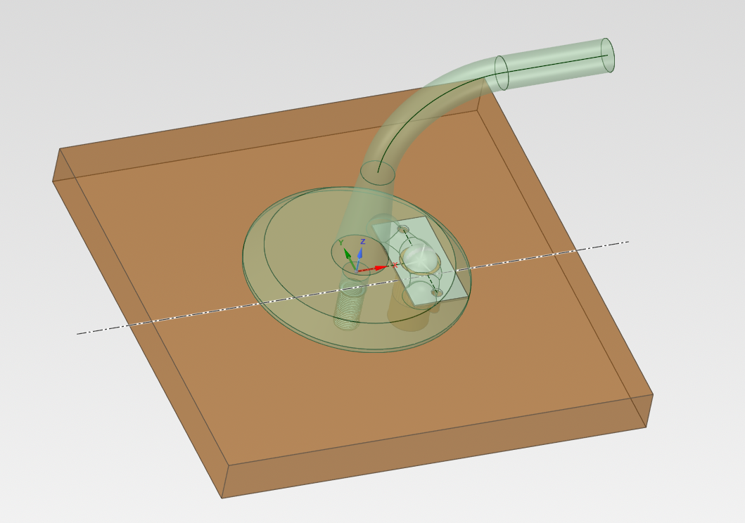

I think I'd set one of these
into the top of a bench or table and cut a disk of MDF and carve a groove into the bottom something like this:
You can then mount some microswitches elsewhere under the disk and cut a groove to clear the switch buttons and put a peg into trigger them.

If I think you're on about what I think you're on about(!) then the small indent to the extreme right of the picture is the maximum the lever will go...This is the NOTCH UP position...
Eric

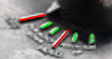

I thought the long lines would be the detent positions and the short ones the momentary ones; and was confused why there were only two detents when you had described 3.
I now see that the middle(ish) red line is the HOLD; and the left red line must be OFF. And the two green lines immediately either side of HOLD must be the momentary positions and the outer two the UP and DOWN detents?

The extreme left red line is OFF (detent), then moving right, RUN DOWN (detent), NOTCH DOWN (sprung returning to HOLD), HOLD (detent), NOTCH UP (sprung returning to HOLD) & RUN UP (detent).

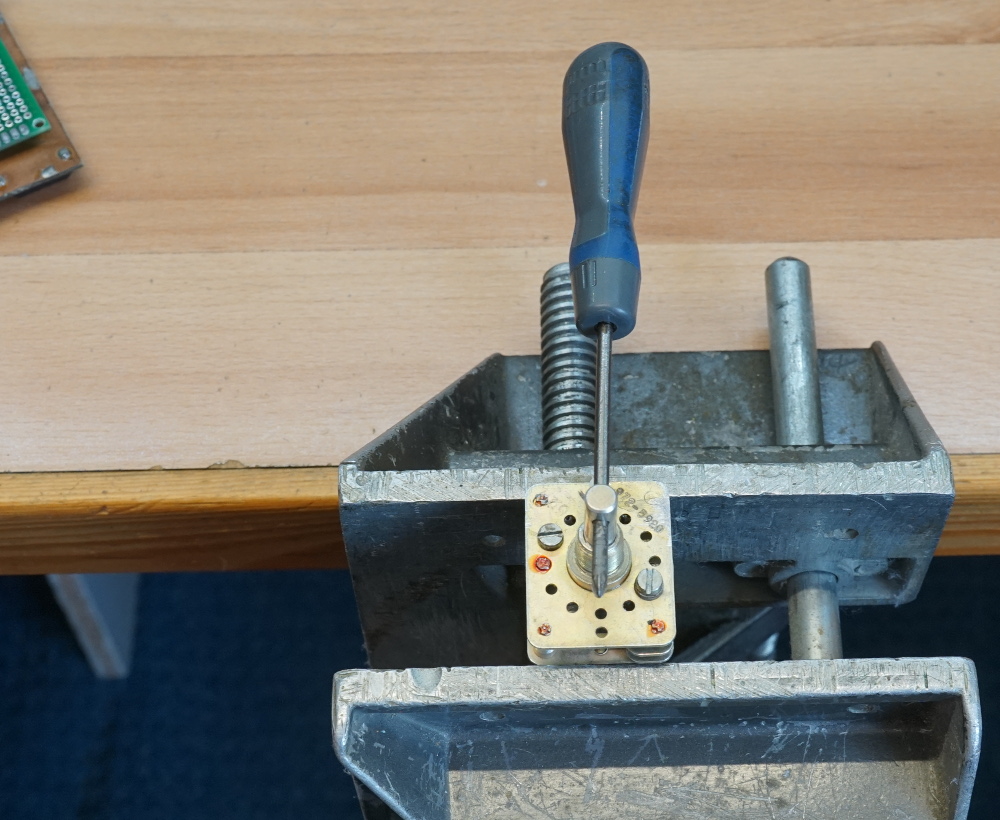

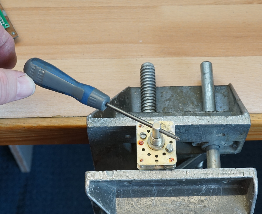

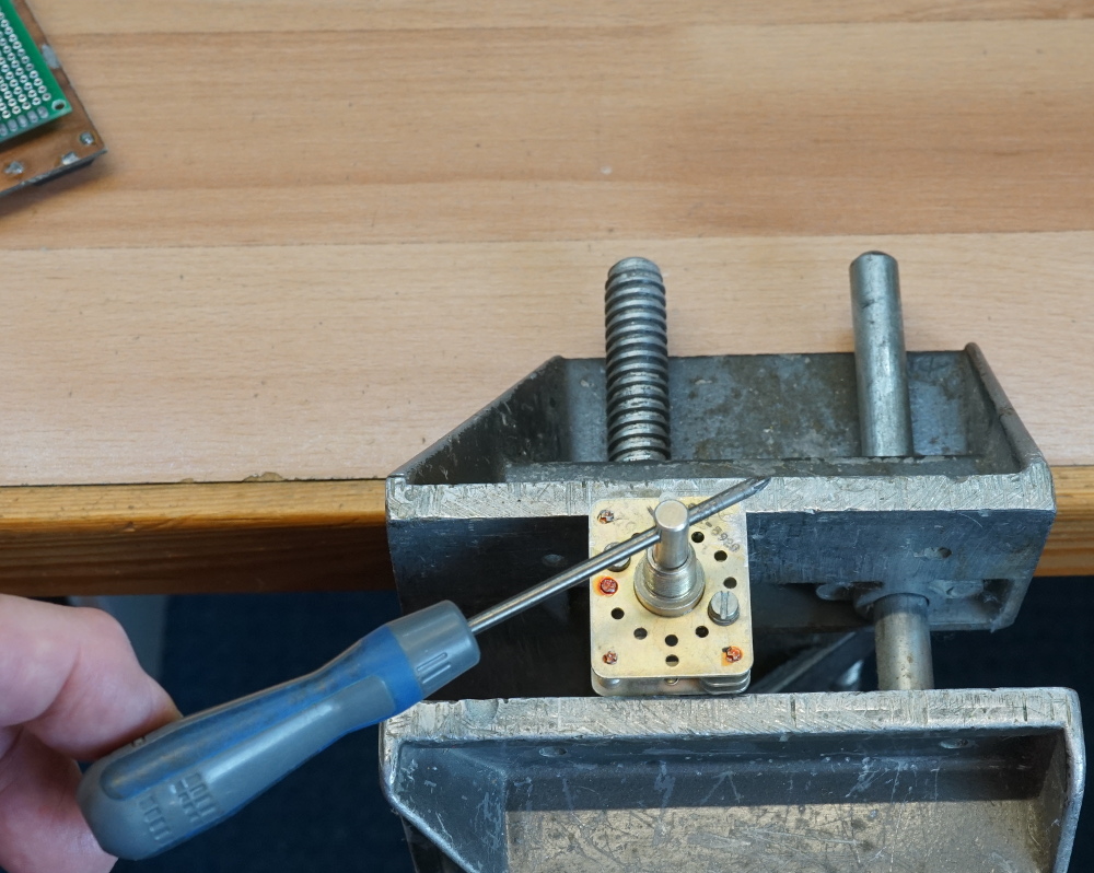

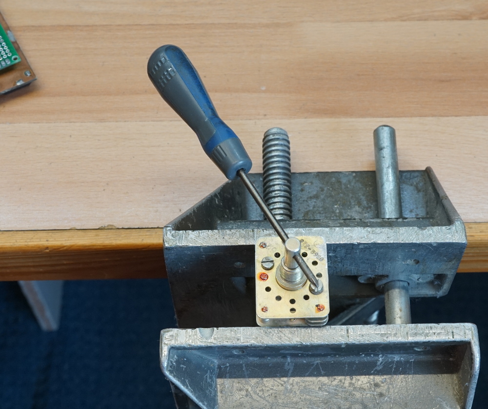

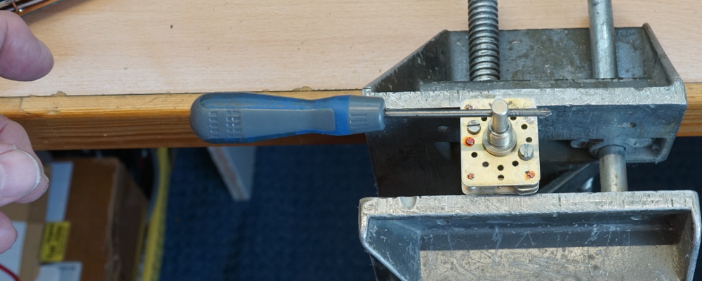

Another hour or two in the mechanical workshop, and I refined the switch mechanism which I modified last night,
and this is how it works:
A small screwdriver is inserted into the hole in the switch shaft to simulate the operating lever:
OFF, selected
Run Down, selected
Notch Down, selected
Notch Down, released (The HOLD position).

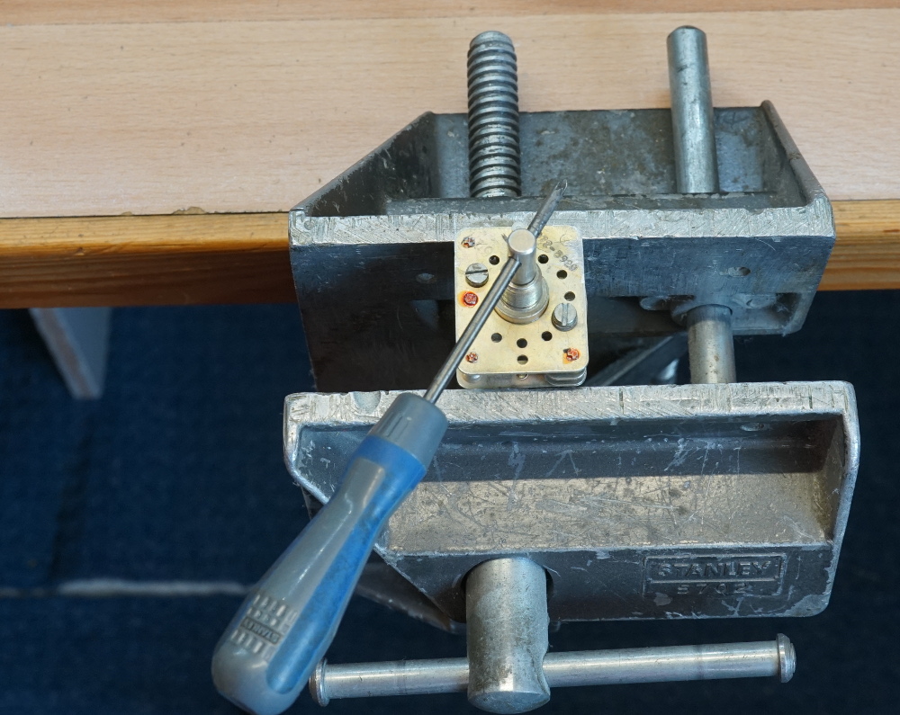

Notch UP, selected
Run Up, selected
So, there it is, that is a good as it gets I think, by modifying an off the shelf rotary switch.
Note, there are no switch contacts fitted to the switch mechanism in these pictures.

Electrically, the switch is simply a single pole six way switch.
Wiring that switch to the digital inputs of a microcontroller, and having the software in the micro send the appropriate code for the keyboard letter is the next step.
