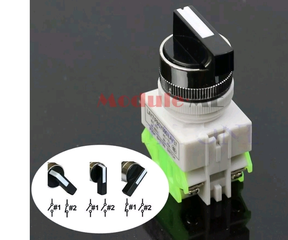

Sorry to be a pain & ask so many questions... could a switch like this:
be converted from 3 positions to 2 positions??? I need a 2 position, 90° on off switch but the ones I've seen are stupidly expensive yet 3 position ones are relatively cheap...
