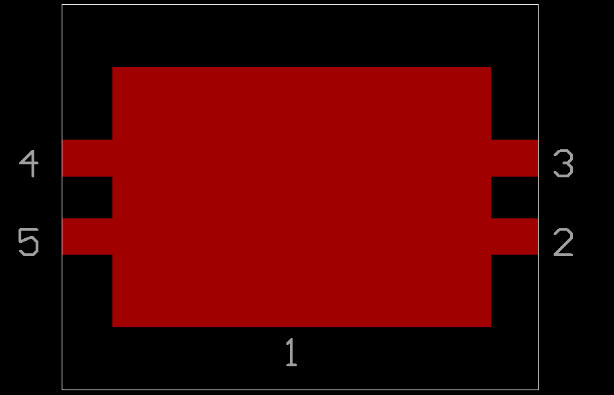

the problem with Eagle is the fact, that it won't allow to create SMD pads other than rectangular.
In that particular case you would have to use five SMD pads, one 2.4X1.65mm, and four pieces of 0.75X0.23mm, placing them according to the datasheet outline. I'd call them TP1 through 5.

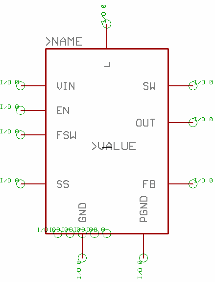

The symbol must contain those 5 pins as well to create a proper device. I suggest to put them underneath the "frame" of the IC-symbol. (pin length - point, visible - off)
The symbol should look about like this: (attachment) Note that one of them is loacated just on top of the regular ground pin. So you just need to extend the net into that pad.
Save the symbol and create a device using that symbol and the package you have already done.
Connect pins and pads as you do with any device.
That method has the advantage, that the solder stop will include the entire thermal pad.

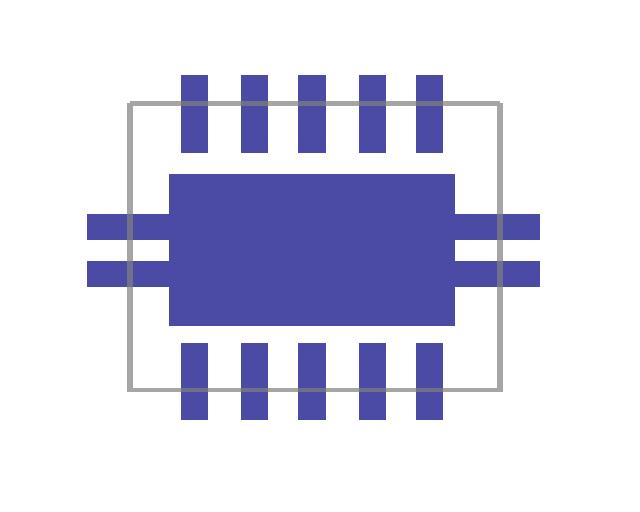

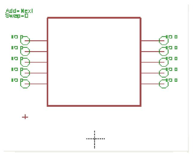

okay, here is what the schematic symbol and board symbol look like right now. As you can see, the board symbol shows the rectangular pads for the thermal pad, but there are no pins on the schematic that correspond. Do they need to be manually connected from the board with the thermal via, or should there be connections made on the schematic? :confused:

You definitely used the wrong layer when designing the thermal pad. You must use the top layer and SMD pads to do it. Also, your symbol doesn't contain any pins to connect to the thermal pads.
The four "fins" are not supposed to produde over the IC-body.
That will neither work in the schematic nor in the PCB layout. If you want to use the IC mounted on the solder side you place it on the component side first and then mirror it. All SMD pads will turn from red to blue indicating that the IC is bottom mounted.
I guess I described the procedure clearly enough.
You might choose an easier way making one rectangular pad only for "TG" (Thermal Ground) and draw the small fins using the top layer. They won't be connected to ground (since they are no pads) but be connected automatically to the center pad if they are drawn without gap adjacent to that.

Once again: Your symbol must contain at least one pin for the thermal pad. If it's name is also "TG" you connect the pin to the pad with the same name when creating the device.
