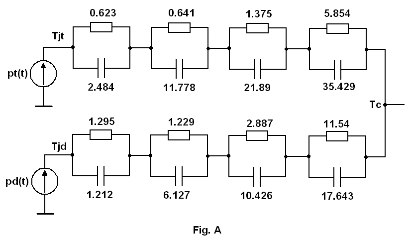

I'm creating a dynamical thermal model of an IGBT power module from ABB:
https://www05.abb.com/global/scot/scot256.nsf/veritydisplay/70bb90c34ed25dcbc1256ff50050ef85/$file/5SNA%201200E330100_5SYA1556-03May%2005.pdf
This module is mounted onto a heat sink with water cooling. Therefore the complete system contains the IGBT module and the heat sink. Also the power module consists of an IGBT and a freewheeling diode (FWD) inside. Thus the final model must comprise the IGBT, the FWD and the heat sink.
The thermal model for the IGBT and FWD could be easily derived with the aid of datasheet parameters and equivalent RC-network (called Foster network) as depicted at Fig.A:
figa-png.57322
The values of capacitors and resistors are derived from the datasheet mentioned above, using the thermal impedance Zth_jc data. The terms pt(t) and pd(t) represent the instantaneous power losses in the IGBT and FWD respectively. These signals are known. Tjt and Tjd are the junction temperature of IGBT and FWD. Tc is the power module case temperature.
The case of Fig.A is well described in the literature (Seimikron Application Book, e.g.) and because of this I am pretty sure of it.

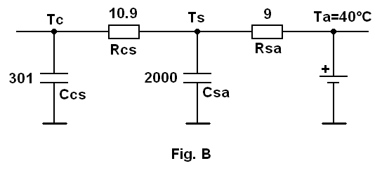

The problems start, when I'm trying to include the dynamical thermal model for the heat sink to the system. Information about this model is poor (datasheet infos are not enough, an exact description in the literature wasn't found). Thus I have done the model by myself according to the physical representaion (Cauer network) as depicted at Fig.B:
figb-png.57323
Tc - power module case temperature (the same as at Fig.A);
Ts - temperature of the heat sink;
Ta - temperature of the cooling water, which is assumed as a constant of 40 °C (modelled by a DC-source);
Ccs - thermal capacity of the power module base plate (thermal capacity of the thermal grease is neglected);
Csa - thermal capacity of the heat sink;
Rcs - thermal resistance of used thermal grease (according to its datasheet);
Rsa - thermal resistance of the heat sink provided by the manufacturer.

1) The MAIN QUESTION: how could the circuits at Fig.A and Fig.B be combined??? According to the literature (Semikron App.Book) it cannot be done just by connecting the circuits directly in the Tc point!
2) The thermal capacity of the base plate seems not to be included in the thermal impedance Zth_jc in the IGBT module datasheet. That's why I added it to the circuit at Fig.B as Ccs. Is it right?
3) Calculation of the thermal capacitances Ccs and Csa? I used the formula:
C = m•c, where m - mass of the material in "kg", c - specific heat of the material in "J/(kg•K)"
Is it right?
4) Is the model at Fig.B correct at all? Did I forget something?

Without going into the detail, I would say that connecting the devices to the heatsink @ Tc appears legitimate.
3) When you multiply m*c, dimensional analysis gives J/K, which seems correct.

If transistor and free-wheeling diode are integrated in the same module, a common heatsink and
case temperature may be presumed for simplification.
From the Semikron handbook. I know it's not perfect but it could be good enough.
If transistor and free-wheeling diode are integrated in the same module, a common heatsink and case temperature may be presumed for simplification.
I've already done so. Both IGBT and FWD have the same case and heat sink temperatures Tc and Ts resp. Because of this I do not understand, how your suggestion could solve the promblem and make it possible to combine Fig.A and B? Could you please explain, what you mean.

Thank you all for the answers. I have some comments...
Of course, I can try to solve the problem like this:
1) Firstly I apply the powers pt(t) and pd(t) only to the circuit at Fig.A and obtain the junction temperature rise Tjt_rel(t) and Tjd_rel(t) relative to the case (assuming Tc as a constant value);
2) Then I can apply the total power losses "pt(t)+pd(t)" to the heat sink model at Fig.B and obtain the absolute case temperature Tc(t) and heat sink temperature Ts(t) dependent on the time.
3) After that the absolute juction temperaures could be obtained as a sum of relative temperaures Tjt_rel(t) and Tjd_rel(t) and the absolute temperature Tc(t):
Tjt(t) = Tjt_rel(t) + Tc(t),
Tjd(t) = Tjd_rel(t) + Tc(t).
It seem to be ok, but I have following doubts:
1) The circuit at Fig.A is specified for a constant case temperature and must be used so. Since for the Fig.B the case temperature is not constant, the results from these circuits cannot be combined (in my opinion). In other words the heat sink affects the dynamical thermal properties of the IGBT module and the circuit at the Fig.A is not directly applicable anymore.
2) If the total power losses "pt(t)+pd(t)" bypass the "junction-to-case" model at Fig.A and are fed directly to the "heat sink model" at Fig.B, the resulted case temperature Tc(t) will have excessive temperature ripples, because the pulses of the total power were not damped by the thermal capacitances of the "junction-to-case" model.

That would be me. My apologies as I have not understood the real problem, which is the model of the heatsink. Your current model assumes a constant temperature throughout, clearly not valid i.e. the cap. You would have to divide the heatsink into a number of small cubes which had minimal temperature gradient across them, and then interconnect them. Basically a 3D resistive mesh with caps representing the thermal mass of each cube at each junction. You would then have to solve this 3D matrix. You would also need elements on the surface cubes representing convection and radiation losses. Very non linear. But this wouldn't take into account the propogation velocity of phonons within the material. I seem to vaguely remember that phonons/heat can have lowish velocities depending on the material. But don't quote me on that.

Thanks for your proposal. It's going now to turn into a real FEM simulation, what I'm striving to avoid :) And I'm not sure, that the FEM approach is really required here. Because if we consider the heat being spread only in one dimension (directly from case through thermal grease and heatsink to the ambient) and that the heat sink is homogeneously heated (its temperature is the same throughout the whole volume), than we can still use one RC-network for each "layer" as done at Fig.B. It would have some discrepancy from reality, but as already said, I want to avoid the FEM as long as possible.
But let me now consider another approach, that I have also found in the literature. It appears that it might be possible to convert the circuit at Fig.A to the form of the Fig.B circuit (Foster network to Cauer network). Since the Cauer network represents the physical structure of materials, it should be possible to connect the modified Fig.A to non modified Fig.B in the "Tc" point. Than the system could be modelled as a single entity. What do you think about that?
You won't get close to reality with your simplified heatsink model, especially for dynamic response. It appears that the thermal velocity of heat is relatively low, it's what they call the speed of sound for a material amongst other names. These models don't even address that, you would need delay elements to do that. And unless the heatsink is relatively small, say a water cooling block, the thermal gradients are going to be significant. It appears that it is an FEM problem. The only possible simplifications would to be use symmetry to reduce the number of dimensions of the matrix, but I can't see how that would work either.
I made the simulation for the steady-state and average temperature of the heatsink, and the results match the measured temperature of the heatsink very good (deviation about 1-2°C). That means, for the static case, when thermal capacitances are not considered, the model works correctly.
