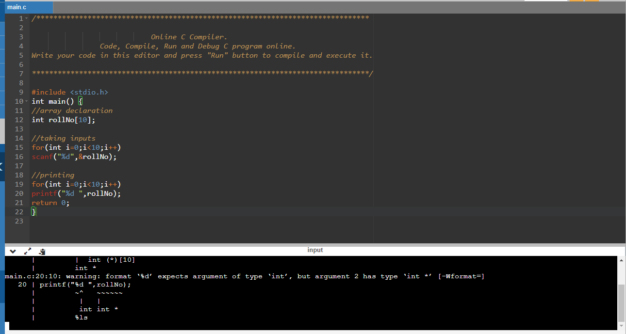

#include <stdio.h>
int main() {
//array declaration
int rollNo[10];
//taking inputs
for(int i=0;i<10;i++)
scanf("%d",&rollNo);
//printing
printf("%d ",rollNo);
return 0;
the program, is not runing.
It should take 10 integers from the user and then print them again.
Here is your error :
You did not specify the specific array element to print.
Is your compiler not showing you error dialog ?
Regards, Dana.

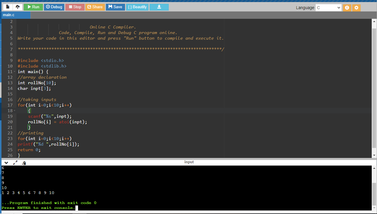

Try this one
Scanf works here..
#include <stdio.h>
#include <stdlib.h>
int main() {
//array declaration
int rollNo[10];
char inpt[3];
//taking inputs
    scanf("%s",inpt);
    rollNo = atoi(inpt);
//printing
return 0;
Should this :
    scanf("%s",inpt);
be this :
    scanf("%s",inpt);
    rollNo[i] = atoi(inpt);
Also do same for rollNo in print statement, eg use as array element....
Regards, Dana.
