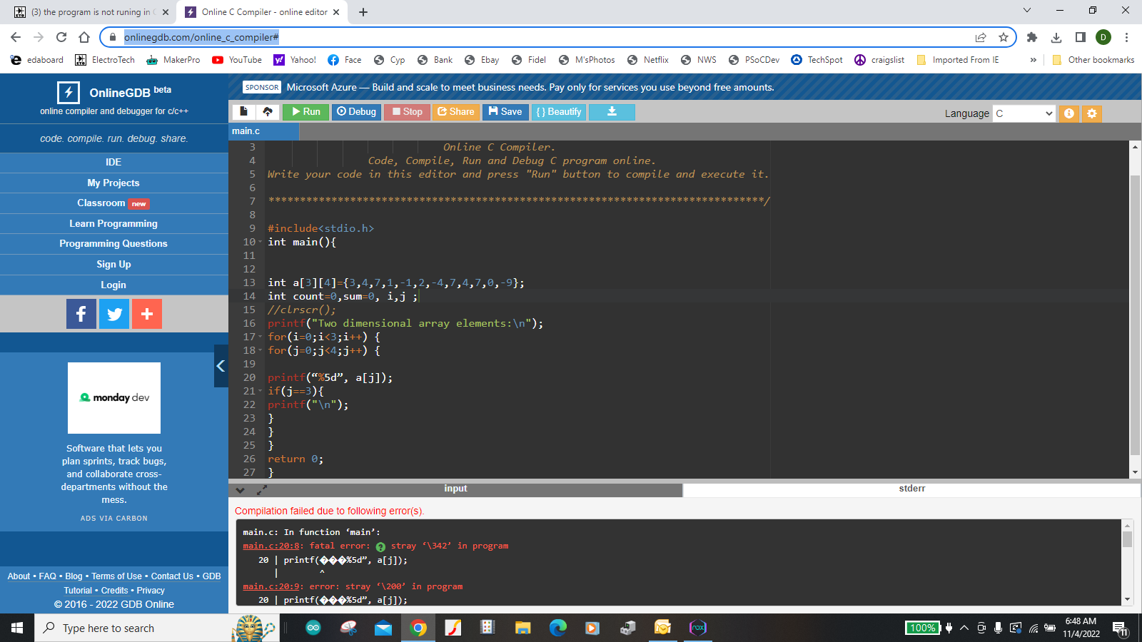

#include<stdio.h>
int main(){
int a[3][4]={3,4,7,1,-1,2,-4,7,4,7,0,-9};
int count=0,sum=0, i,j ;
//clrscr();
printf("Two dimensional array elements:\n");
for(i=0;i<3;i++) {
for(j=0;j<4;j++) {
printf(“%5d”, a[j]);
if(j==3){
printf("\n");
return 0;
This program is also not running although I fixed the error:
f(j==4) to f(j==3).
thanks a lot
You can check your own code here :
Regards, Dana.
