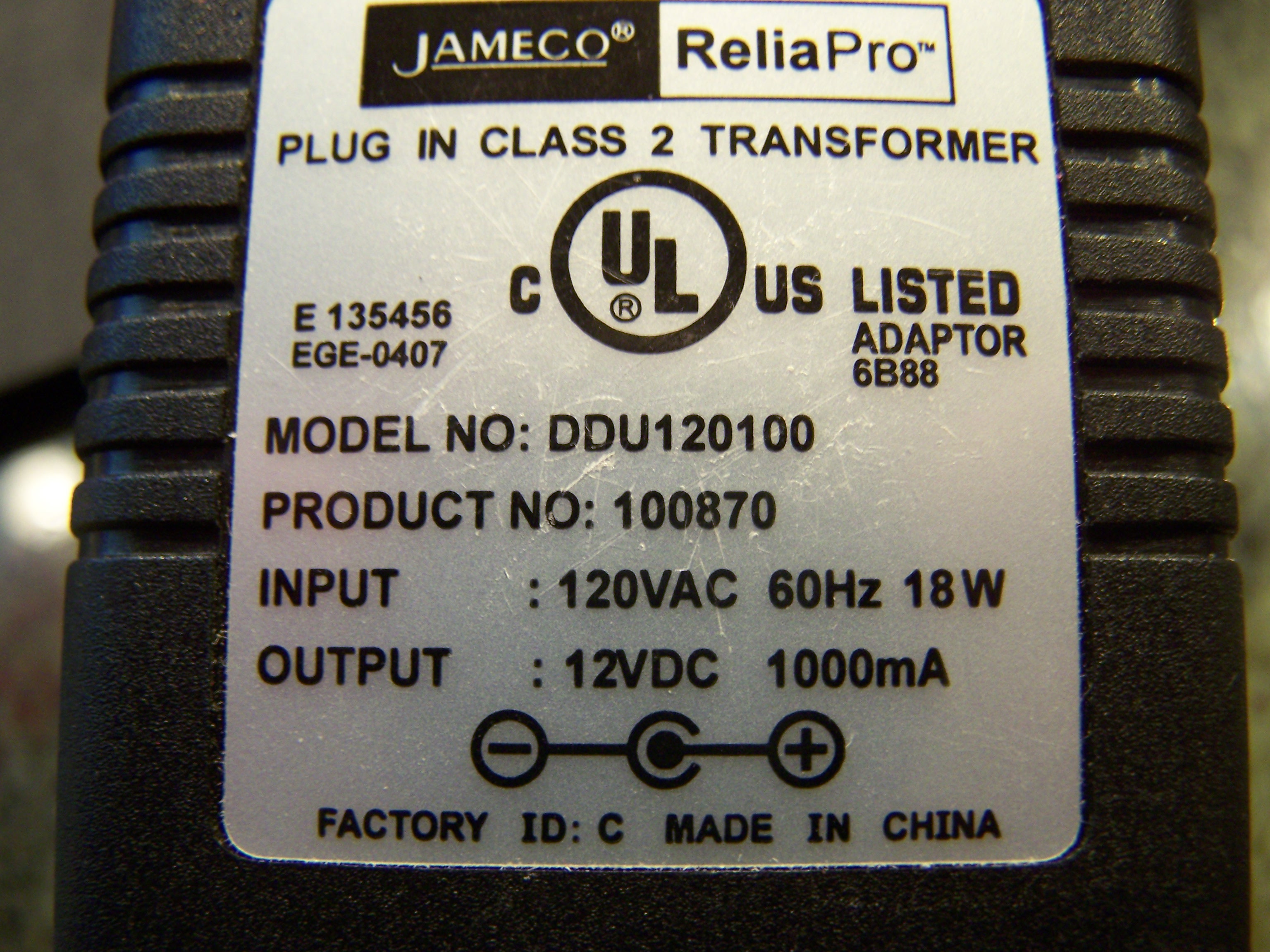

What do you have for a power supply? (its voltage, its max current and its output filter capacitor value)
This is the power supply I am using, I am also using a 220uf cap the one specified in the schematic.

Your 12VDC/1A power supply has a max output of 12W. It might be enough for the amplifier to drive an 8 ohm speaker to 7W and make an additional 5W of heat. The power supply does not have enough output current for the amplifier to drive a 4 ohm speaker.

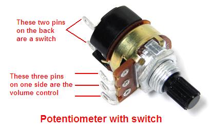

Alright, thank you, I will work on some enclosures. Does this type of amp hum very slightly and is not audible when the music is playing? It also buzzes when I touch the POT. There are 2 pins in the back, are those used to ground the POT so it does not cause interference, or will it be fine when I have a cap over it. Thanks again for the help.
Every name-brand speaker has a very detailed datasheet. Then an enclosure can be made to match those specs. Frequently a recommended enclosure design is on the datasheet. If the enclosure does not match the spec's of a woofer then there will be no bass or there will be no deep bass but instead there will be boomy upper bass.
An audio amp should produce no hum if it is built correctly.
If you connect the metal case of the volume control pot to the circuit's 0V then it won't hum when you touch it. We don't know which pot you have so we don't know what the two pins on the back are for. Maybe they are simply an on-off switch that are not even connected to the pot.
The pins on the pot are not for a switch, and I cannot find any information online about the speakers besides RoHs. Since the speaker output wires are not carrying an amplified signal, do they need to be insulated? And since the heatsink is connected to Pin 4 which is grounded, it also does not need to be connected to ground?
If you have a mono (single channel) volume control then its pot has 3 pins all on one side.
The other two pins on the back
I think they are an on-off switch.
You should connect pin 4 to ground. The metal tab on the amplifier is internally connected to pin 4 and is bolted to the heatsink so the heatsink doesn't need to be connected to ground separately.
