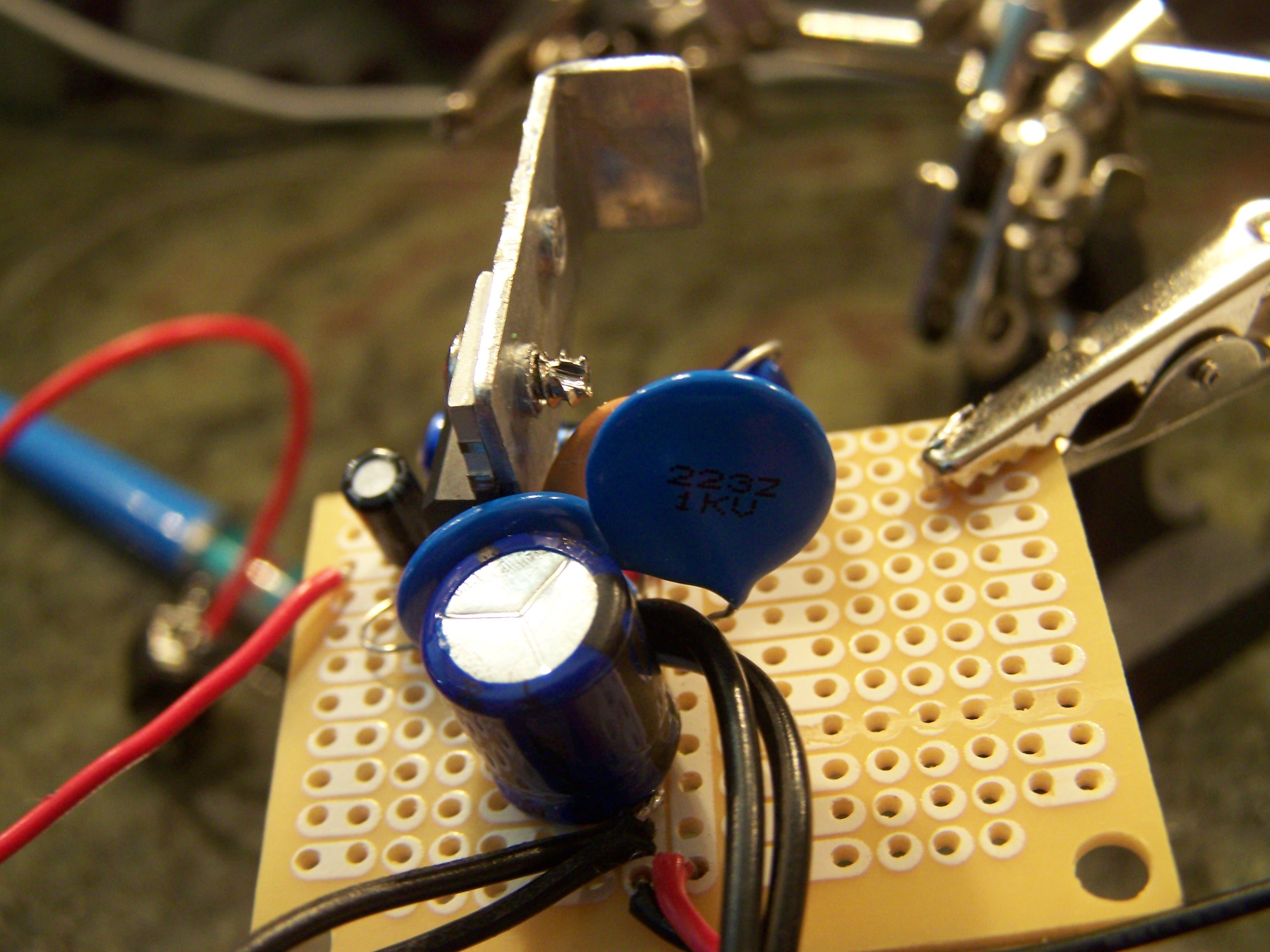

I tried to fix the caps on the 7240, but it is still barely working, I am an a loss right now

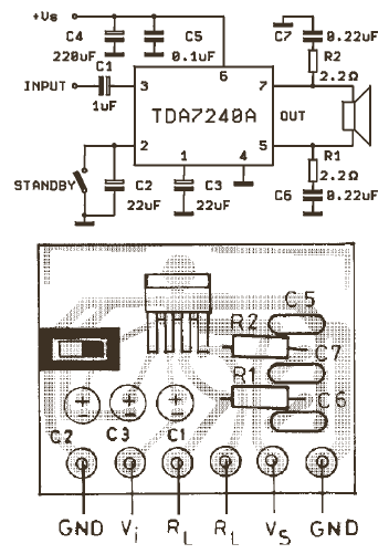

I think you need to make the pcb that is shown on its datasheet and use the same capacitors shown.

Alright, I am using a protoboard from radioshack for this, I had a few spares lying around. Two of the caps are large and blue, because I could not find any of those values at my local electronics shop. Could that be a problem? They are the 2 caps in series with the output.
proto-board from RadioShack is poor quality. It warps and breaks, its holes are too big and its copper strips are too thin and poorly glued.
I recommend that you look at the pcb design in the datasheet. The capacitors at the output must be good at high frequencies so ceramic or film capacitors are shown. You used electrolytic capacitors that are poor at high frequencies and maybe they cause your amplifier to oscillate at a high frequency instead of amplifying audio.
I changed out those electrolytic caps one the output and one the power input, i will take 1 more pic of it from the top
223 capacitors at the output are wrong because they are 22 and three zeros which is 22000pf which is only 0.022uf. you are supposed to use values that are 10 times higher at 0.22uF.

I scrounged for those caps and i found a few, so I tried them out,and it still did not work, so I took everything off of that little protoboard and am going to put it all on another pad-per-hole board or veroboard, to make it a little less cramped and see if that works. I also think that a problem might be the standby switch...i hope thats the problem, since I have the materials now.
I moved it too the protoboard, and it works for about a second when i flip the standby switch one way then the other, then it seems to shut off. I thought it was where i placed the spk output wires, but it is the same as it the pcb, after the resistor lead, so i am not sure what to do. It seems like it its so simple, I have no idea how I am getting this wrong.
The schematic and pcb layout on the datasheet of the TDA7240A shows exactly how an amplifier should be connected.
How can you connect the speaker to the wrong place??
