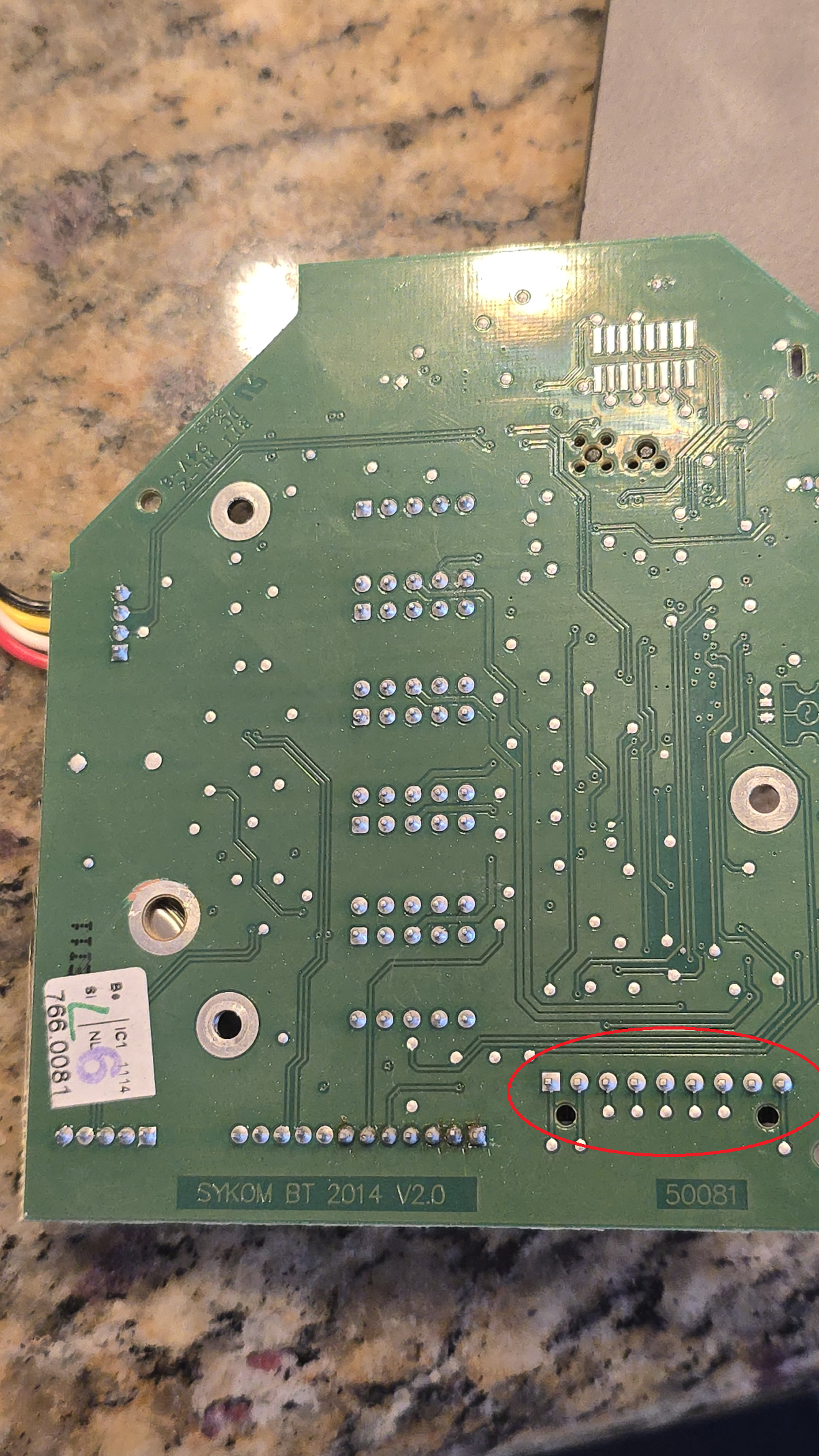

I have a variable speed pump that does not have wifi and would like to add one.
Found a youtube video of someone taping into the buttons of the controller using a WiFi relay to mimic a button press. Is it safe to assume that most if not all buttons are some forum of dry contact?

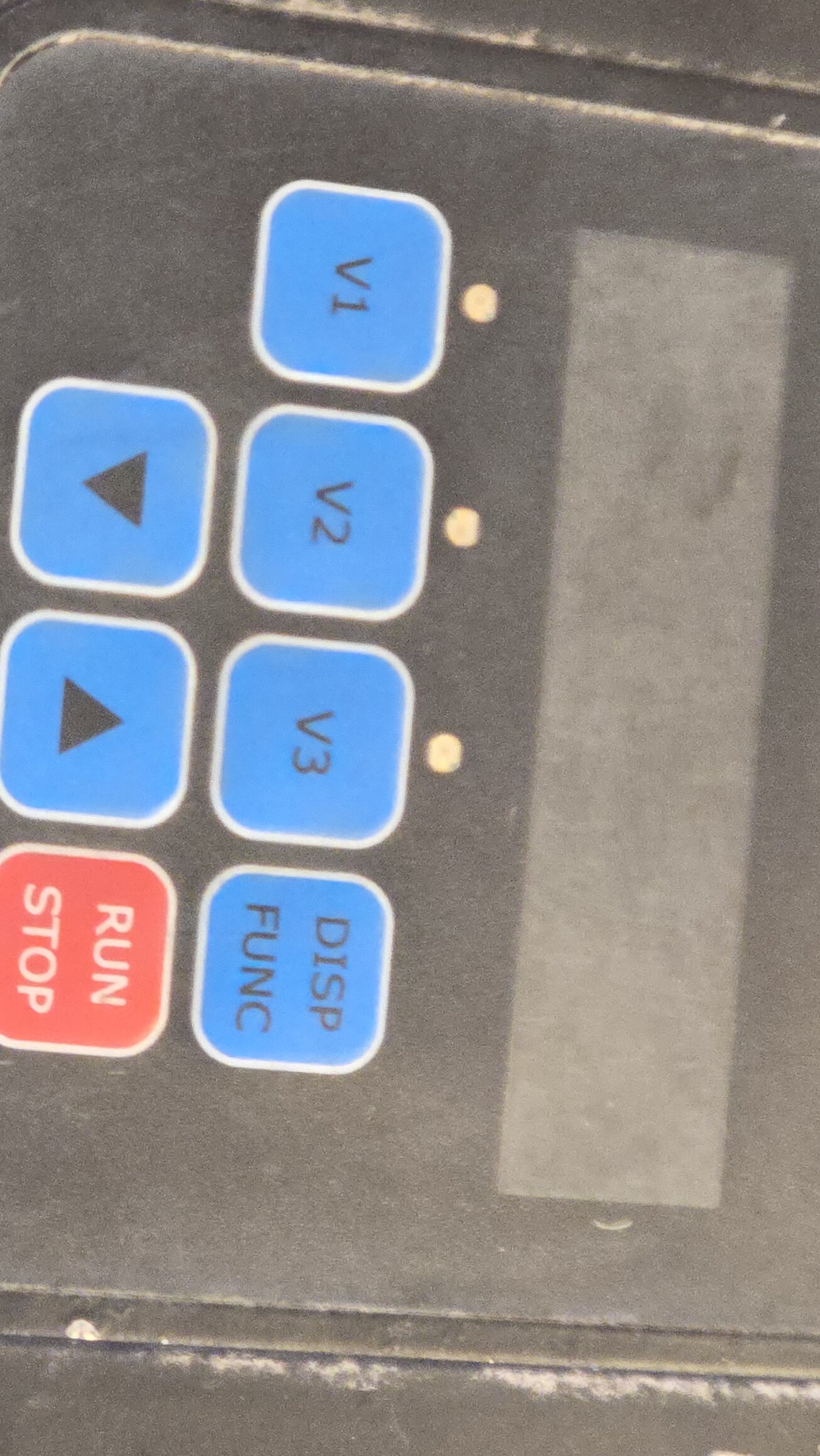

The buttons are connected using a ribbon cable to the board in the photo below. There are a total of 7 buttons on the keypad and a total of 9 pins on the ribbon cable. I measure the current and it appears that it's operating on 5V.
I don't know much about electronics but I'm guessing the keypress should send 5v to whatever the trigger is?
What's the best way to figure out which buttons to press? Would I be measuring for continuity or voltage? 20241020_171444.png20241020_171417.jpg20241020_171410.jpg

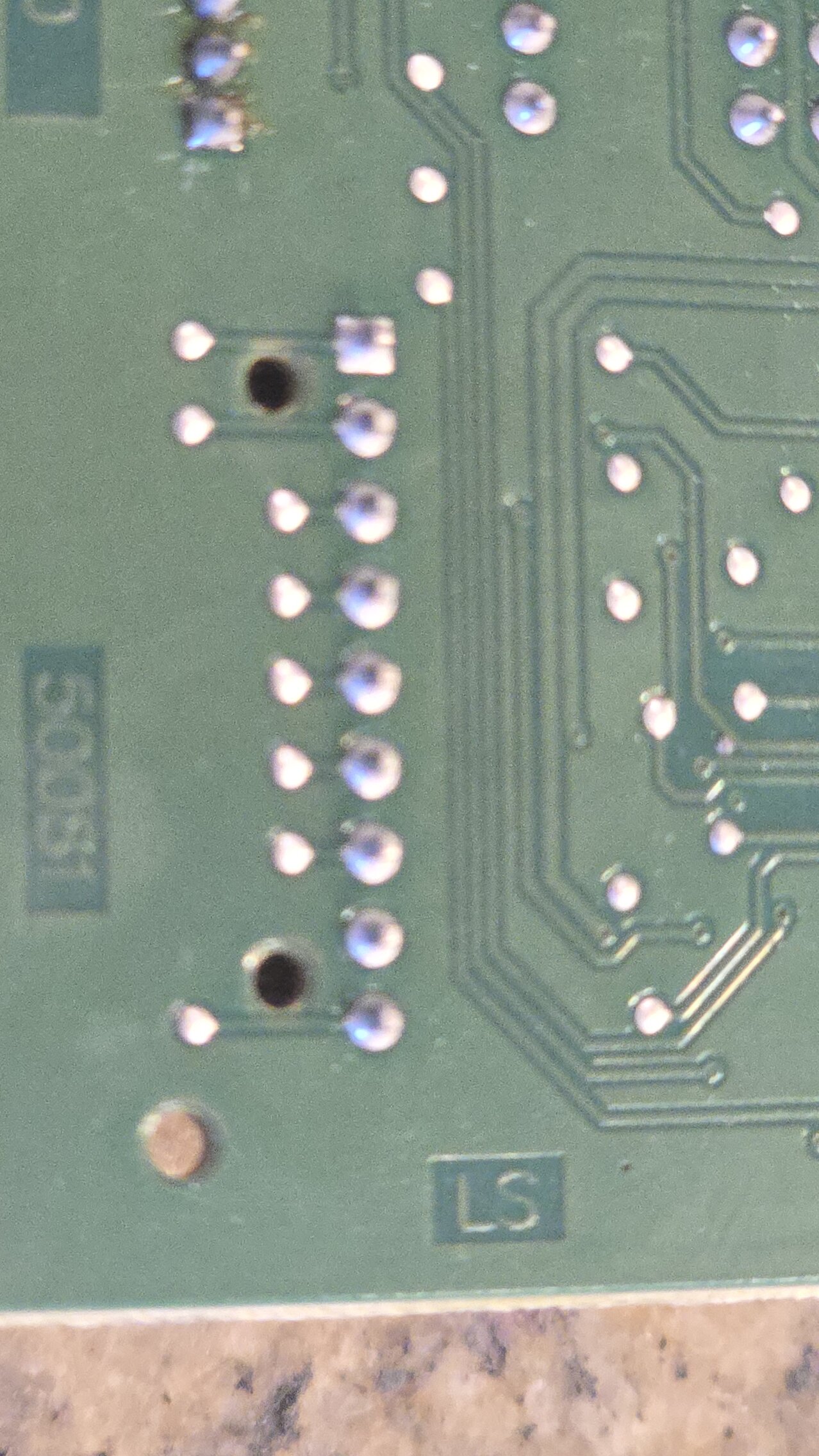

If you can unplug the keyboard from the unit then test for continuity between the 9 pins. First do this with no buttons pressed. I would expect to find no continuity between any of the 9. Connect one test lead (Say black) to pin 1 then go through touching the red lead on pins 2 to 9 in turn. Next move the black test lead to pin 2 then touch the red lead to pins 3 to 9 in turn. Repeat this until you ave the black lead connected to pin 8 and touching pin 9 with the red lead.
then repeat this process with one button pressed at a time. Create a table of the results and post it so we can work out how it works. As a simple none multiplexed design would only need 8 connections we need to understand why it needs to use 9 wires. Be aware that the contact resistance of membrane keypads can be several hundred ohms.
What's the best way to figure out which buttons to press? Would I be measuring for continuity or voltage?View attachment 147487View attachment 147488View attachment 147489

So what's strange is I can only get continuity out of 2 wires, I can confirm that when shorting + to those wires does trigger. However, I cannot get continuity out of 3 buttons speed 1, 2, 3 that I really need to tap into.
But at this time, I should be able to at least turn the pump on and off using the one of the wire I found. Is that normal that the buttons react different on the whole panel?
Another I discovered was all but one wire appears to be grounded, I kept constant on the positive and was recording currents on all pins when I moved the ground probe.
If I short the two pin in the box, it triggers the start and stop.
I don't undestand your post #12. I have no idea what is normal on your device.
The tests I requested were with the socket from the keypad to the board unplugged. You then take resistance readings between the connector on the and of the cable from the keypad. As Nigel pointed out DO NOT rely on the continuity range as we do not know at what resistance reading the buzzer changes from off to on. I bought a keypad recently and the contact resistance for some of the buttons was more than 1000 ohms. You will need to find some connector pins to plug into the the connector on the end of the keypad cable to do the tests or get someone to help you by pressing buttons while you hold the meter probes onto the connector pins.

Hello everyone, had the time to test this some more, I went through about 40 different wire combination possible and found all the pin combination that responded to the button press. The ohms reading jumps to about between 28-30 initially but usually settle around 25 ohms and drops gradually so I'm calling it 25 ohms for now.
Below is the chart that I made of all pins. I'm only interested in start/stop and V1-V3 (speed)
I know I can start and stop using the relay. According to this, Board Pin 6 is the common pin for speed control. What's throwing it off a little for me is that Board pin 4 and pin 1 also trigger the display/function feature. Is it safe to ignore that according to what this chart is showing? On the board, Pin 1 is far left.

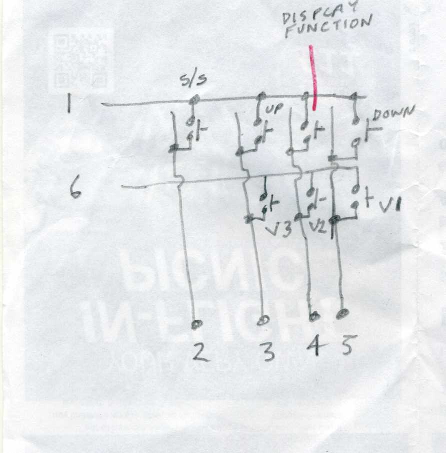

It looks like the buttons are aranged in a 2 x 4 matrix
I think one axis is pins 2 & 6 and the other axis is pins 2,3,4,5.
I think 1 & 6 is the driven axis and 2,3,4,5 is the axis that goes to inputs. (Probably a microcontroller.)
If you look at pins 1 & 6 with an oscilloscope you will finf that theybare being pulsed all the time.
When pin 1 is active the buttons Up, Down, start/Stop and Display function are being read by the microcontroller. When pin 6 is active V1, V2 , V3 are being read. Since the microcontroller is generating the scan pulses it knows the meaning of the 4 inputs for that time slot. You can see from the above diagram how to connect the 7 sets of relay contacts from the remote link.

Something to add which will probably explain why I measured 5v from pin 6 as well. When the pump is priming, depending on my programmed duration, buttons V1-V3 does not respond. It is only when the priming cycle is completed before I'm able to trigger those buttons.
The software in the microcontroller is probably programmed to ignore those buttons for some reason at that time. It MIGHT be possible to use opto isolators instead of relays. You can get 4 opto isolators in a 16 pin DIL package so that would save space. If you use opto isolators that used phototransistors on the output side you may have to add diodes to avoid them conducting when the polarity was reversed.
