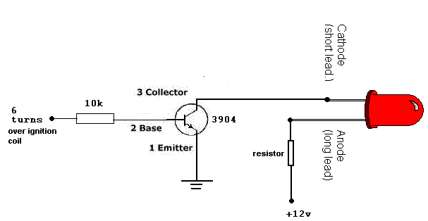

layout and code for the pic16f628 based tachometer.if ur building it for lathe use some hall effect or proximity sensor for signal input.and if u want it for automotive like motorbike or car,wound 6-8 turns of thick(sorry no idea of gauge) over the sparkplug cable coupled through 2N2222 or 3905 transistor(have a look at below pic.) and connect the collector to pin4 of PIC

guys one more issue with this chip
i have plenty of PIC16f628A's but the code provided is for PIC16F628,and when i tried to burn the code on 16F628A,my programmer (Multipic) showing some error.is it bcz of the improper code(imean code is build for normal version where as iam using it for A version).
can i do some changes to the code to use it for A version? will it work?
iam following (http://www.josepino.com/pic_projects/index?tachometer2.jpc)

What kind of sensor did you use and how did you connect it?
the author said any small pulse will work for input.
so i used 2N2222 transistor to filter the spikes formed by the spark plug wire.(well iam planning for optochio now for more safety).have a look at below chip u'll under it.that helical is thick enameled copper wire wound around spark plug cable.
*can u help with this code issue?
