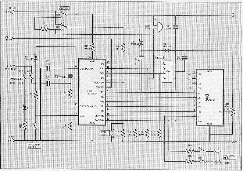

A 555 can be used to make an analogue tachometer, basically just a monostable - it's been used for years in cars etc.
If you want a digital readout the obvious way to go is to use a PIC, which along with an LCD display would give a single chip solution.
The magazine EPE did a suitable project called PICAgoras a long time ago, you can download the code for it from their website - and this is the circuit.
BTW, this is quite old, and uses an old LCD that needs a negative voltage - modern ones don't.

Well...here's one right off the bat...Will the LCD's that need negative voltage be a problem and if so, is there a work-around for that?

Essentially everything is done in the PIC, it counts (or times) the pulses, converts the value to sensible units, then displays it on the LCD. It's more the programming that's 'clever' rather than the hardware.
Modern LCD's don't need the negative voltage, so you can just leave out the diodes and capacitors associated with it, and connect the contrast pot to +5V instead. Check my tutorial hardware if you want to see how it connects.
