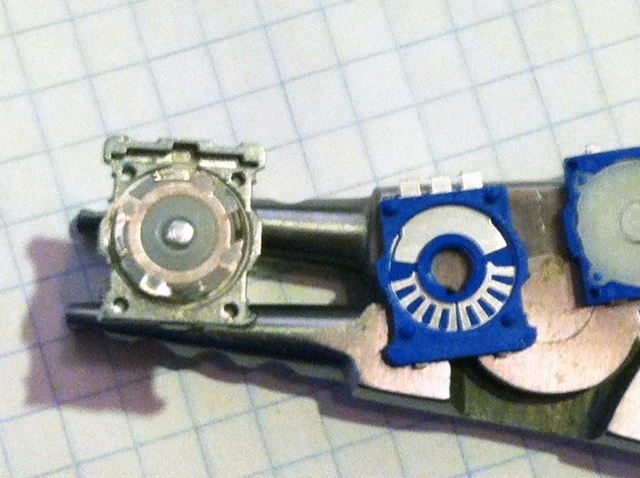

It is a bit confusing. Are you referring to mechanical encoders, and are your data from a mechanical encoder? Or, are you referring to optical encoders, and are any of your data from an optical encoder -- one that you are sure was an optical encoder?
John
Sorry for the confusion, I suppose that is due in part to my not knowing myself. When I googled rotary encoders, the images showed leds, so I sorta thought that is what I had. Well your question prompted me to tear into one of these encoders. Turns out I have the mechanical type (I should have known based on the size). Well anyways, my encoders are the mechanical type which may explain the nasty bounce. Attached is a dissected encoder.
