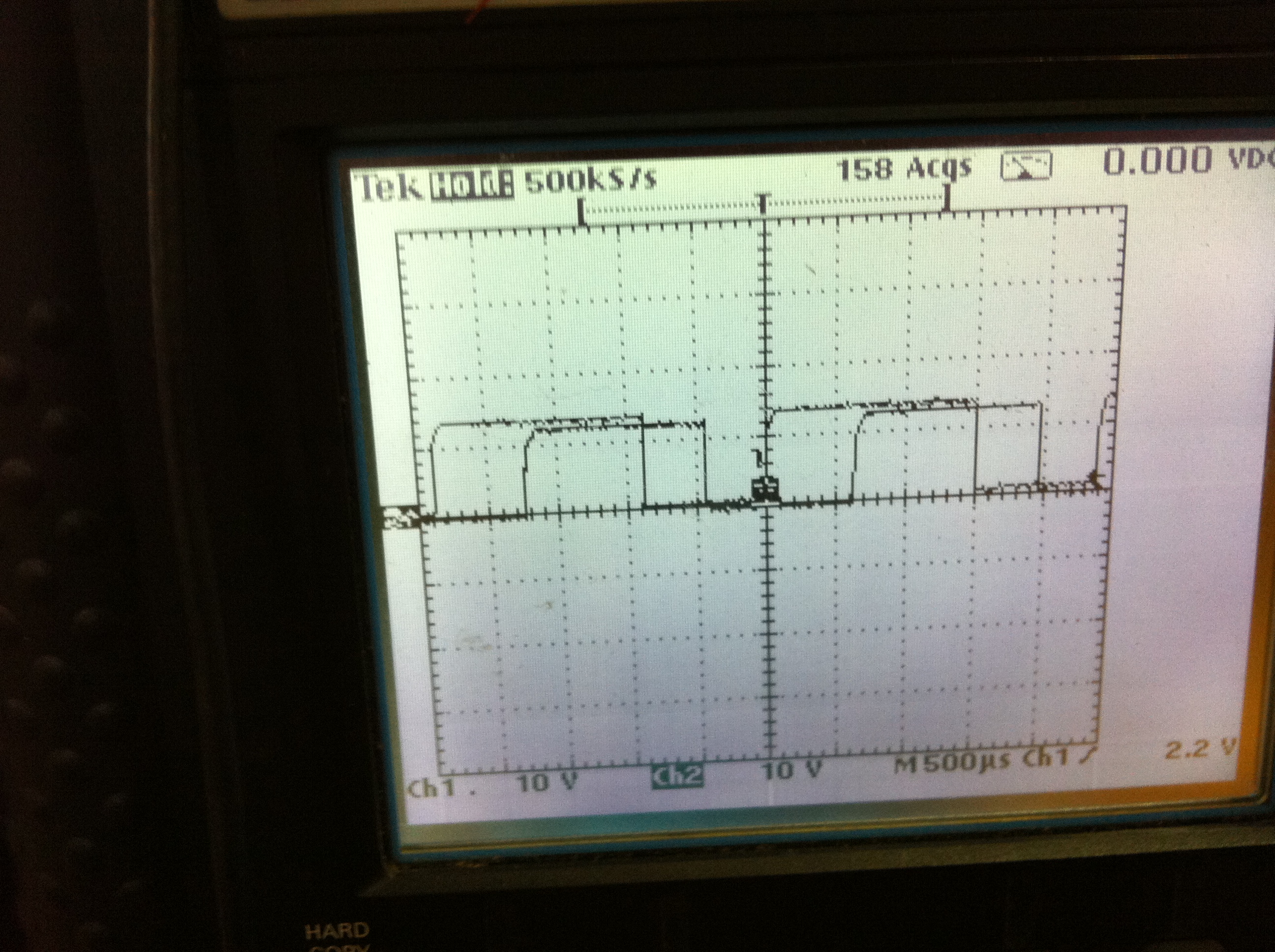

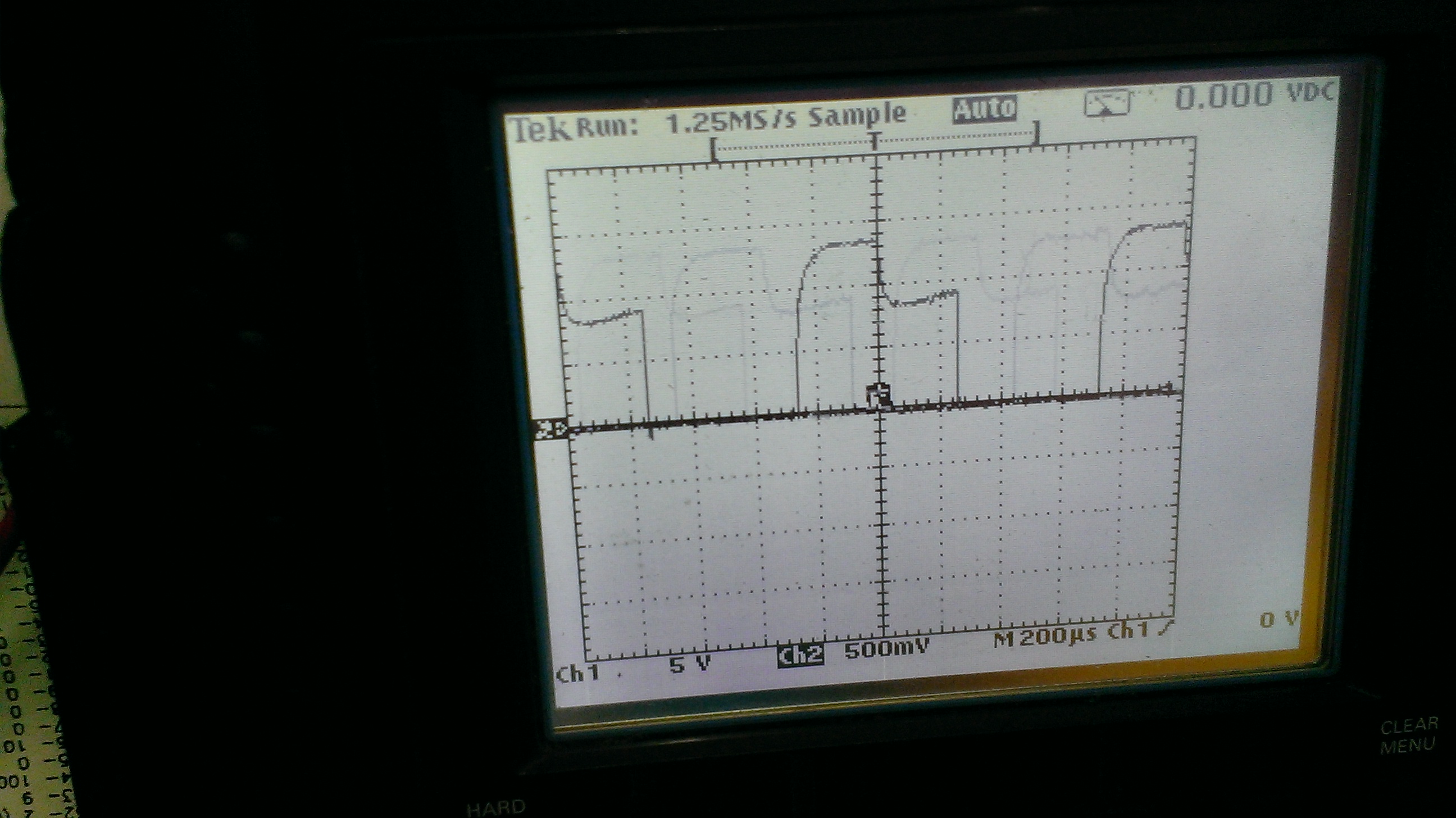

FWIW here are some pictures of what a bad encoder signal could look like, to give you the symptoms you're experiencing:
A-Channel:
B-channel:
A- & B-channel:
And here's a picture of a good output signal from an identical encoder that isn't screwed up:
These came from a huge guillotine-style mattress-making bandsaw. Imagine a big carousel (merry-go-round) but instead of fiberglass horses on it, huge foam "buns." They go around 1 rev and all get cut, then the saw lowers 6"-10" (whatever the thickness of a mattress is), and they go around again, repeat. The giant bandsaw straddles the merry-go-round, and moves up/down on two big screws. These encoder waveforms came from the encoders on each lifting screw, that keep track of height/position. Position reference kept getting screwed up on one side; While travelling stead in one direction, position readout would go up, stop, go up, stop, go down, stop, go up, go down, stop.... and that's what I found. I didn't dissect the encoder to find out what was wrong with it but I suspect there was an internal short (channel-channel, and channel-ground), such that when only 1 channel was high, it didn't have enough power to output full voltage. Replacing the encoder fixed the problem.

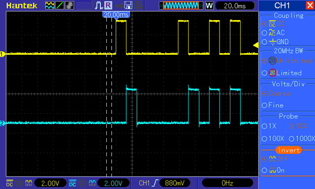

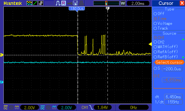

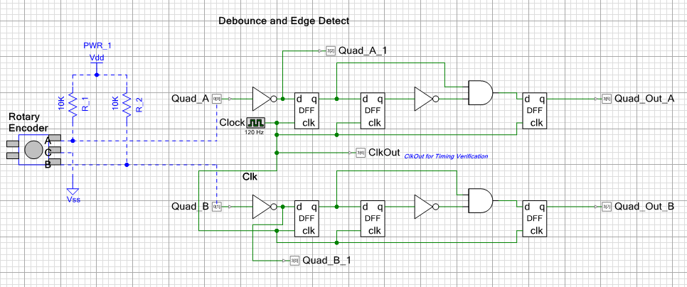

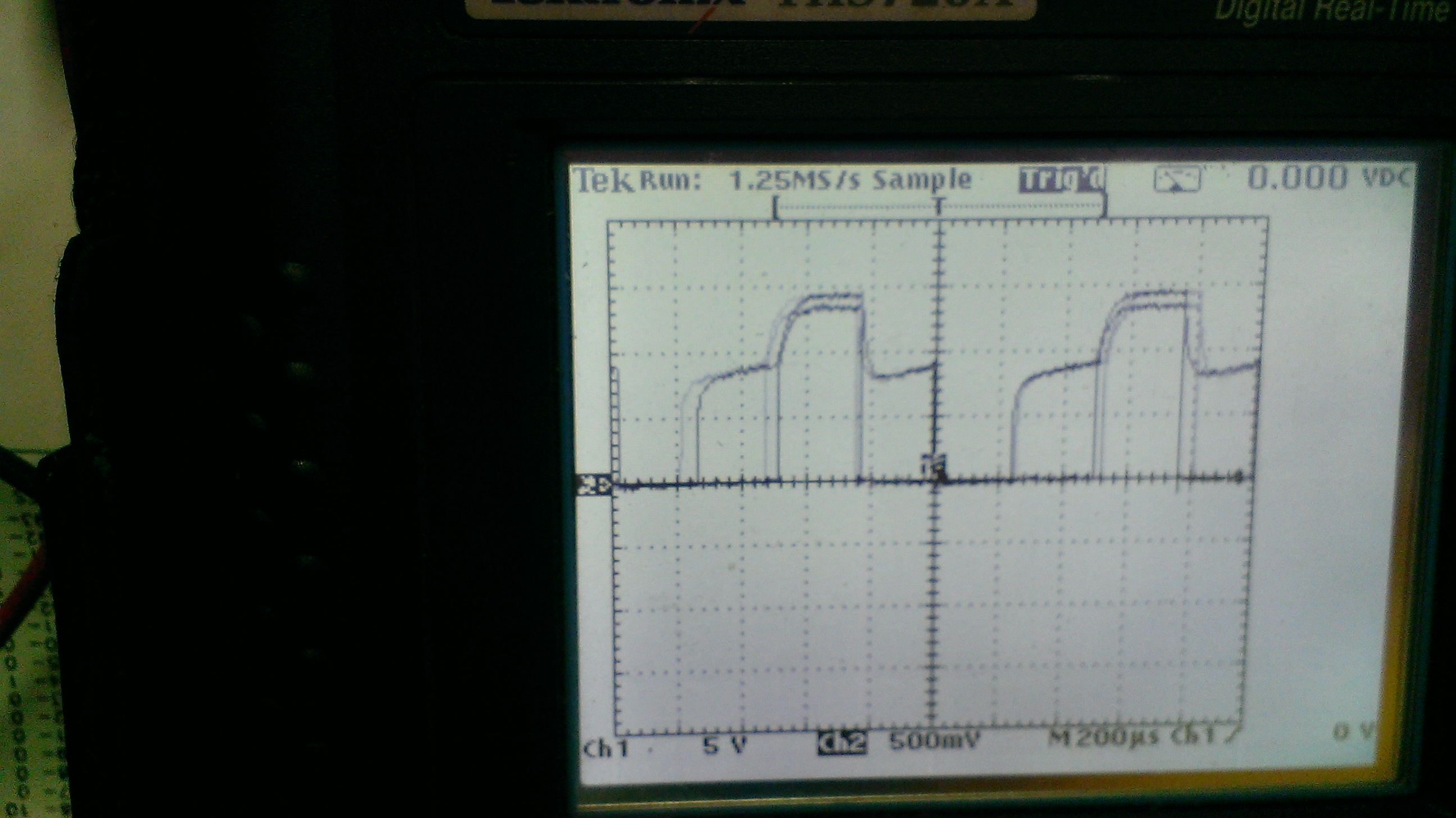

I recently acquired some of those cheap encoders off of Ebay (to help my 30 yr old son with music synth project), and the bounce was pretty awful (see attached waveforms). I implemented some hardware debounce using some programmable logic. So depending on your application, you may or may not care about bounce, but here is my hardware solution (I'm sure I will get some flak for the use of all the glue logic when it could be done with firmware).
Here is screen capture of the bounce.

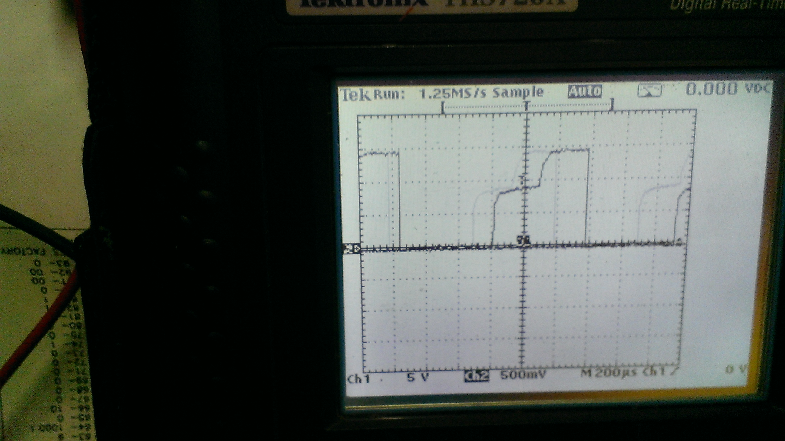

After some debounce added:
My logic Diagram:
Some my screen captures:
pic_34_10.png CW direction
pic_34_12.png CCW

Ouch, that's pretty awful. What encoder did you use, and how much did it cost?
The ones I got were el-cheapos from ebay, no part number or data sheet. 10 for $7.00, I would only use these for hobby use, never a production item as I am sure the operating life span will be short.
Ah, that explains a lot! 70 cents each :eek:
