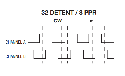

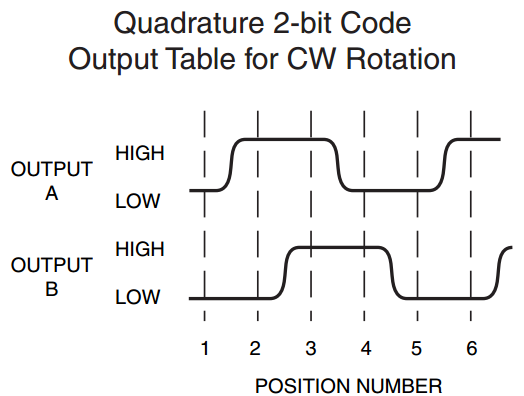

The diagrams look identical:
Mechanical:
Optical:

The diagrams I included in my post suggest that the polarities are the same--The "HIGH"s match up, as do the "LOW"s. The old design did indeed use pull-ups: a network of 3.3k resistors (it has 3 knobs, so two resistors for ch A & B on each encoder).

The truth tables for the 25L mechanical encoder indicate that the switches were pulling the signal lines up when closed, which means the signal lines had pull down resistors. You have pull up resistors, the opposite logic polarity.
25L A phase in DerStrom8 circuit = EM14 B phase.

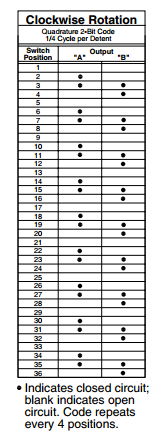

Where do you see that? I'm seeing this:
Dots indicate a closed circuit, which means it's connected to ground (the "COMMON" pin). Am I wrong?
The common pin could be connected to either ground or the logic 1 level. If common is connected to ground the there would be pull up resistors to the logic 1 level on the A and B outputs. If common is connected to logic 1 level then pull down resistors would be connected between ground and the A and B outputs. Either way is valid so the table does not imply weather common should be connected to either ground or logic 1 level.

To me the dots on the chart indicate high or 1.

The table for position 2 combined with the waveform drawing for position 2 in post #1 make it clear (OK, clear to me) that a dot = a closed switch = a logic 1 = Vhigh, implying pull-down resistors. The "32 DETENT" plot for the optical encoder confirms that both encoders define phase A the same way. Ergo...

I was looking at the current schematic for the project I'm working on when I said that Common is connected to ground. Thus a "closed switch" would connect A and B to ground as well, hence the pull-up resistors I'm seeing in the existing schematic.
