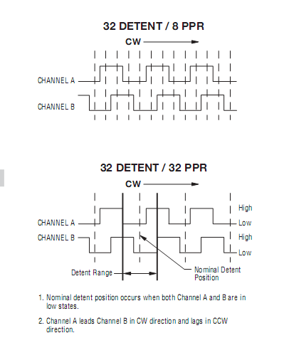

The Bourns opto sensor is a good solution.
Note that two options 32 detents with 8 PPR or 32 PPR.
The detents are in between Channel commutation position, but doesn't mean slow rotation might cause some extra false pulses on one channel only depending on spring effects, backlash and optical hysteresis.
The logic ( or code) for Direction and step pulse will ignore this, which is the advantage of quadrature methods.

The whole PPR/CPR has been a bit confusing though. I understand PPR ("pulses per revolution") really should not be used for quadrature encoders, yet I frequently see it anyway.
After fitting the encoders in to the new board and hooking it up to test, we're seeing some issues with inconsistent increments per detent, and if it's spun very quickly it actually seems to register as going backwards. We never had this problem with the old mechanical encoders. Any thoughts on what would cause this?

Quadrature encoders are used for any resolution of rotary or linear encoding with two orthogonal signals (90deg phase shift ) giving 4 binary (Quad) states.
Therefore PPR is very appropriate for rotary encoders. I think your confusion is the CPR. AVAGO has the same CPR as PPR whereas Bournes does not in the previous parts examined.
You may be using a higher PPR resolution such as 32x compared to the mechanical one before or spinning it faster and thus the reverse rotation ( wagon wheel effect) will occur when the sampling rate is slower than 1/2 of the quadrature pulse rate.
Sounds like the same stroboscopic effect that makes wagon wheels look like they're turning backwards in old westerns, otherwise know as frequency-domain aliasing. At 1 pulse per revolution, the output is rated for 5 Hz max. That's not much, and I'm not surprised that rapid spinning causes dropped pulses. If one output phase drops a pulse but the other one doesn't, that could look like a reversal. Also, if the external system input circuit debouncing/signal conditioning/whatever can't handle the higher speeds, the same thing will appear. If the apparent reversal is repeatable with a particular quick spin, a dual-trace capture could show the dropped pulse and confirm that the problem is in the encoder. If the system sees a reversal but the scope does not, then the problem is in the interface. Or something like that.

32 pulses / revolution,
5 pulses / second = 300 pulses / minute
(32 pulses)/(revolution) * (1 minute)/(300 pulses) = (32 minutes)/(300 revolutions) = 9.375 revolutions/minute
If that's the problem, no amount of messing with the software is going to help.
I would be surprised if you can hit the upper limit of frequency by hand-turning. I haven't read the data sheet (I'm on my phone, sorry) and my experience is mostly with motor-mounted encoder, not panel knobs, so I might be speaking out of turn here, but seems to me that you would have to go out of your way to intentionally design an encoder to be that slow.
I didn't see the CPR table at the end of the datasheet, so my math is off. The mechanical limit is 300 RPM, times 32 CPR is 9600 CPM, divided by 60 is 160 Hz, or 3.125 ms per output pulse width, either up or down. I think this makes it even more possible that an overly aggressive debouncer is dropping pulses. With an FPGA, the encoder waveforms could be going into some gates to turn them into clock plus direction signals (which should be fast enough to keep up with anything), or they could go to a firmware CPU core that is executing 8051 or ARM assembler to do the interface in software running on firmware emulating hardware. Gotta love FPGAs.
